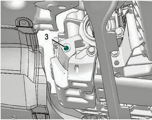

- x 6957
Re: Peugeot 407 Automatic gearbox oil change
Ok, so a bit late here, but you have a BVA4 HP20 (AG). This guide may help you.
Capacity is 8 litres in total (from new), but only approximately 3 litres are removed when draining.
Note there is a checking procedure detailed first, then the Draining & Refill Procedure below that will refer back to the Checking Procedure!
Tooling
You will also need access to Peugeot Planet 2000 Diagnostic Tool / Diagbox.
ESSENTIAL: Use only ESSO LT 71141 fluid.
Checking Procedure:
Prior conditions:
Wait for the temperature to reach 60 ± 1 degrees C.
1st possibility:
The oil flows: the level is correct.
The oil does not flow:
Clip the plastic portion of the breather (2).
Drain & Refill Procedure
Prior conditions: Draining to be carried out when hot to eliminate impurities suspended in the oil.
Draining is partial because the converter cannot be drained completely.
On draining, approximately 3 litre(s) are removed.
Refilling
Place the vehicle on a lift.
Release: The air filter assembly.
ESSENTIAL: Leave the air temperature sensor connected.
ESSENTIAL: Check the oil level (Refer to section above "Checking Procedure" ).
Tooling
Checking Procedure:
Prior conditions:
- Check absence of faults using the diagnostic equipment
- Place the vehicle on a lift (Vehicle level)
- Gear lever in position P (Without handbrake)
- Major power consuming equipment disconnected
- Connect the diagnostic equipment
- Select the parameter measures function
- Ensure, before starting this operation, that the oil temperature is below 55 degrees C, if it is not, allow the oil to cool
- Depress the brake pedal
- Start the engine (Idling speed), Take the gear lever though all the gear change positions, return to P
1st possibility:
- Refit the oil level plug (3). (Tightening torque to 2.5 da.Nm)
- Add 0.5 litre(s) of oil (Refer to chapter: Refilling)
- Resume the checking procedure for the oil level
| Drain plug (1). Tighten the cap (1) to 4.5 daNm. |
Refilling
| Remove: The breather assembly (2) (Using tool [3]). Raise the vehicle. |
| Remove the oil level plug (3). Using the tool [1], pour new oil through the breather hole, until it runs out of the oil level hole. Start the engine: Idling speed. Depress the brake pedal: Take the gear lever though all the gear change positions, return to P. Add oil until it runs out of the oil level hole. Close the oil level hole. Stop the engine. |
