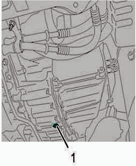

| Drain plug (1). Tighten the cap (1) to 4.5 daNm. |

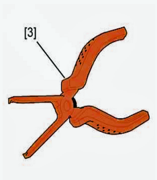

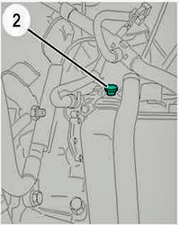

| Remove: The breather assembly (2) (Using tool [3]). Raise the vehicle. |
| Remove the oil level plug (3). Using the tool [1], pour new oil through the breather hole, until it runs out of the oil level hole. Start the engine: Idling speed. Depress the brake pedal: Take the gear lever though all the gear change positions, return to P. Add oil until it runs out of the oil level hole. Close the oil level hole. Stop the engine. |
