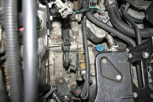

Hi,
The box is a 4HP20. It will need an oil change, whether say sealed for life or not. I will do it myself. The plan is to drain it by removing the drain plug, my dad has a hand operated suction thing to properly suck oils and even water from mechanic machines. I've read on the technical document there is about 8 litres of oil in the auto box, and only 3 litres will come out, hence the need to suck the remaining 5 litres out.
But before medling down there with the critical oil, what kind of oil is it? And where do I refill it?
I took the airbox off yesterday and saw the autobox oil dipstick, and not far from it a blue turny thing that may be the filling plug, it turns but doesn't come off, i didn't want to pull it incase i broke anything critial.
http://www.flickr.com/photos/deiz92/496117689/

As far as I can find out the fluid is only available from dealers, its part number is 9736 22 @ about £15 per litre :shock:
You'll only be able to get just over 2 litres out each change due to most of it remaining within the torque converter. Drain it by simply removing the sump plug then refill via the dip stick hole using a funnel/tube.
When refilling make sure the level is correct when hot as over/underfilling will damage the box. As a guide, refill to the bottom mark on the dipstick when cold. Level checking is done engine running with the gear lever positioned in park.

The blue turny thing is the breather. It will pop off with gentle persuasion. Under this is a steel funnel which is a interference fit in the gearbox housing and also pulls off with a little more persuasion. Both parts are available as spares. On later boxes there is no dipstick so you have to use the breather hole to refill.
When I changed mine I managed to coax 4 litres out of it. I think I may well do another change soon as I'm taking the old girl back to the motherland in June to do a bit of house hunting, so there will be a couple of thousand miles of péage to deal with.

Mine has the dipstick, so I reckon I will fill it down the dipstick hole as dickie suggested, but if filling down the breather is easier i will do this.
