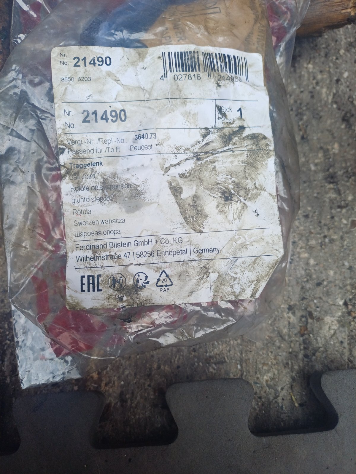

For reference part number for 308cc front lower balljoint

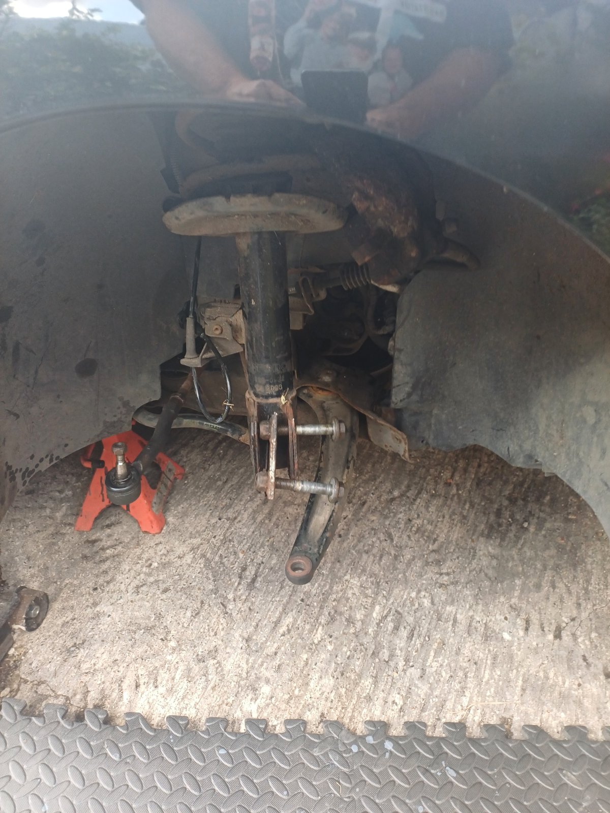

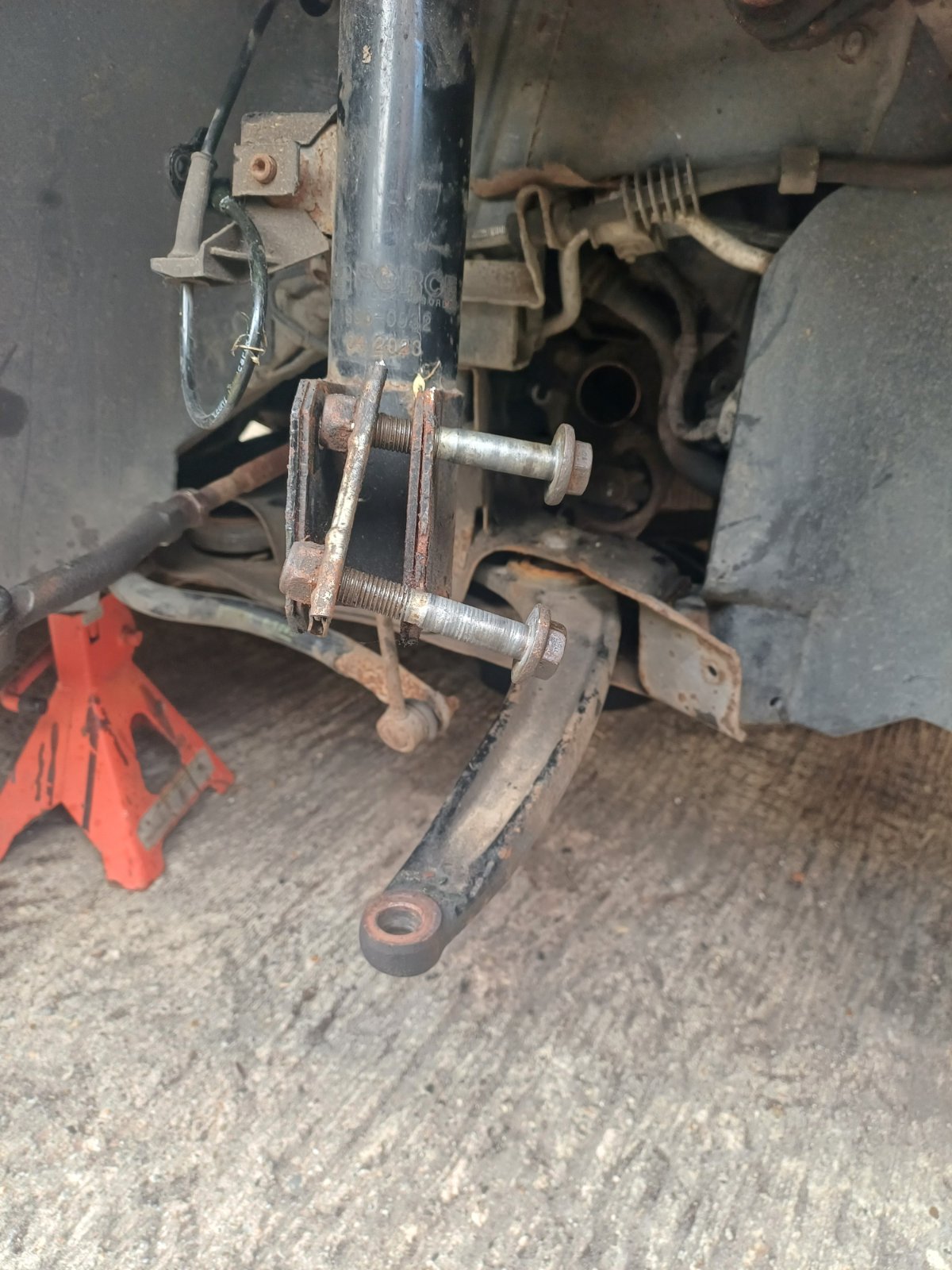

So new ball joint is in 90nm toqure setting hub , and all brake parts are in the car boot as im now waiting a new drive shaft I can confirm the on the car even scared ai , I showed the ai on my device via camera all movement and it came back with for your safety do not drive your car from what im seeing and how much floppy free play you are showing me it is very dangerous this has caused your inner tyre to wear plus the lower ball joint too... well, I got told off ......

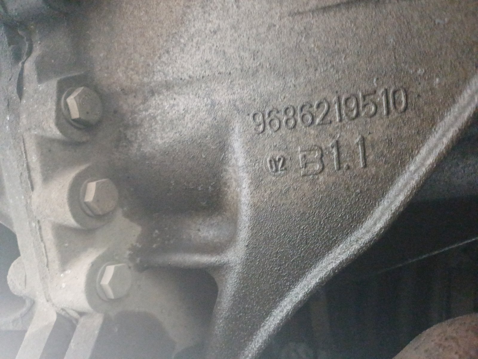

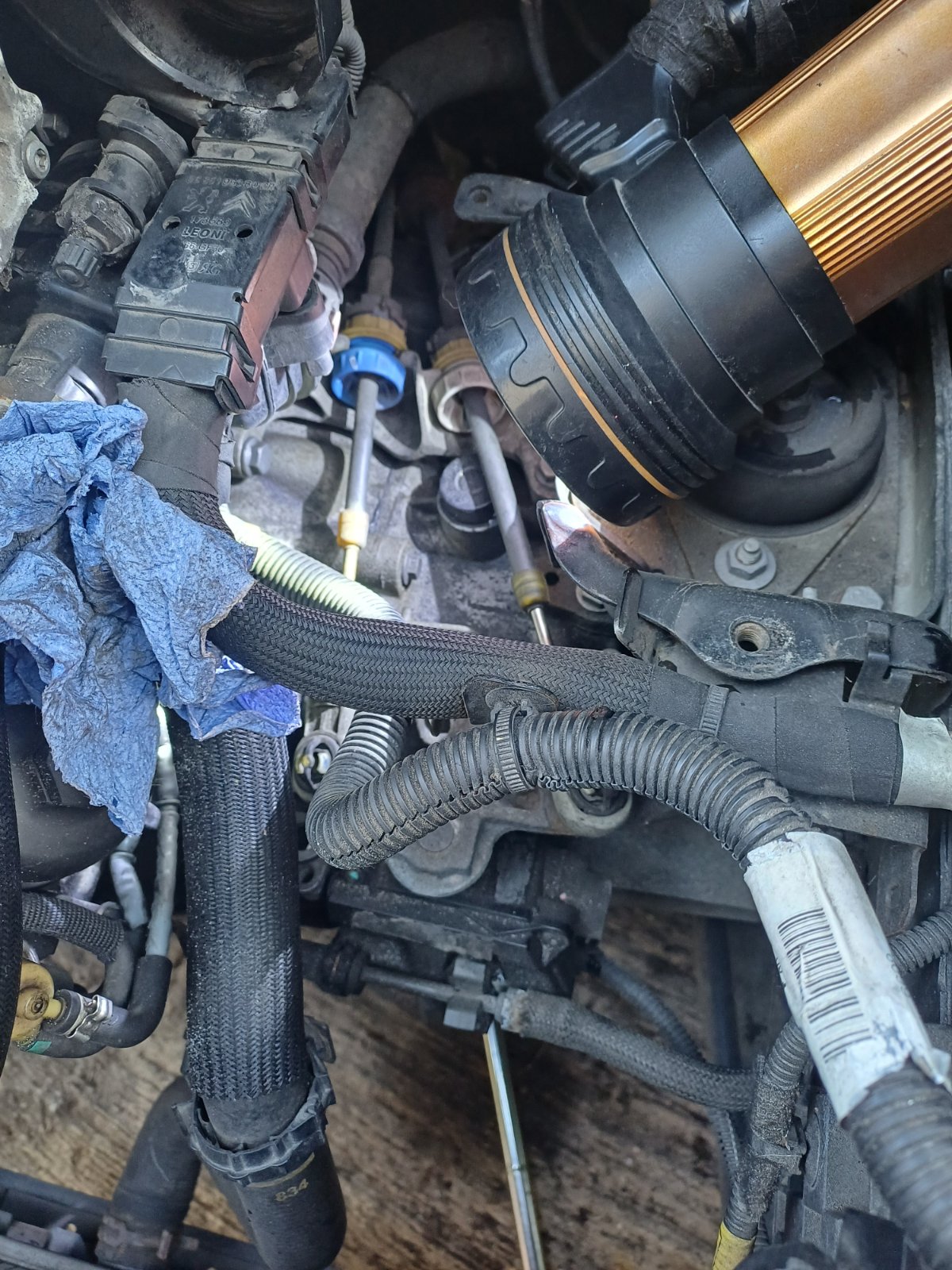

Some photos of the shaft out of the way and some gearbox numbers as one seller claims the driver shaft is coded to the gear box ? What for ...

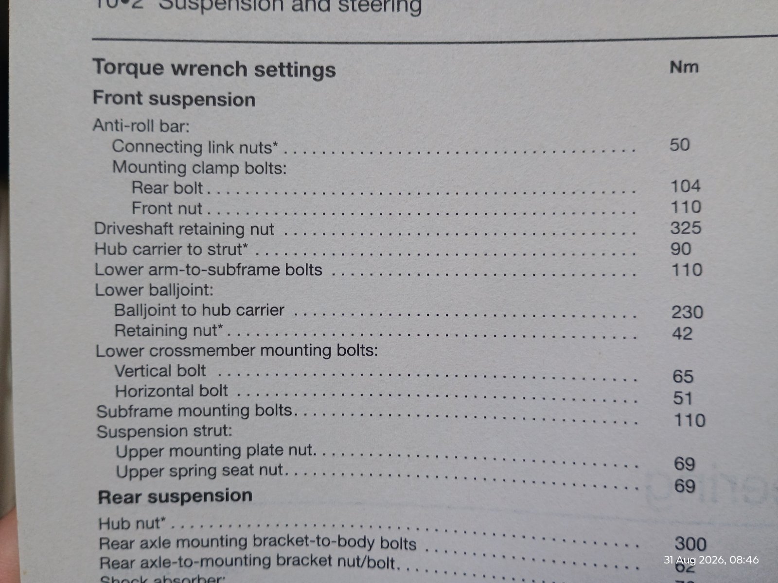

Huskyxantia wrote: 30 Aug 2026, 14:43 So new ball joint is in 90nm toqure setting hub
Just checking: this isn't the torque setting you've installed that big 41mm ball joint into the hub at is it?
Haynes 308 figures for you:

I thought it was more than 90 .. its not back on the car yet so when it is I can pound it up , ive another problem. Where the hell is the gearbox number on the gearbox
Nice 325nm
Nice 325nm

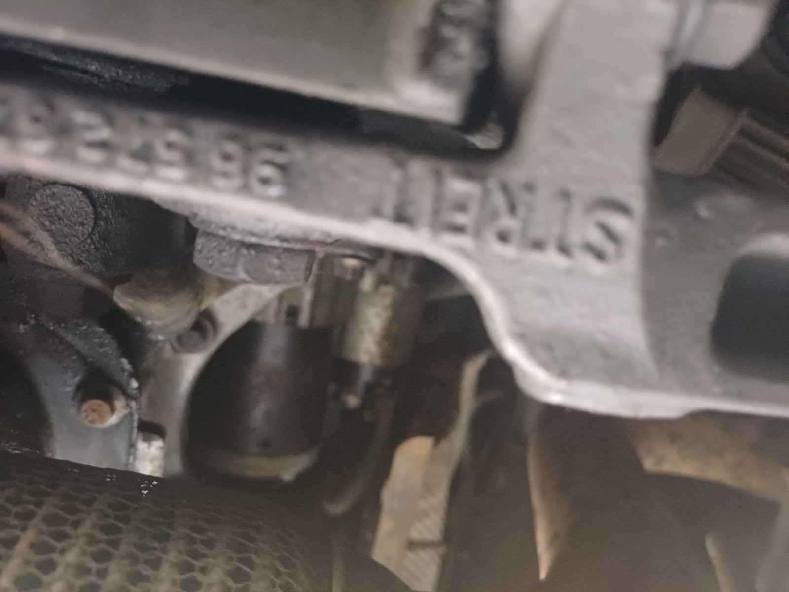

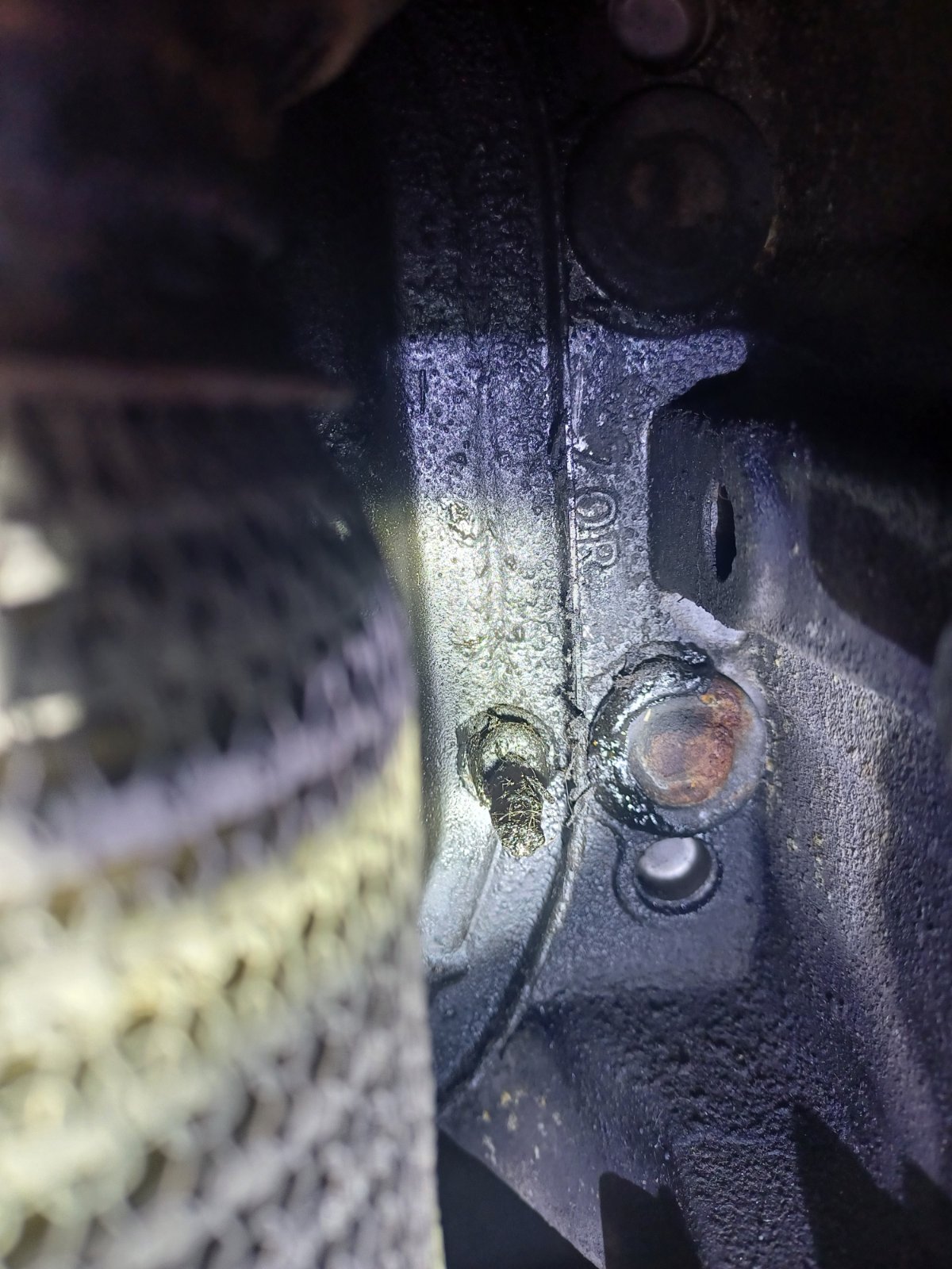

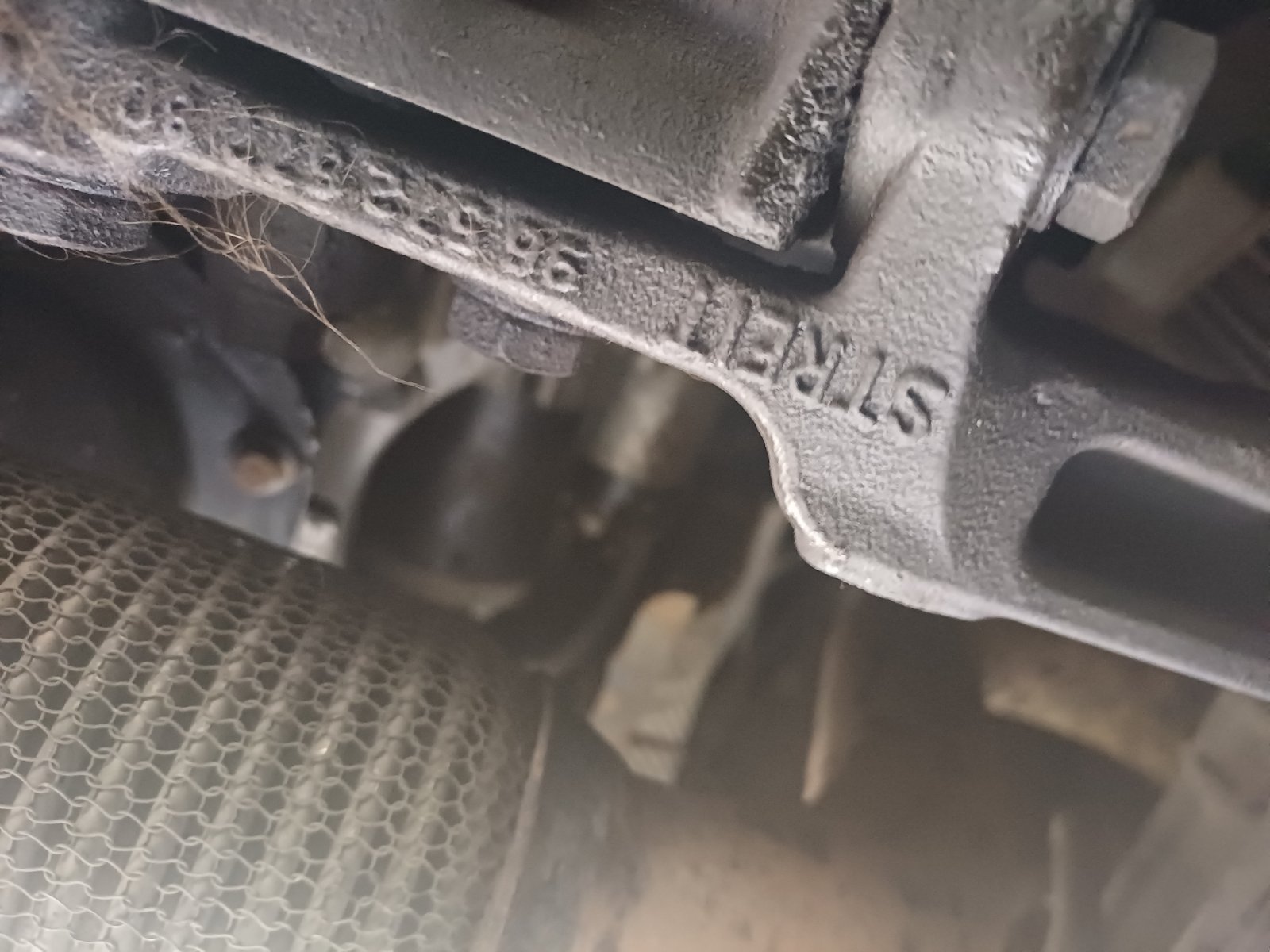

Turning into a puzzle this one found 2 drive shafts but the seller is asking vin , reg , gearbox code .... digging around the gearbox now wheres the number ...
:-D
Huskyxantia
Posts: 3925
Joined: 30 Jul 2018, 22:11
x 921
Re: 206cc to a 308cc How ? Why ? Everything 308cc
Unread post by Huskyxantia »

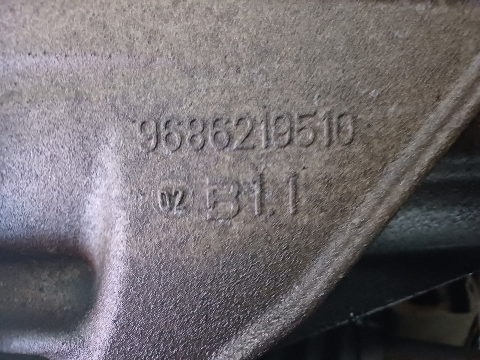

Found these numbers and that's it no others
:-D

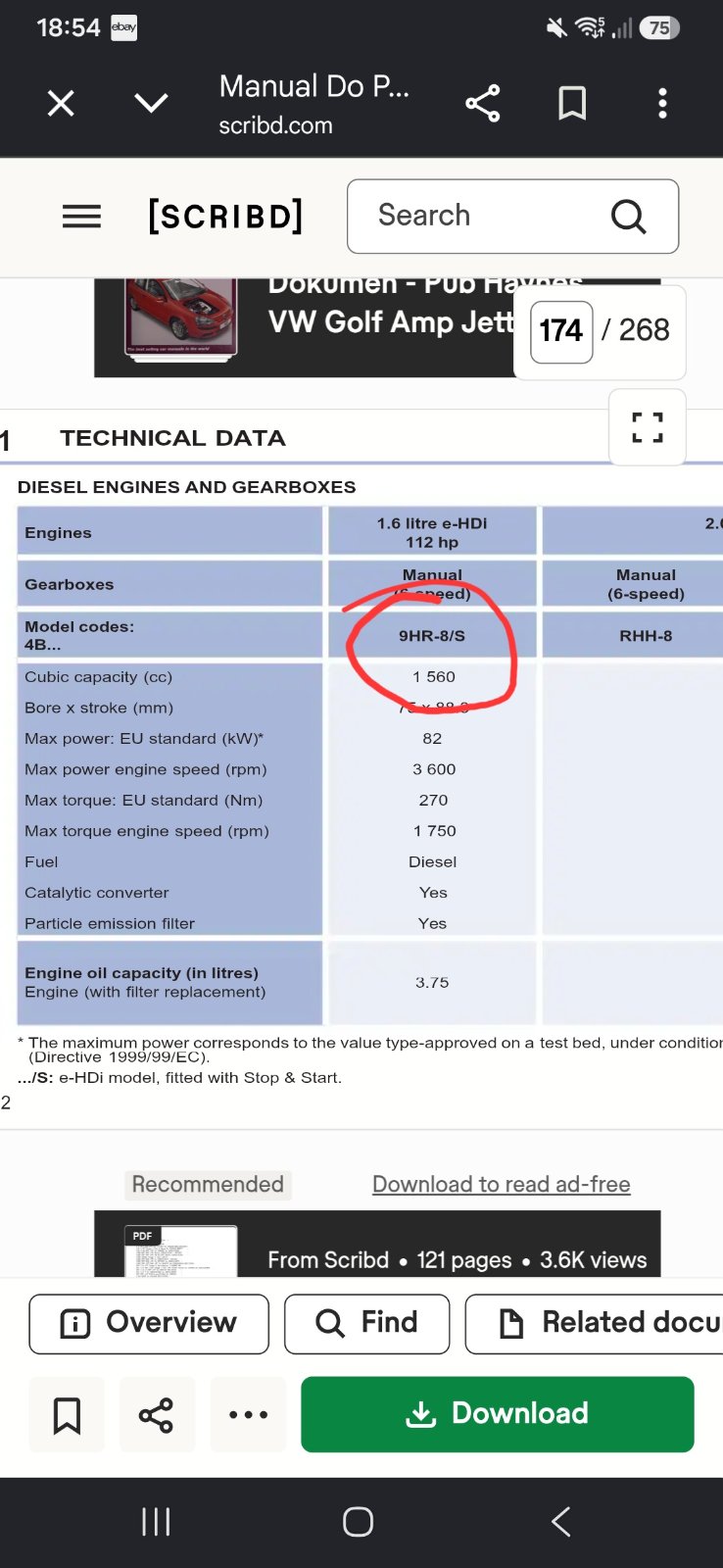

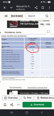

I think this is the gearbox code .
:-D
Posts: 5344
Joined: 25 Apr 2022, 09:03
x 2358
Unread post by MattBLancs »
I'm not certain, but think "9HR" and "RGH" are engine codes - if I'm correct they should be part of your car's VIN number. Characters 6,7,8 should match:
https://en.wikibooks.org/wiki/Vehicle_I ... /VIN_Codes
