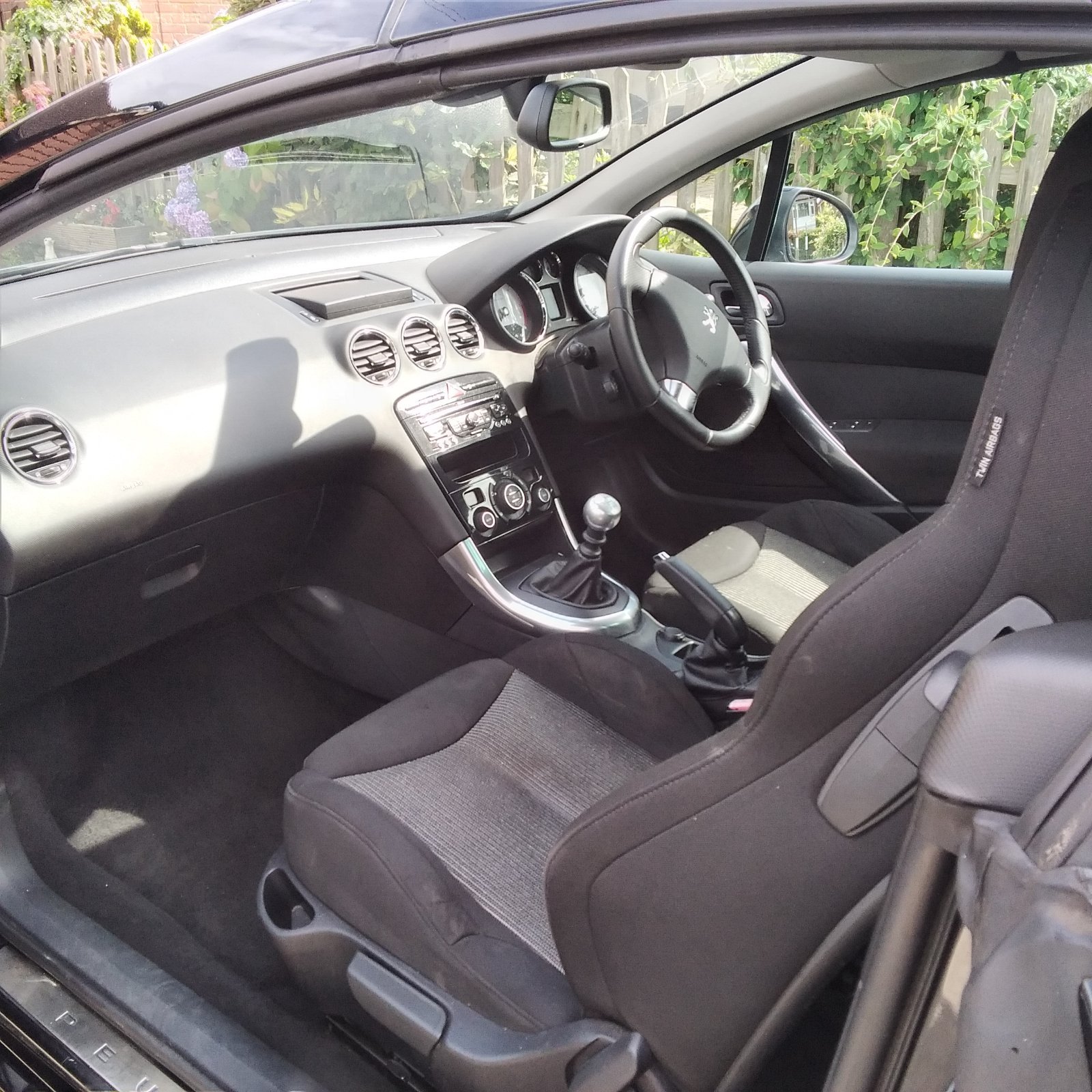

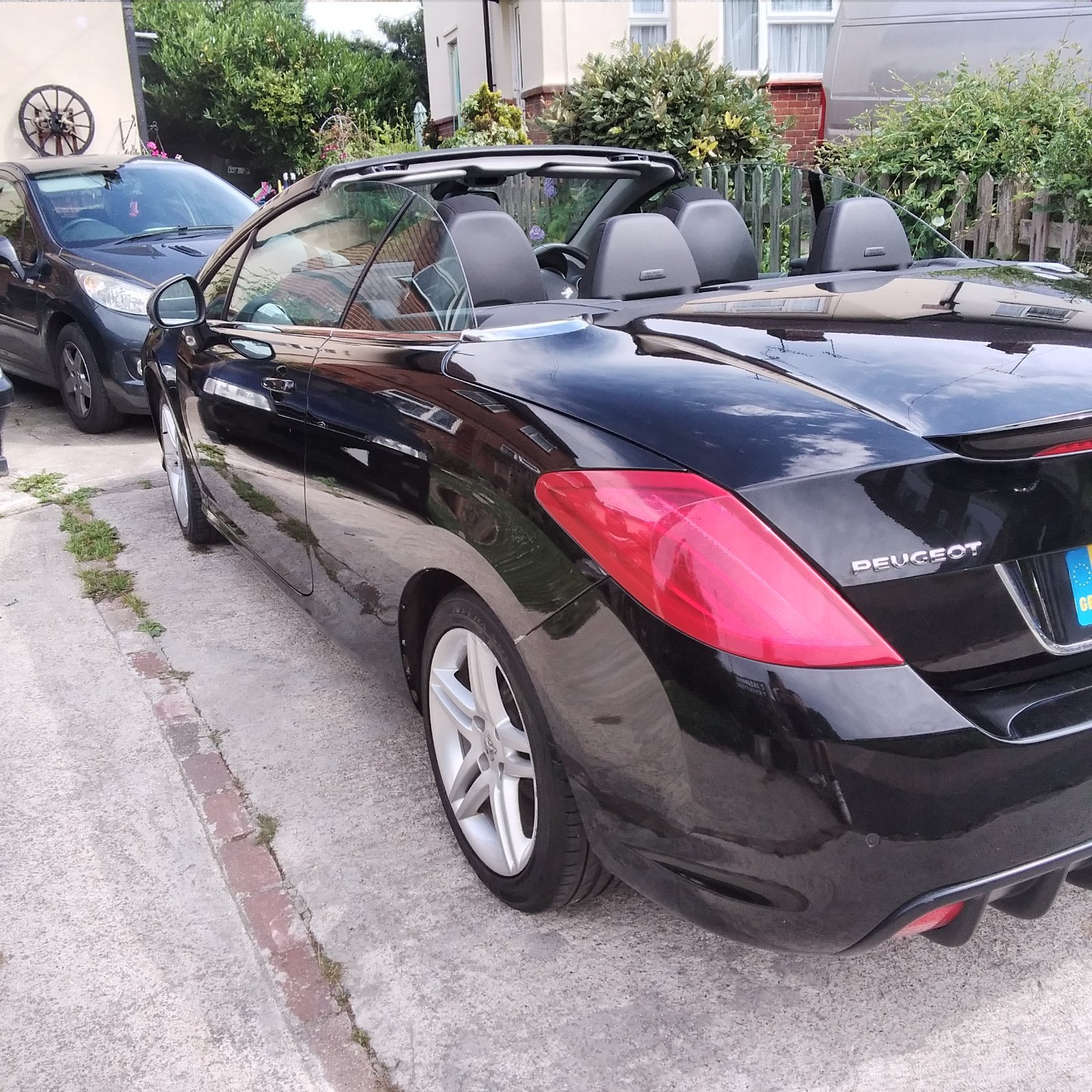

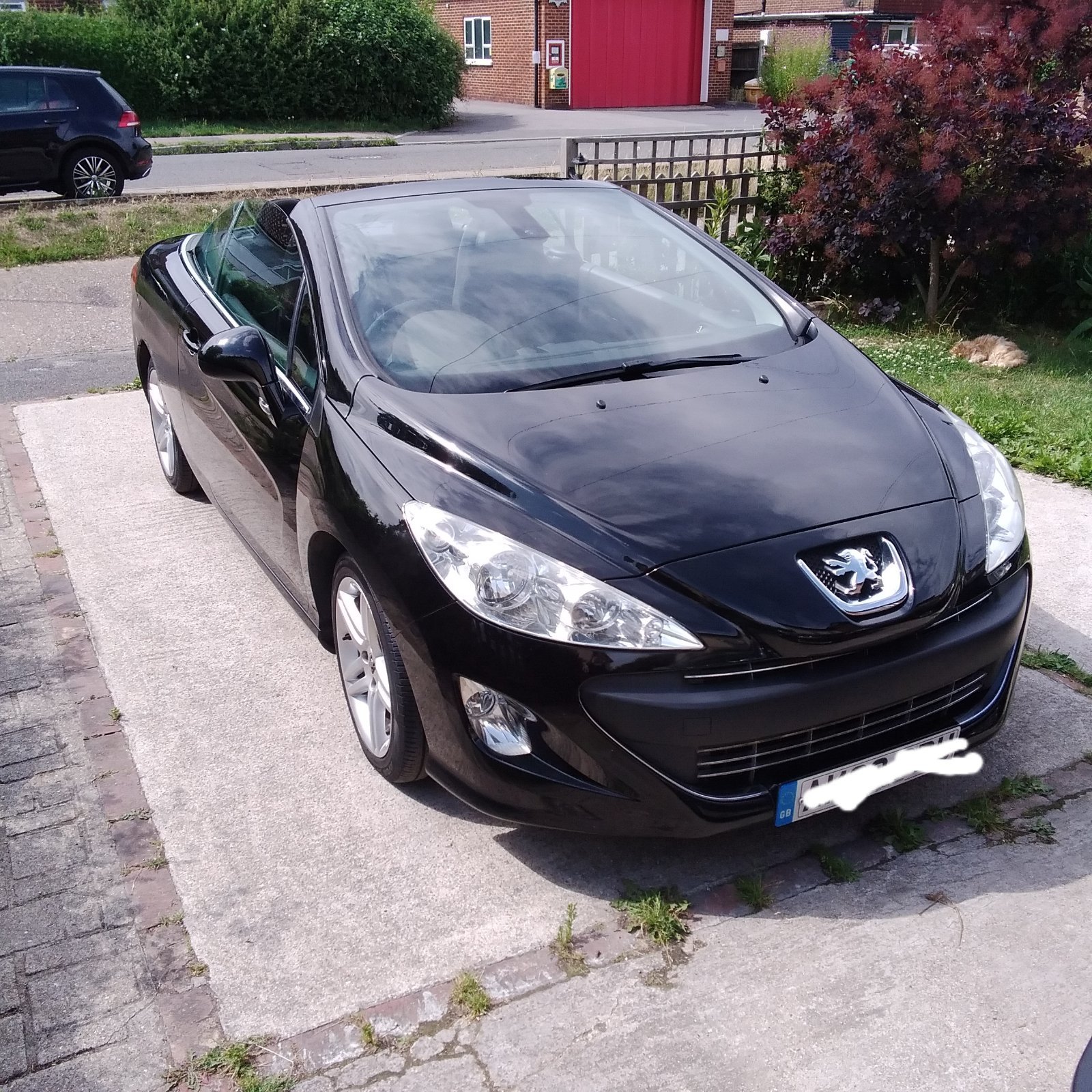

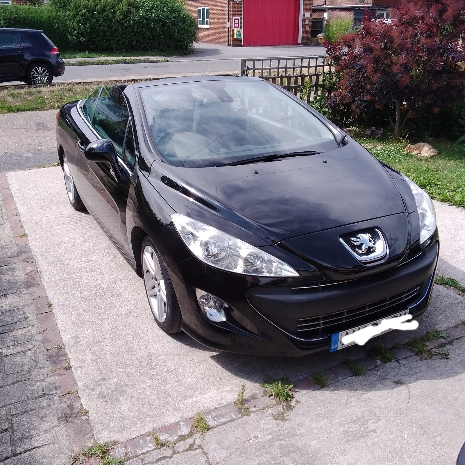

Some promised pics

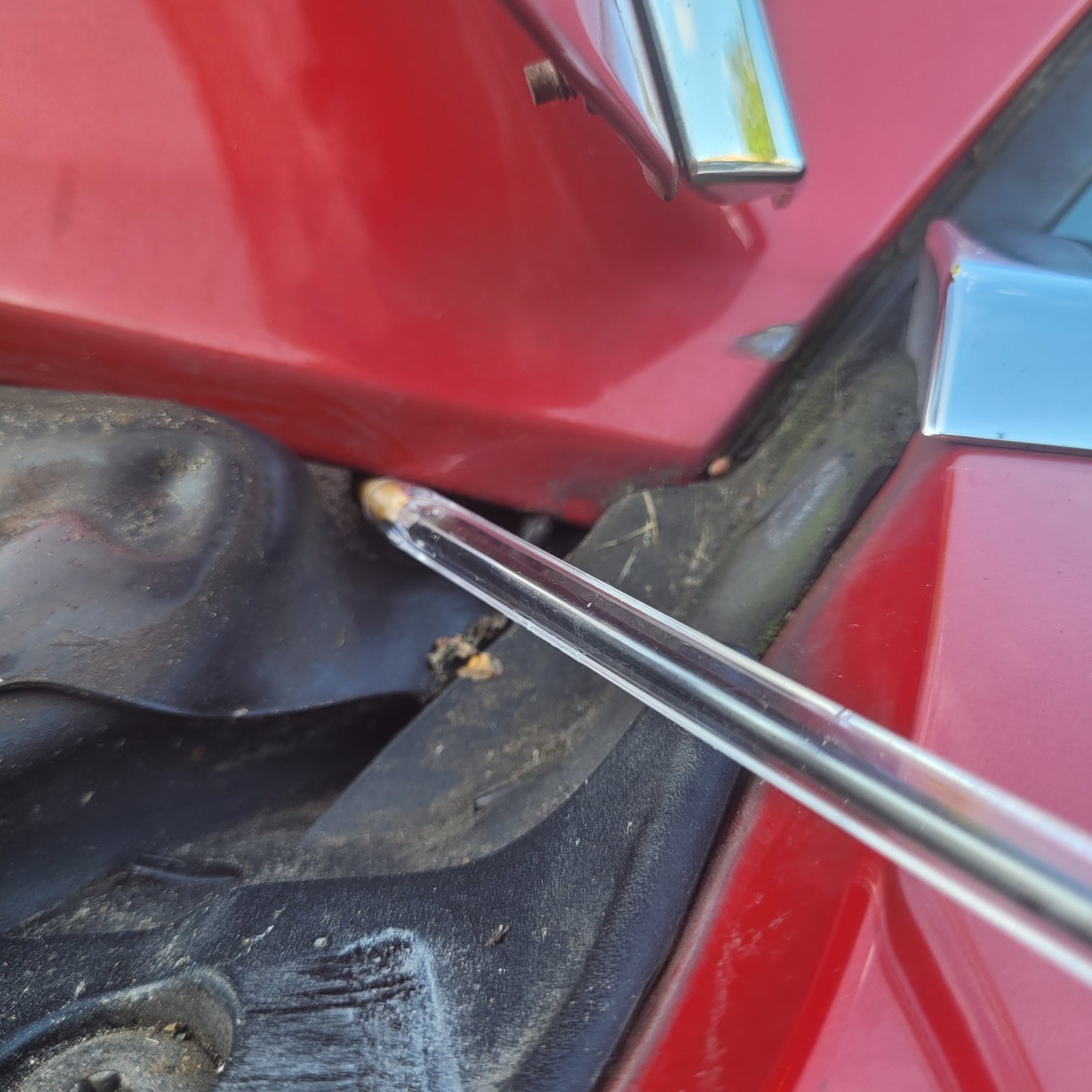

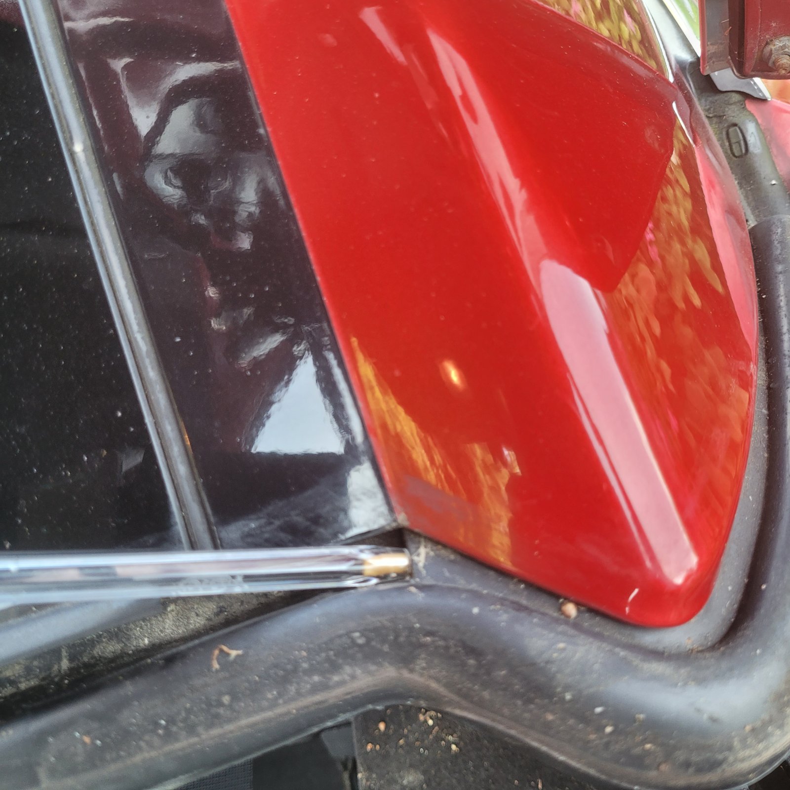

THE ONE THING YOU MUST KEEP AN EYE ON... all 308CC & 307CC owners should it is a real water leak weak spot.
Open boot, follow seat at he bottom of the rear window to the corner of the boot seal and rear window (1 on each side), you will see a tunnel in the rubber (not that obvious so look carefully at 1st) were the water from the rear window runs down and flows towards this tunnel flows through it and comes out further down the seal and the rain water runs down the rear wing, DO NOT mistake the channel on top of this tunnel for the water flow channel it is there just to help a little, the real problem is that tunnel. It blocks up with leaves and debris, which causes a blockage, the water then backs up and the aforementioned channel can not cope with it so it runs/pours into the boot at either side up where the boot hinges are, the 308CC is better designed than the 307CC the tunnel is bigger, you need to carefully push a long cable tie into it and rod it using the tie, the cable tie will push the rubbish out, I then carefully pour a warm kettle of water through it and you will be surprised what flows out and down the rear wing DO NOT use anything hard that can hole the rubber, a cable tie is perfect I make sure I can get the the square end through on the 308CC before I finish, you will see it showing at the bottom of the rear window pillar wing side, if you don't do this the boot can quickly fill with water as the boot seal can't keep it out on that corner. I know this from the 307CC. Do this even more if you leave it under trees or large bushed, leaves are lethal.

These are the "tunnels" in the boot seal, one on each side. I usually start with the pointed end of the cable tie, one it is through I swap it and use the square end then flush it with warm water. what you also get if one or both are blocked, after it has rained and you open the boot lid the water on the boot runs toward the rear screen, falls onto the screen drops into the boot lip and runs toward the tunnel but then backs up at this "tunnel" and overflows the boot seal and pours into the boot by the hinge, during the summer I do it around once a month as the wife parks in next to some bushes where she works so it gets lots of small laves stuck in there, which is why I do it quite regular, winter is not bad at all.
I also use a VW product on the seals, it is not cheap especially these days, and retails around £63.54, you can get it cheaper on eBay but also a LOT more expensive as well comes in a 30ml bottle and is called Krytox part number is G 052 172 A1. It is a small bottle but I have used it on ALL our convertibles, it lubes and plumps up rubber seals, it can reseal and EOS so it must be good, one bottle has been used for both our cars and is on its 3rd year now. you open the roof or doors or boot which seal you are working on, give it a clean get the algae off it etc I use mild soapy water and a soft nail brush, once it is clean dry it, then run along the seal with a very thin bead of krytox, rub it in gently working it along and into the seal, you then leave it, for around 3 hours open, the seals will plump and feel greasy, close it up, no more leaks, not more roof squeaks over rough roads, you may need to applications to start with dependant on how dry your seals are then I use it twice a year very thin coat on each car roof and boot seal one end of winter, one end of summer ready for the winter, the 307 &308 have never leaked, my Megane 3CC did when I got it from the screen seal, looks like someone had put a thin smear of black silicone it, once cleaned off it took 3 applications of Krytox to stop the leak, that was 5 years back not a drip in since all we get now is that dry rubbing roof sound at the end of the summer, sorted with the end of season lube with krytox, the secret is do not close it up for min 2.5 hrs to allow it to plump up fully.
