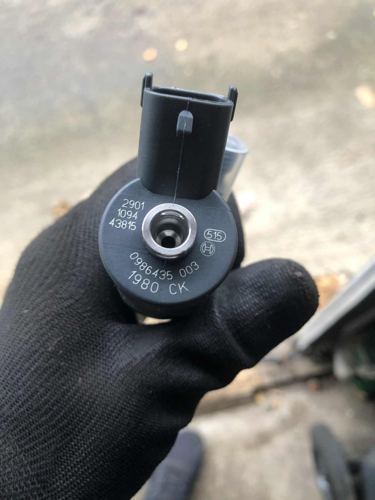

Skull's - new injector
New injector fitted to No.1 £180 :shock:
Same symptoms - no improvement to the engine running or smoking :cry:
At a bit of a loss now

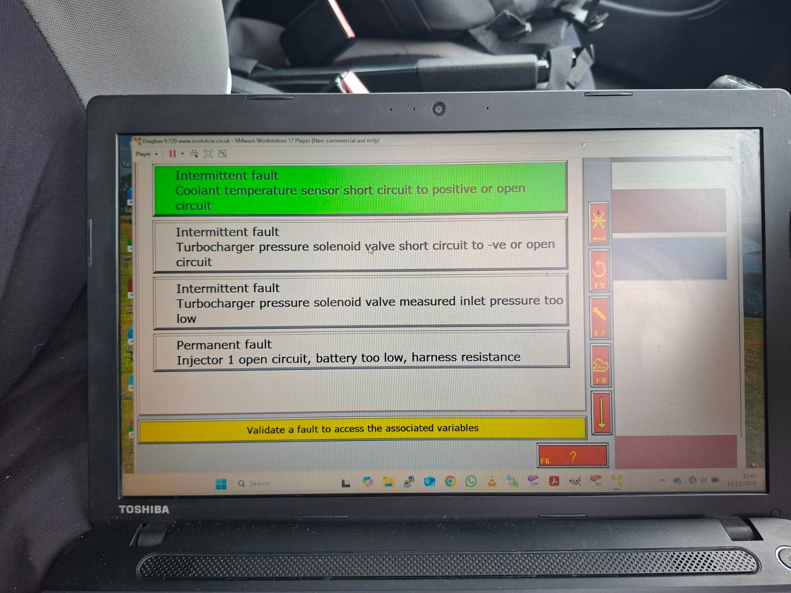

Mick and Jim arrived today after what must have been an early start for them and we promptly set about a full diagnosis session trying to discover the fault with my HDi.
Jim soon had his laptop out as Mick headed off on an errand for his Subaru …
Jim soon discovered that Lexia had found some engine errors:
Jim's - Lexia
Jim's - Lexia
^ If I remember rightly this one is showing initial faults found.
Also there was no record of the Fuel Pressure Sensor being responsible for cutting out the engine when suffering the hard stalls.
(My theory squashed)

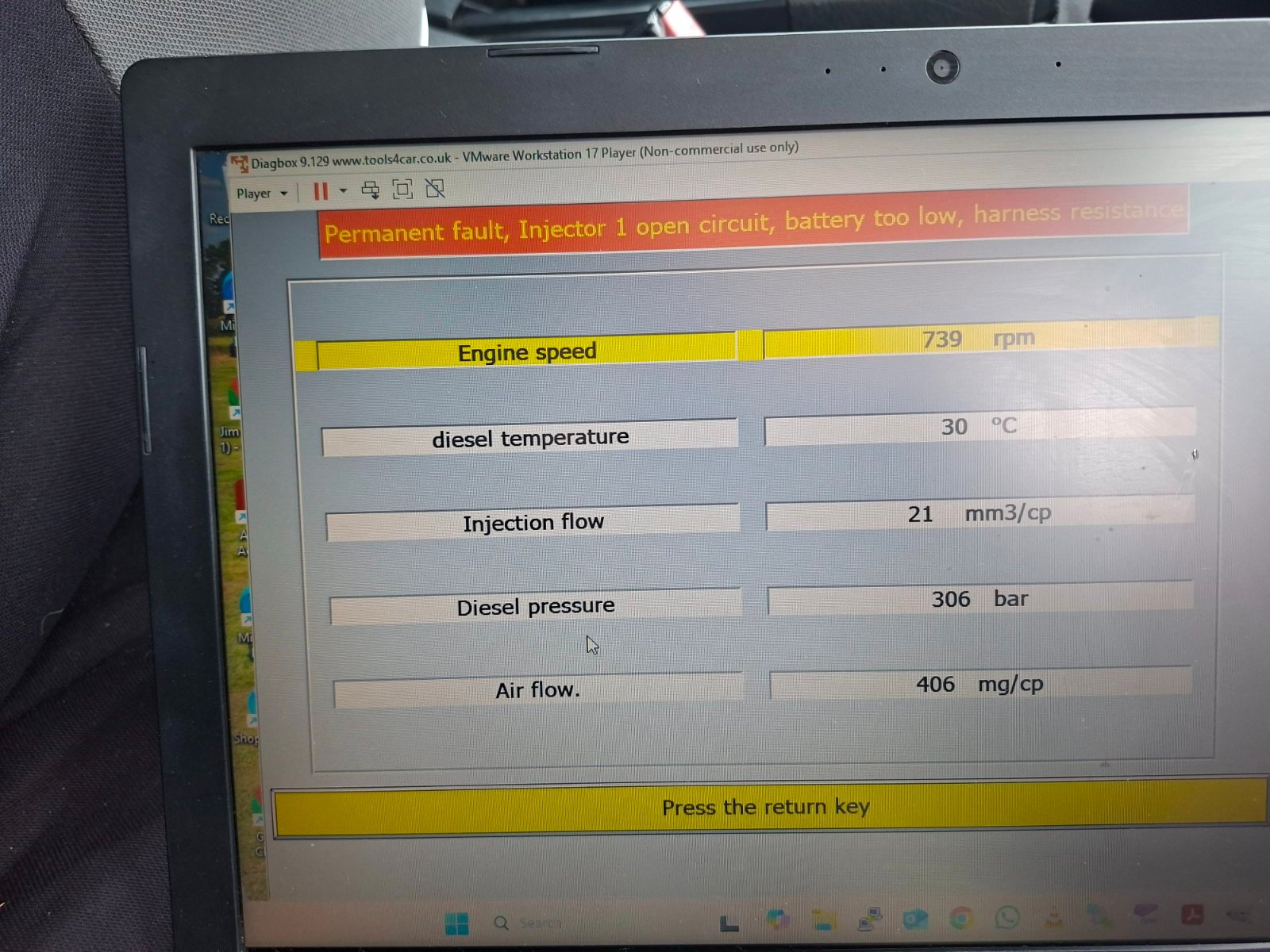

Jim's - Live data
Jim's - Live data
^ This shows the live data
We smoked the neighbours out more than a few times :lol:
We tried swapping a few injectors around again, we threw some theories about :idea1: :juggle: , meanwhile Mick returned with some expensive Subaru gearbox oil and we threw some more theories around over a brew :idea1: :juggle:

Re: XANTIA HDi RUNNING ROUGH
Was really great to see you yesterday Gary and I do hope, between us, we've managed to narrow it down a bit =D>
It surely is an odd one and defying of any real logic or concrete proof of what's going on exactly...
A diesel leak-down test would now be very beneficial. I've found a test kit can be obtained from the usual sources for surprisingly little money.
Typically:
https://www.amazon.co.uk/YUAN-Diesel-Co ... B07FLTBH6C
Do check it has an adaptor for a an RHZ 2.0 HDi engine though...
Also, with an oscilloscope, to check No.4 injector is being properly operated by the ECU.
Keep us all posted ;)
