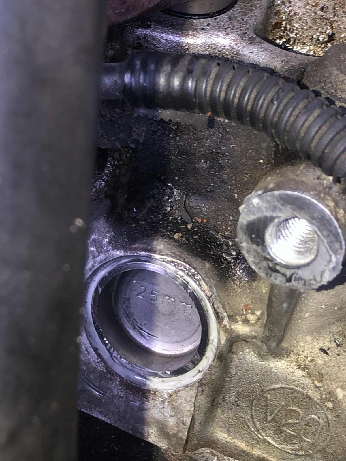

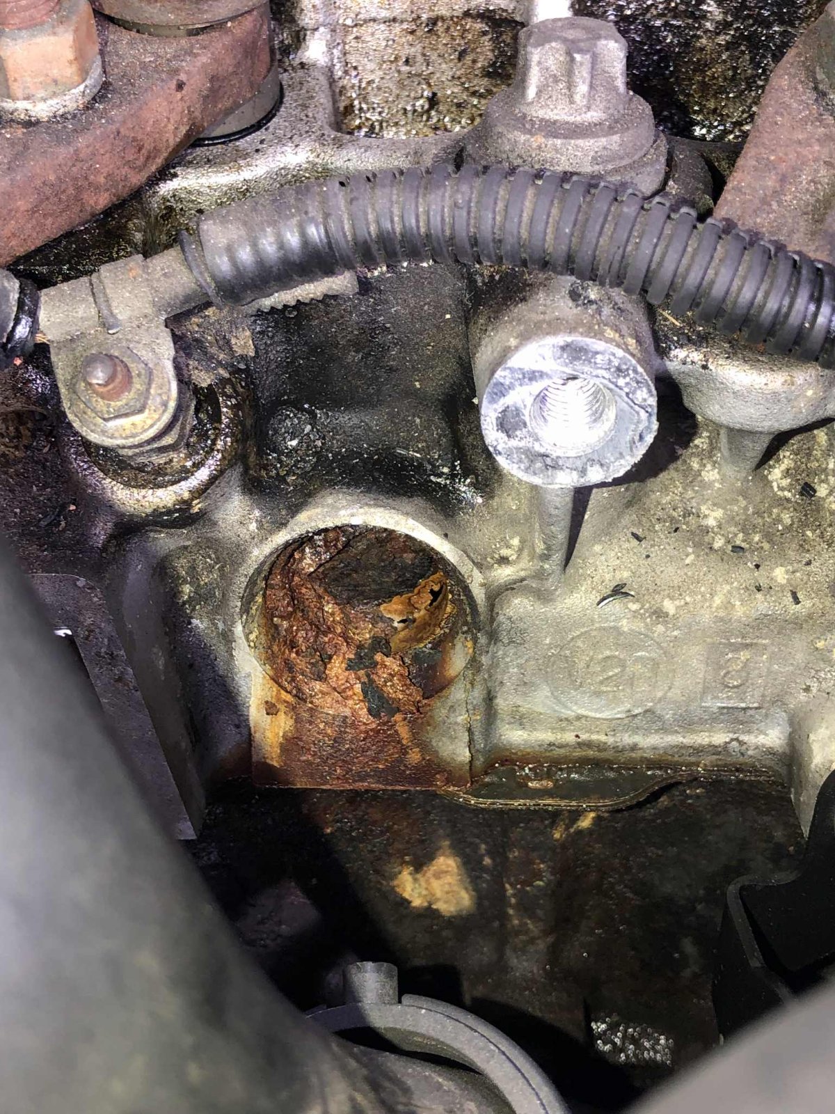

Skull's - rusty one
Skull's - rusty one

When I knocked the old Core Plug out that was roughly the coolant level so again I doubt any overheating has occured. So after changing the Core Plug in the cylinder head, I bled the fuel rail, topped up the coolant (2 litres), the engine started up OK and idled nicely but as it warmed up I noticed when reving engine it sounded a little more gruff than normal and didn't want to rev beyond 3K.

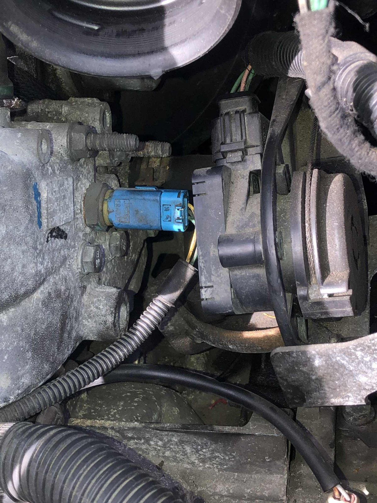

Coolant Temperature and level warning light was flashing STOP and O warning - I thought the cooling fans would have been operating at this stage ( :?: ) and went down a rabbit hole thinking the fans weren't working, I checked under bonnet fuse box F5 (5 amp) was OK so I ended up proving the cooling fan motor which on the HDi involves disconnecting this blue plug on the thermostat housing which I believe doubles up as a temperature sender for the 'bitron' (if Air Con is fitted) via the Air Con system in the ECU.
Skull's - Thermostat Housing
So when I unplugged the blue sensor plug, initially just the passenger side cooling fan started running high speed, my Haynes manual covers the 2.0 HDi as well as other previous models and is quite dis-jointed.
Pin 1 5v
Pin 2 Neg
Pin 3 Neg
I shorted Pin 1 and 2 - no effect
I shorted Pin 1 and 3 - both cooling fans ran low speed
I reconnected the blue plug and the engine started running a lot poorer after about 5 seconds both fans slowed and stopped at the same rate.
So the fan motors do work, coming on around 95 degree C on the vehicle gauge (I'm still in the rabbit hole though).

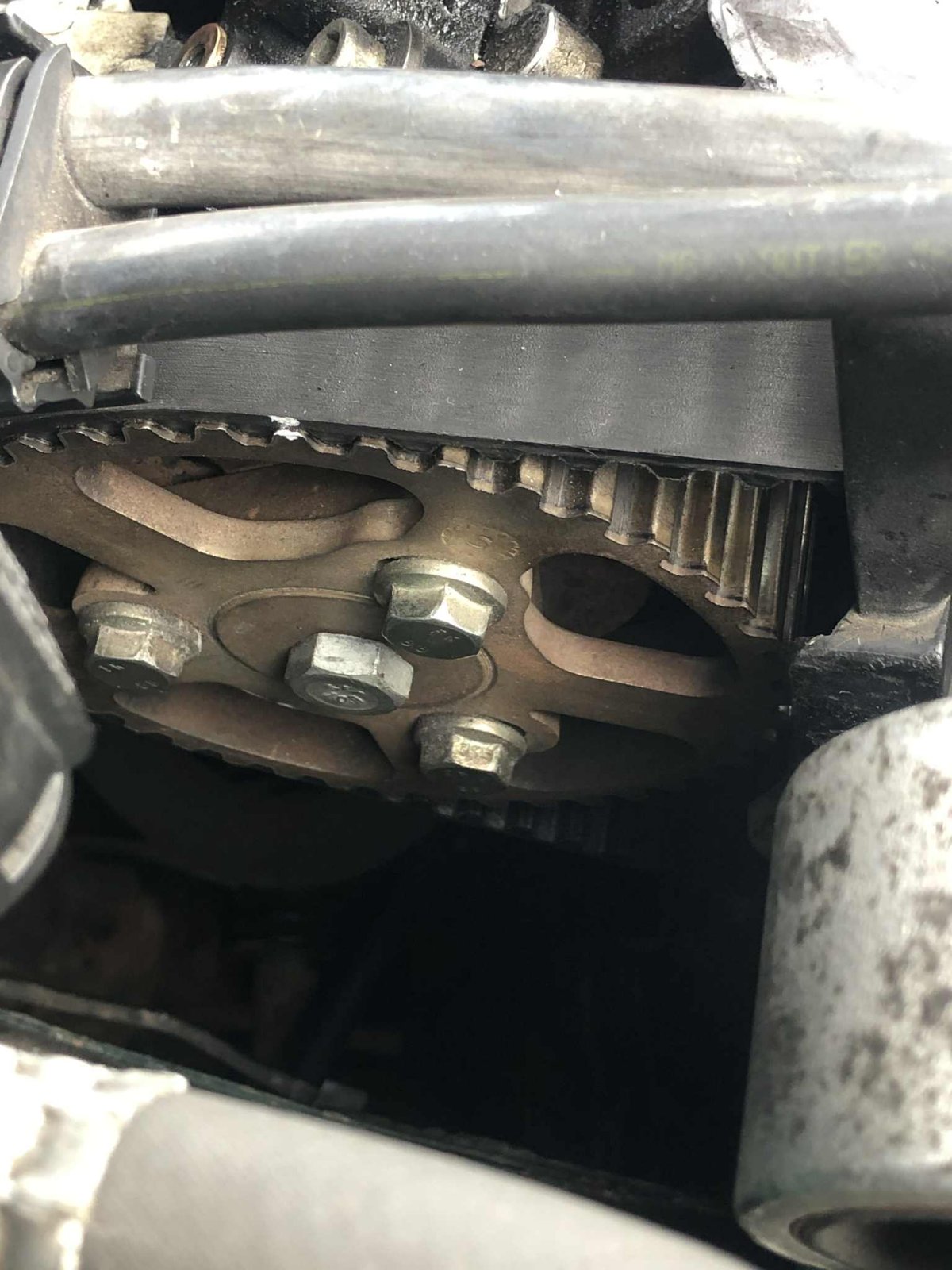

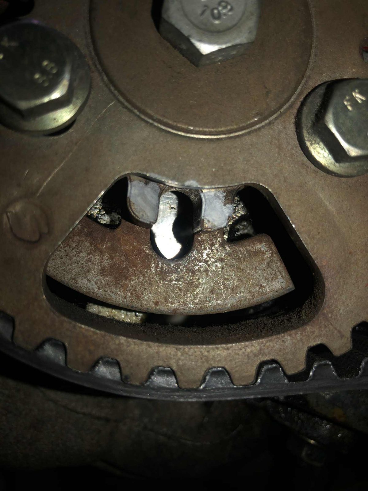

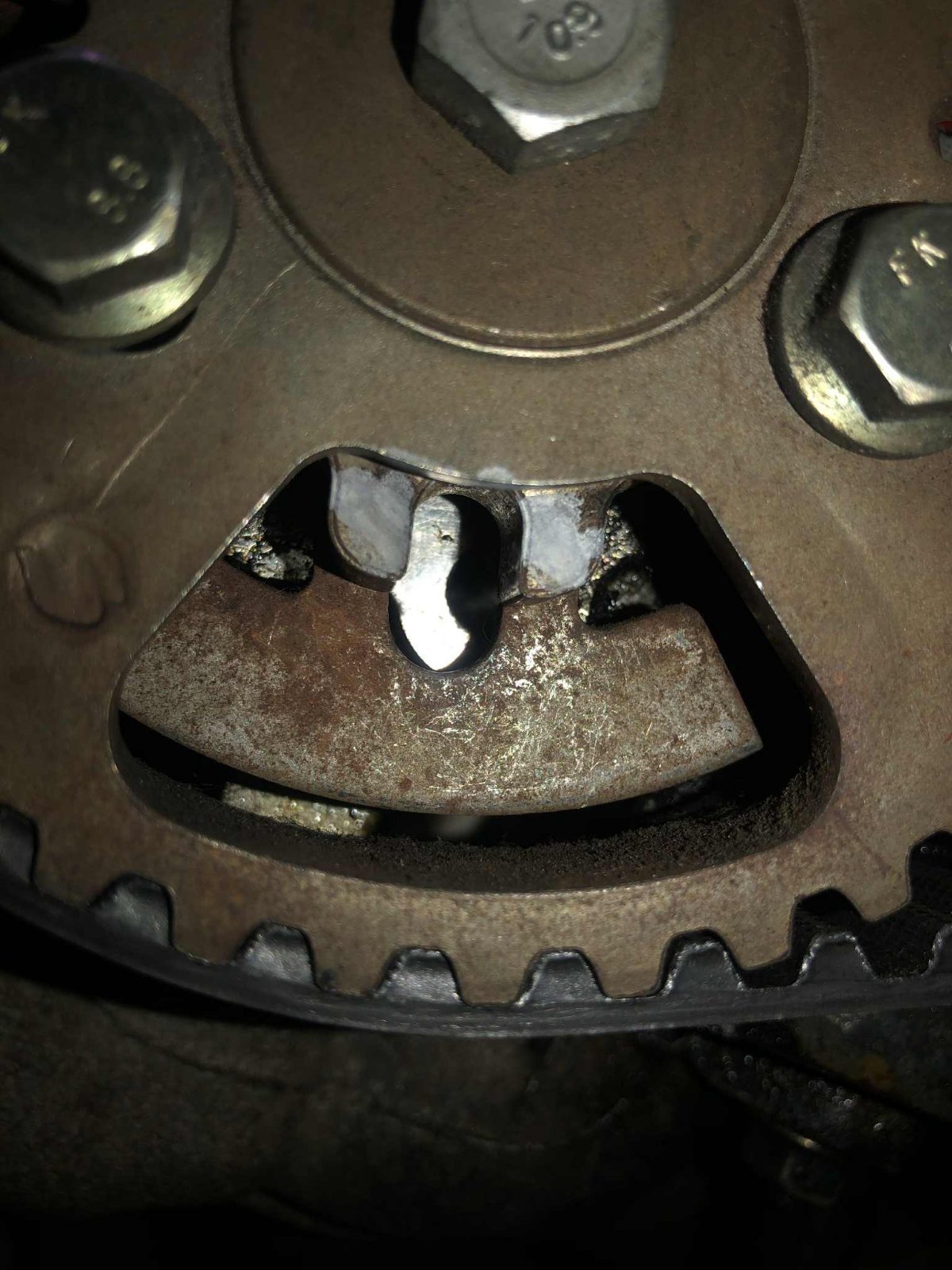

Skull's - Timing check
Camshaft 8mm pin hole slightly obscured by shadow in the photo.
With the flywheel locked correctly via the 8mm hole in the engine block flange (obscured behind the Starter Motor) there is a small amount of error in the cam timing but I don't think that would account for the rough running.
The Camshaft Sprocket does allow a small amount of fine tuning so I will probably try to get that aligned properly ......

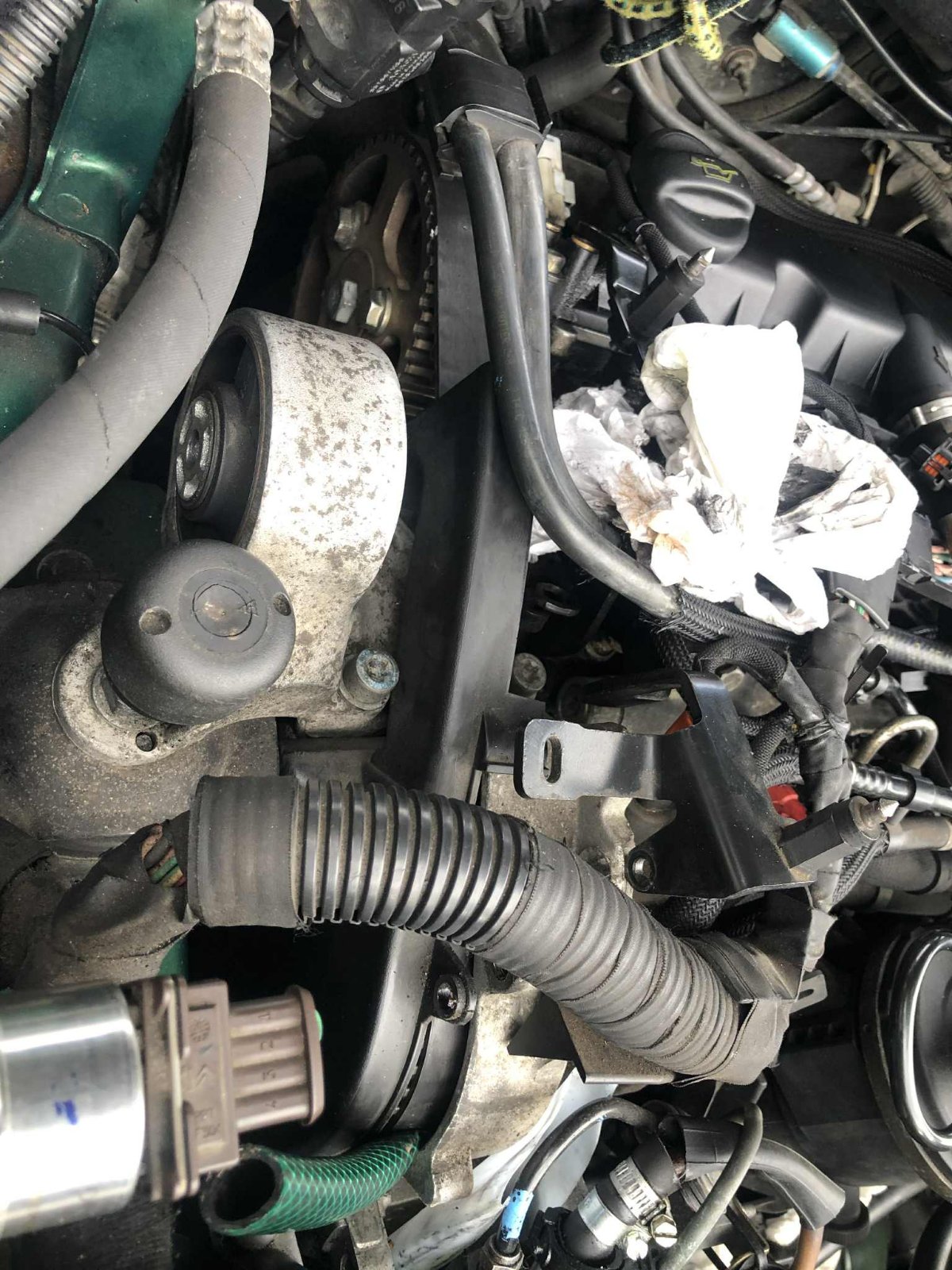

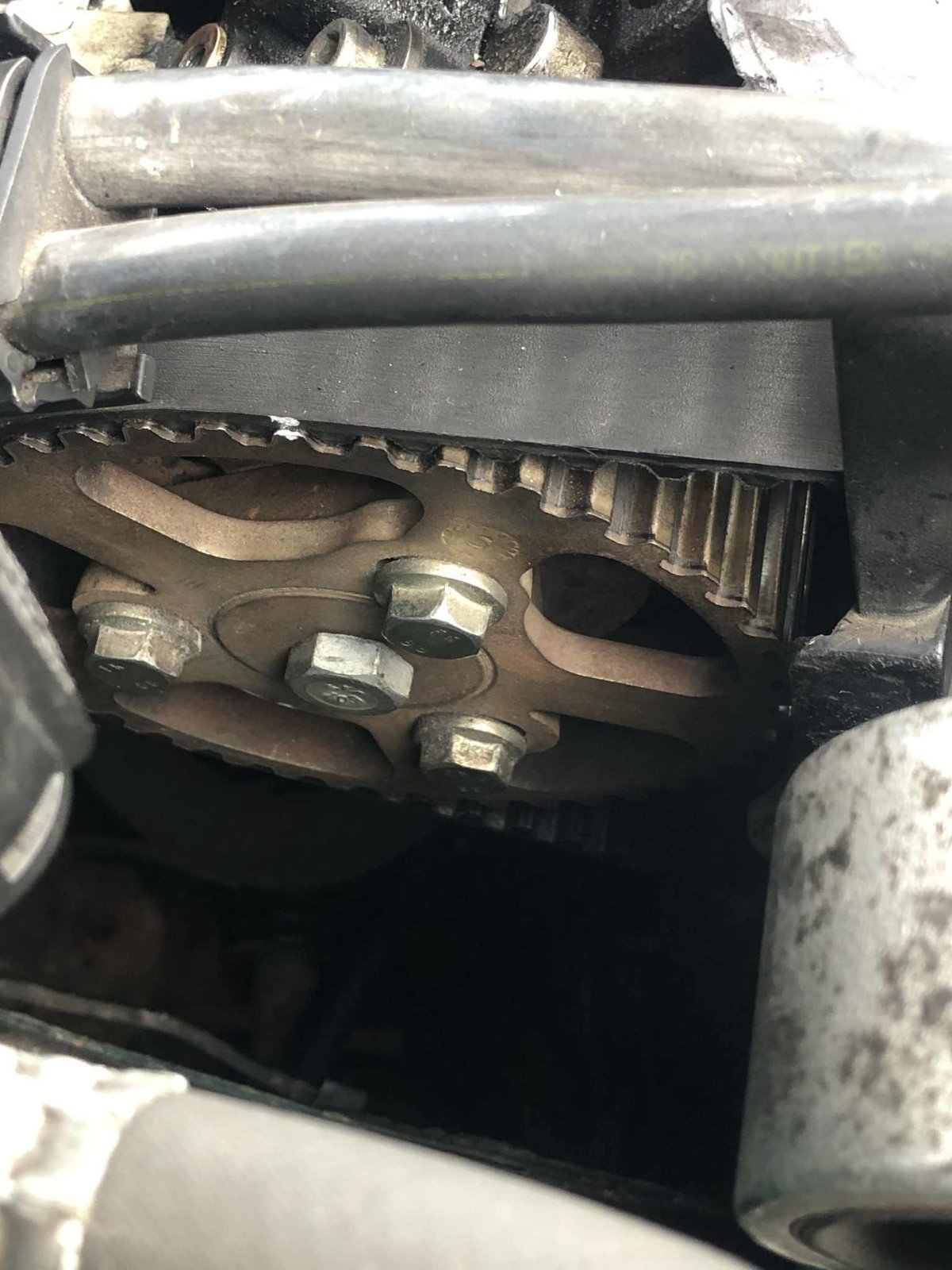

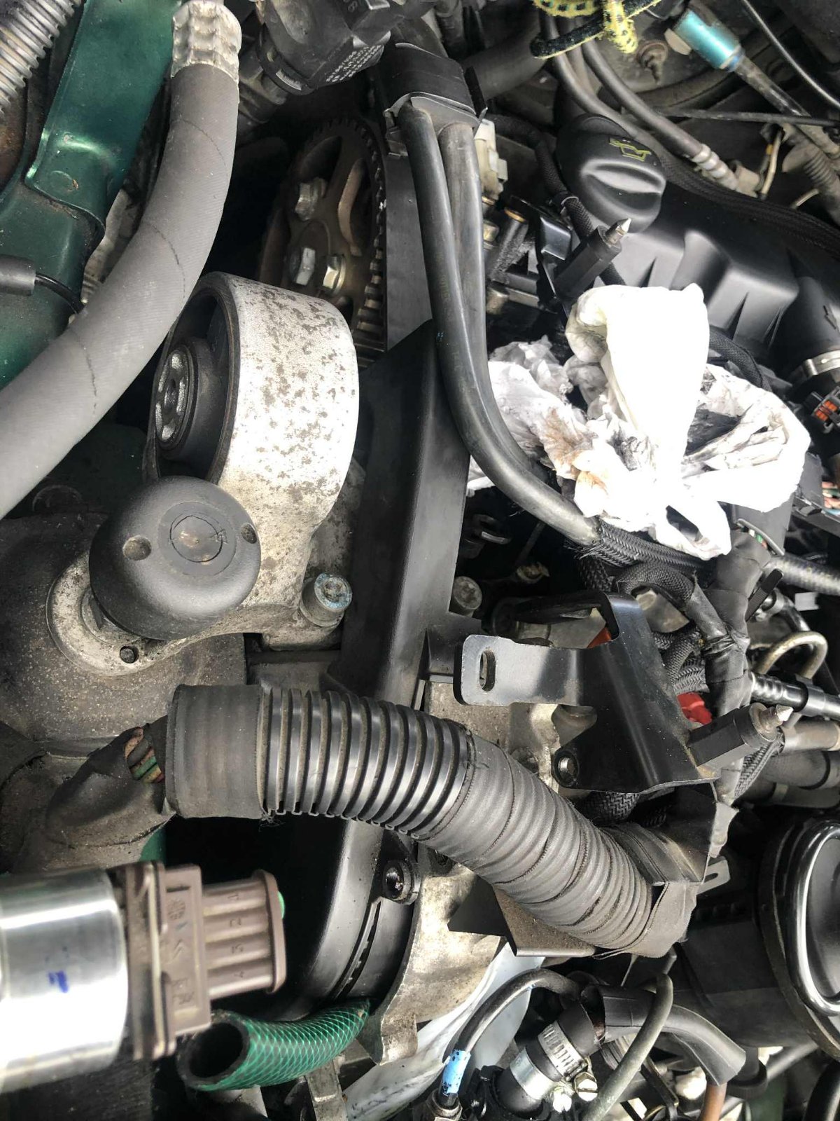

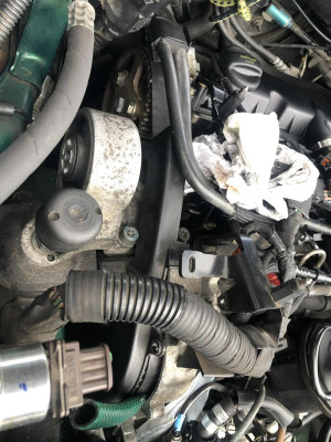

Checking the engine timing, I only removed the upper timing belt cover and loosened the intermidiate cover as the belt was going to be re-used - I marked the belt and camshaft sproket in their current position.
Skull's - belt and cam marked

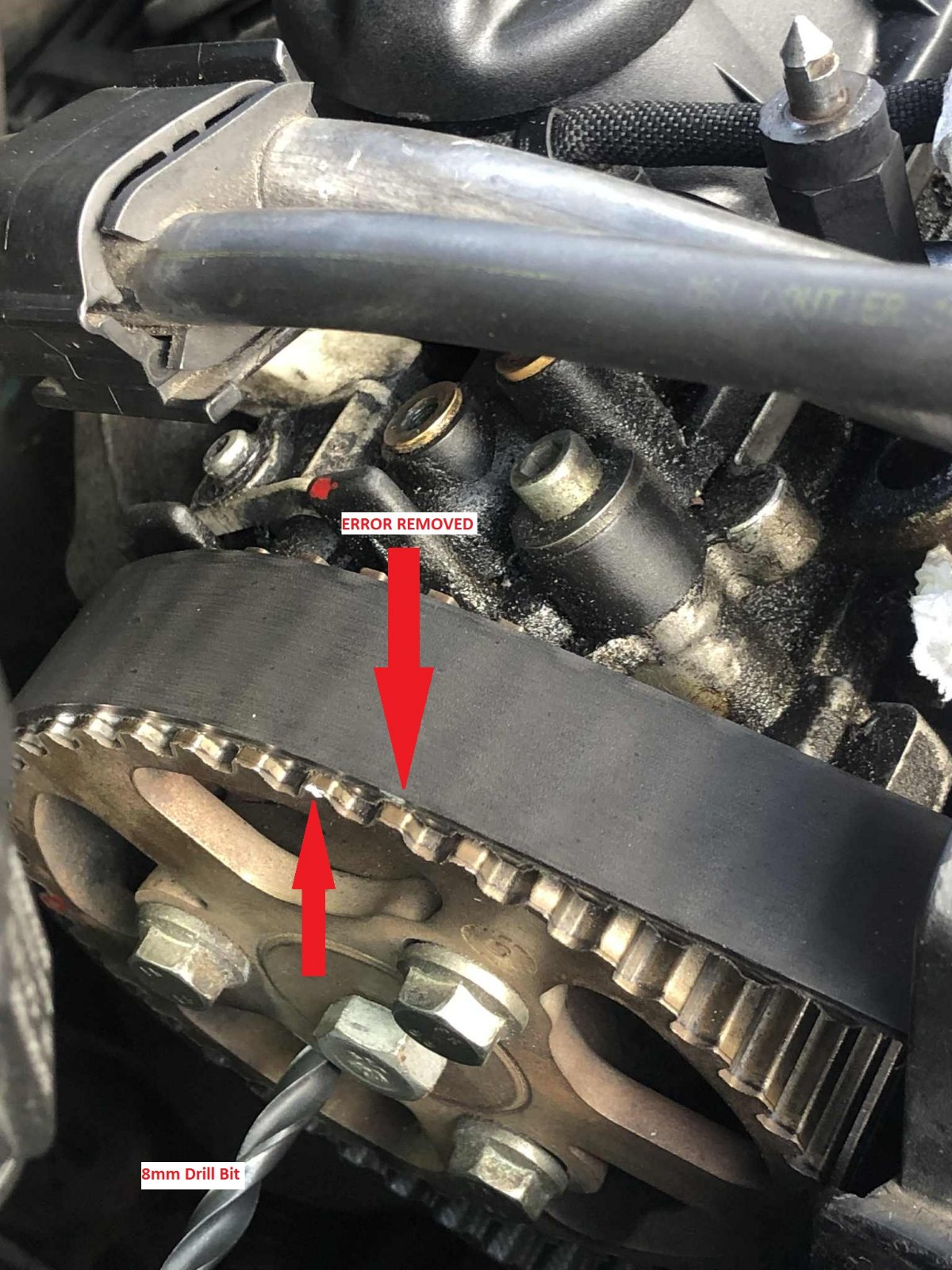

The 3 outer camshaft bolts are in slots, when slackened it only allows the teeth to mesh accurately when installing, so in order to remove any error it was necessary to secure the cambelt with hosepipe wedged in the gaps at the fuel pump and crankshaft BEFORE undoing the cambelt tensioner to stop it jumping out of the other sprockets.
Skull's - cambelt secured with hosepipe
Once the cambelt tensioner is slackened it allowed me to lift the belt away from JUST the camshaft sprocket and rotate the camshaft slightly to allow the cam locking pin (8mm drill bit in my case) to engage, then slide the belt back on, minimising any slack on the top belt run (temporarily slacken the 3 outer camshaft bolts if necessary) and then re-tension and lock the tensioner.

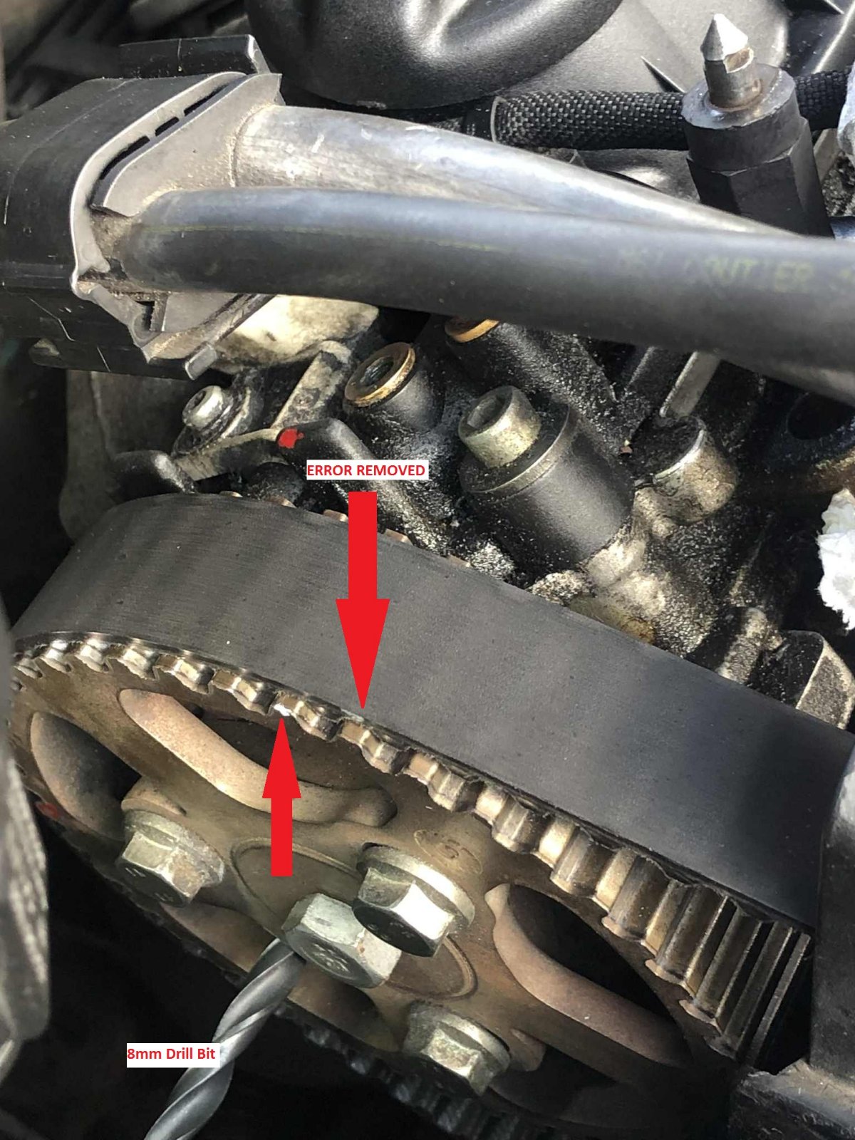

Skull's - Error removed
That small amount of misalignment equated to one tooth so at some stage it has jumped a tooth :shock:

So I stripped the top belt cover off again and played around with the belt tensioner, I've had to release the tension to reduce the whine but the belt is now running slacker than ideal.
New Tensioner required if the mystery is solved on Thursday ...I've booked it into my local MoT garage for a diagnostics session [-o<

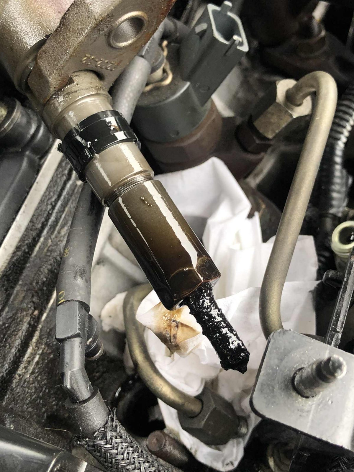

Injector extracted - no special tools needed :shock: I was a bit worried after seeing lots of garages posting horror videos.
I wanted to get it out before ordering one .. new @ £200+ re-manufactured @ £110+ used @ £25+
Skull's - Bad ?
Skull's - Bad ?
Haynes says I need a new copper washer :yes: upper seal :yes: injector clamp retaining nut :?: and high-pressure fuel pipe :?: for each removed injector :?:

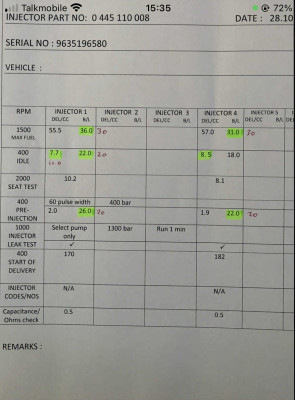

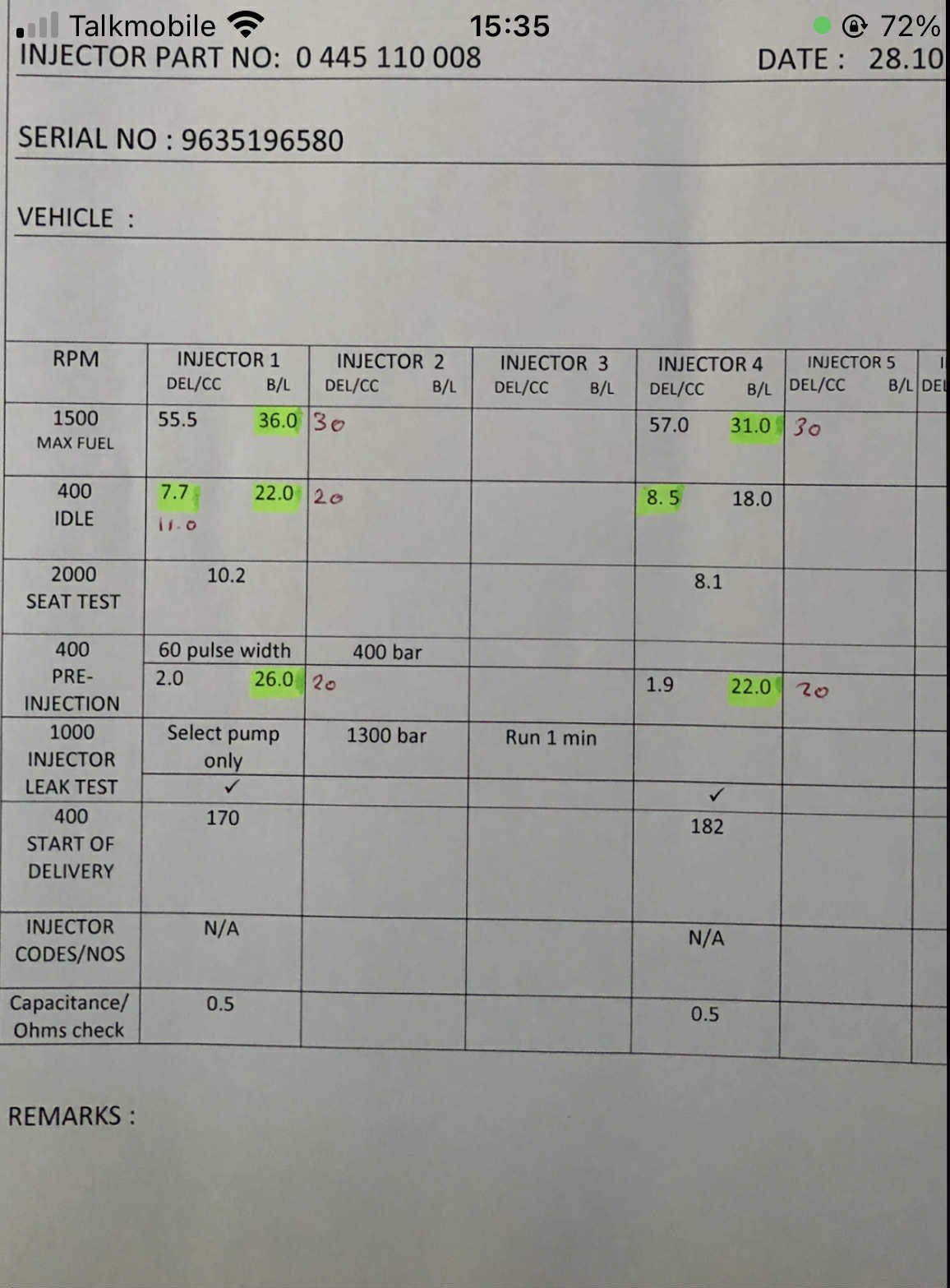

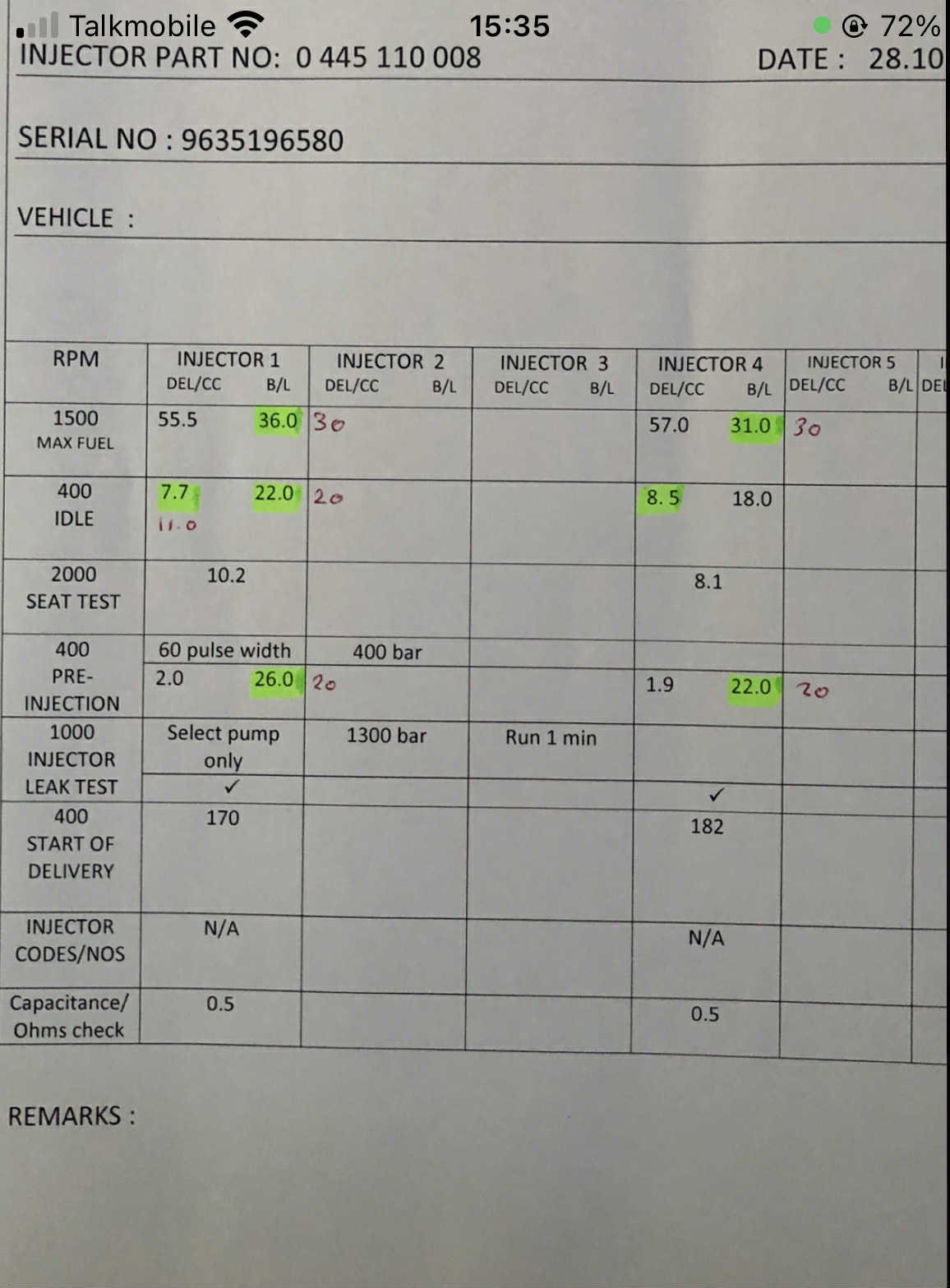

Well not the news I was expecting - both the injectors have tested 'FAULTY' :(
Remember I thought Injector 4 was a good one (best of the two apparantely :oops: )
Skull's -
Skull's -
Skull's -
Skull's -
High return rate
Low idle rate
Anyone think those results are still workable :?: (The red pen is the pass mark)
