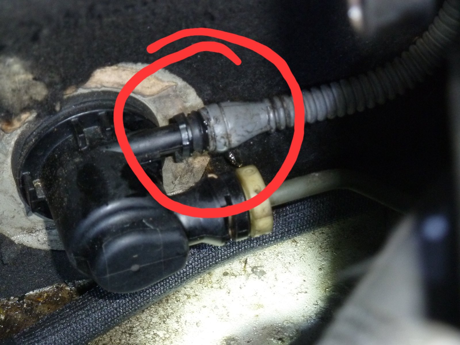

This is a possible cause
Husky.

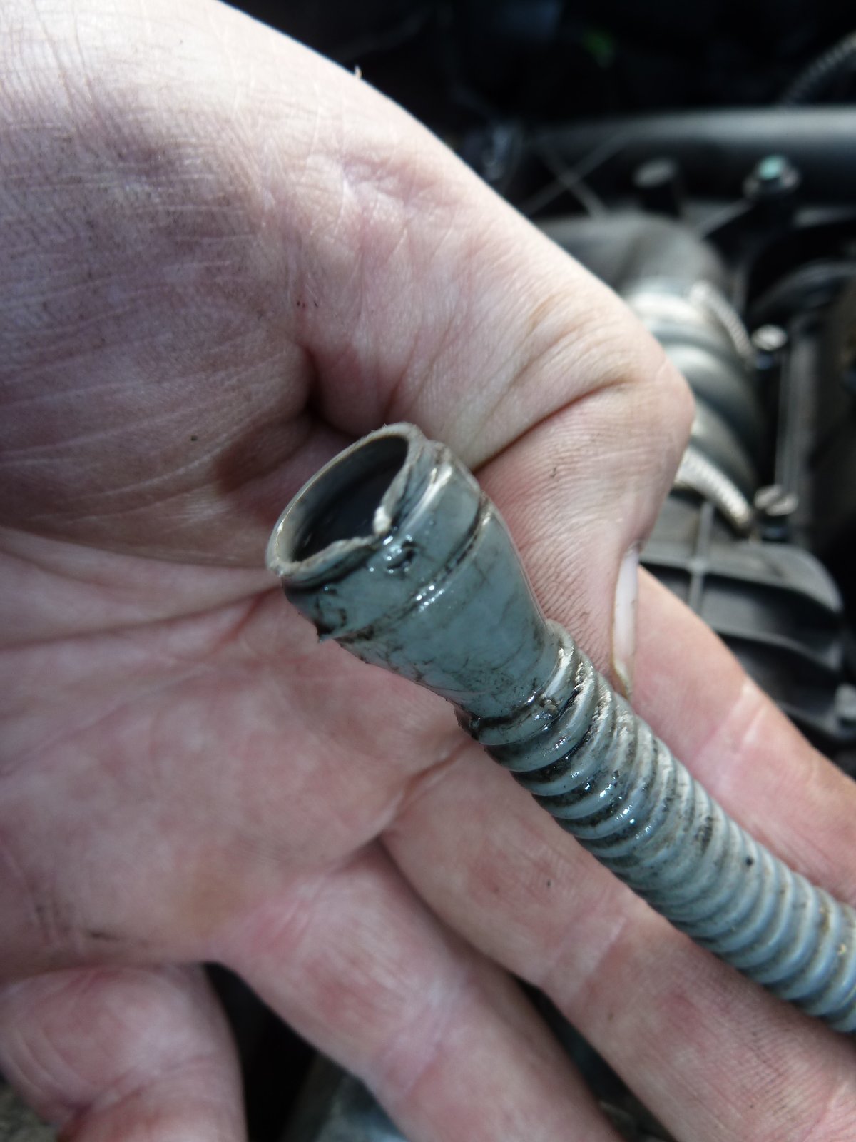

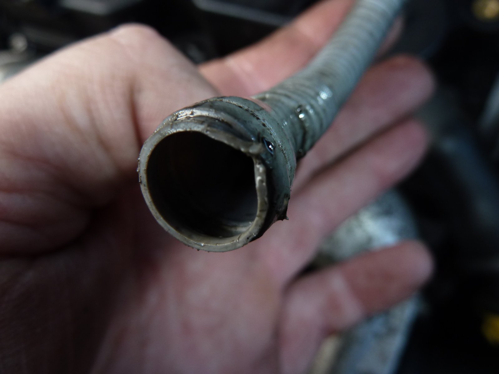

Re: C3 Picasso Clutch Issues
The fluid feed pipe end didnt look to healthy to be honest.

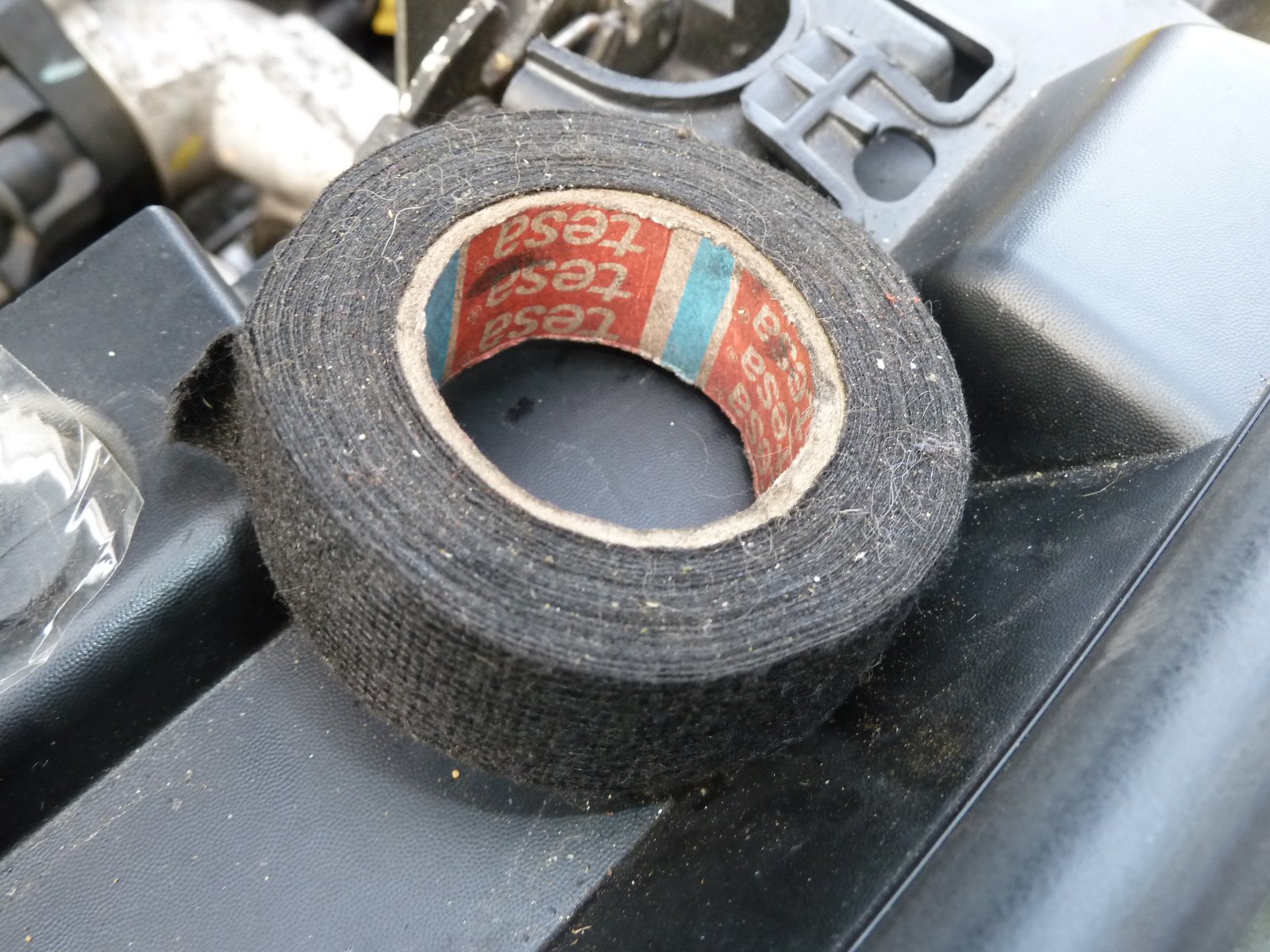

A bodge fix with these...
