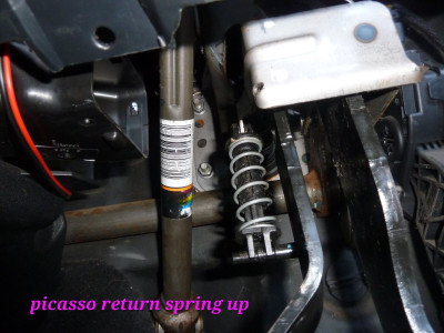

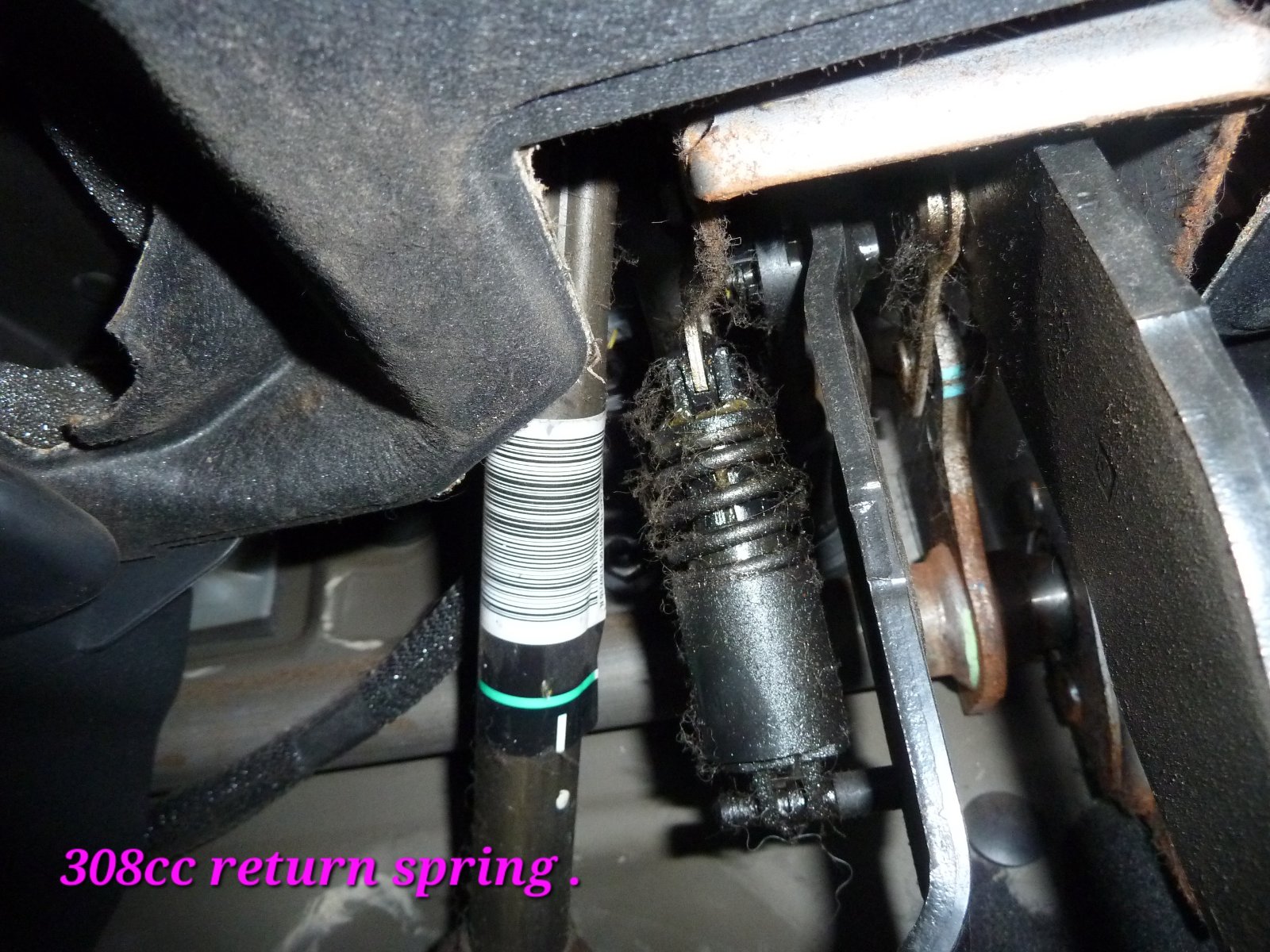

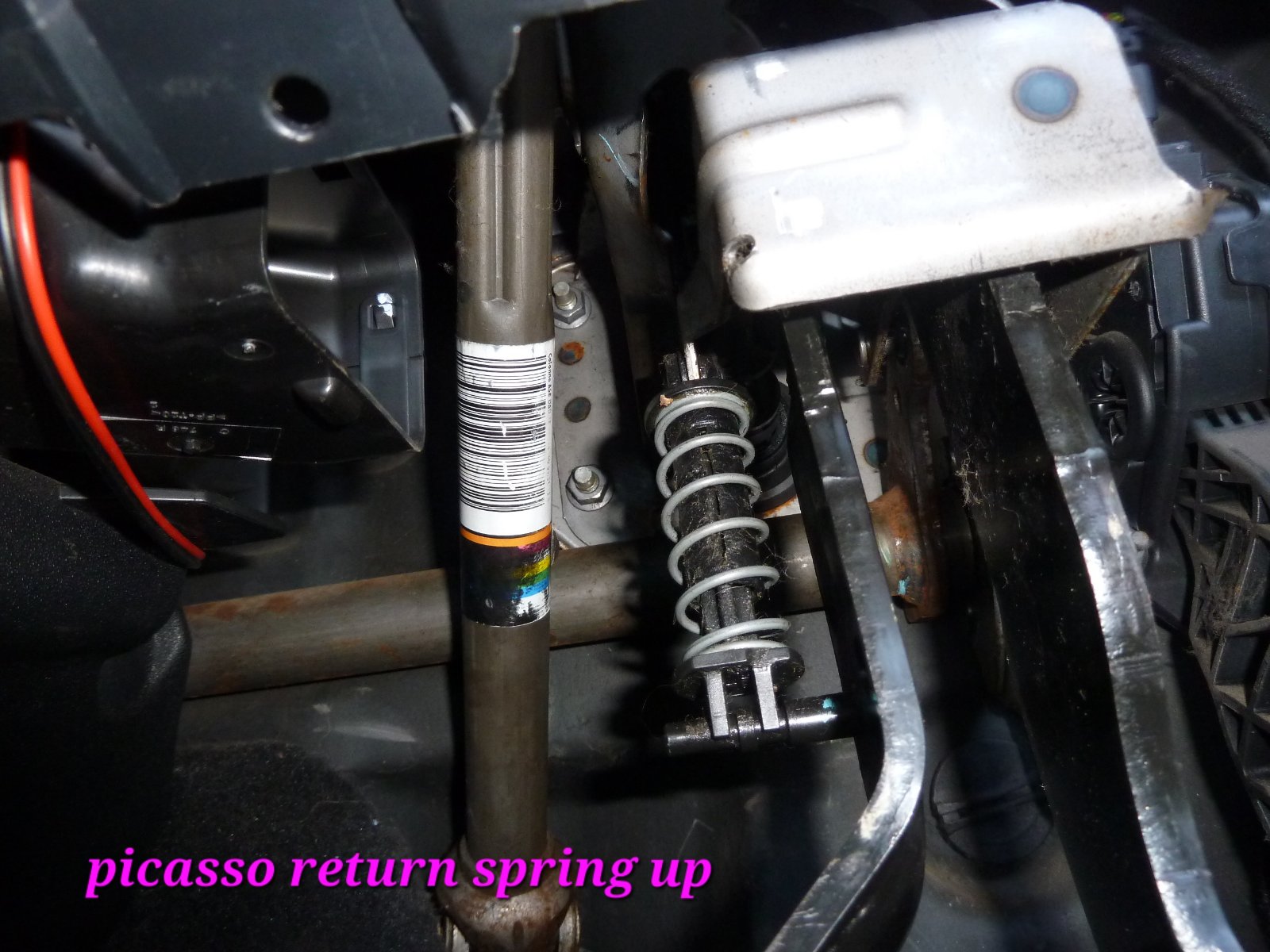

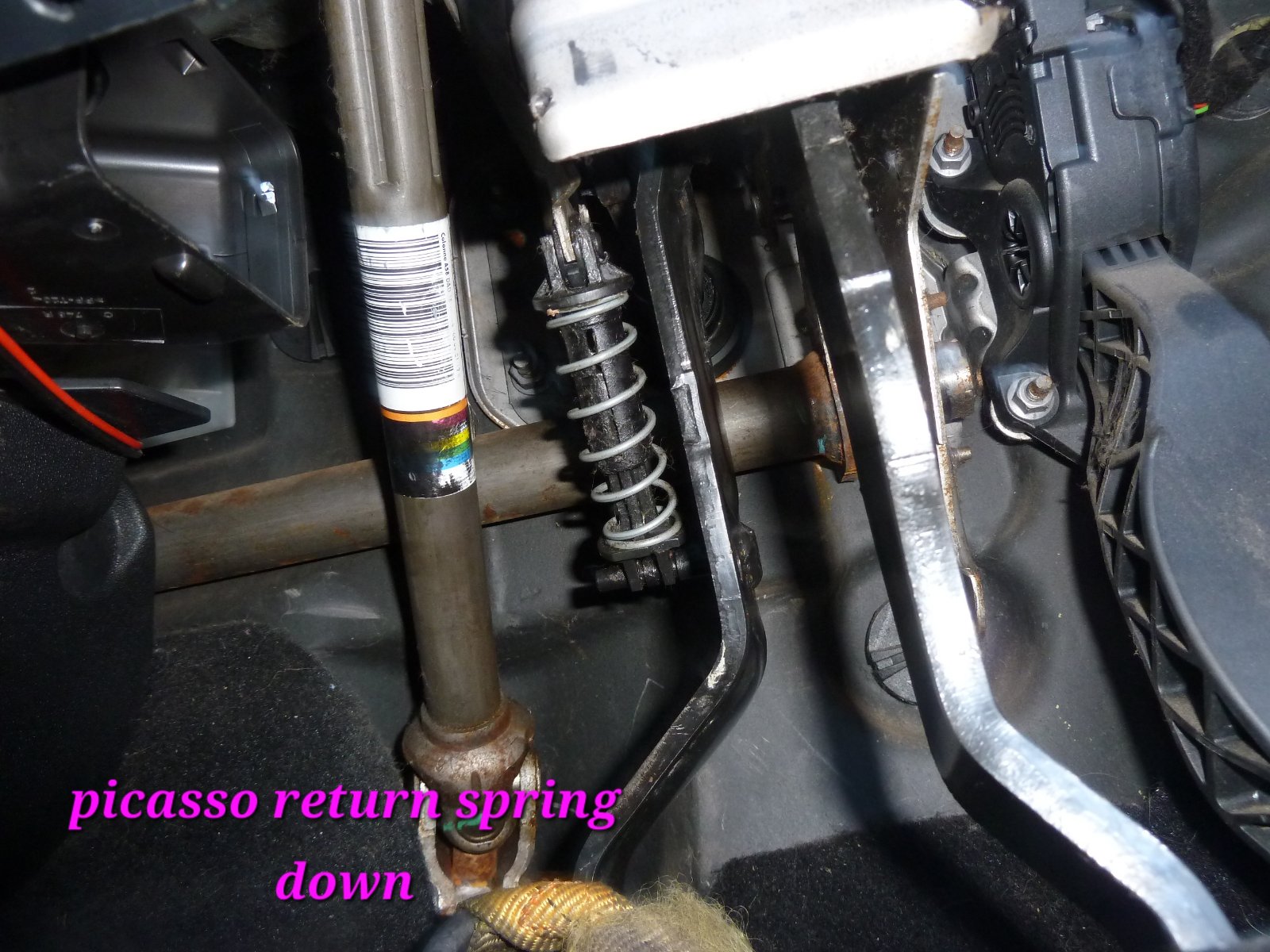

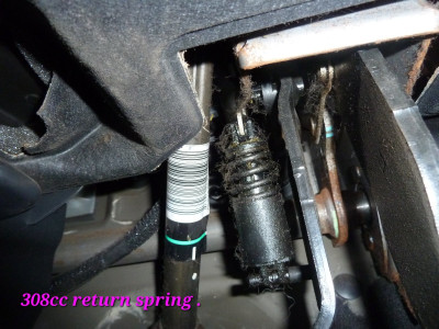

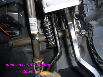

Well i clear the way to get a great view of the clutch pedal , the pedal has slight play but not sure if there is enought to justify the failures, now look at the photos , picasso vs 308cc ... this i feel is the real problem .
Shout out for @marc, if you see my post is my picasso missing a piece from this spring set up .

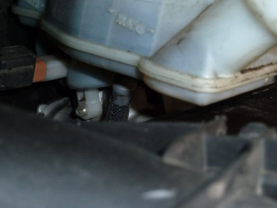

So true Jim , ive just this minute taken the master cylinder plunger peddle off is nipple, the pedal returns via spring but the feeling is pretty weak & lazy anyway my mechanic friends popping round later today so nows its all open for him to get a good view and i will see what he thinks.

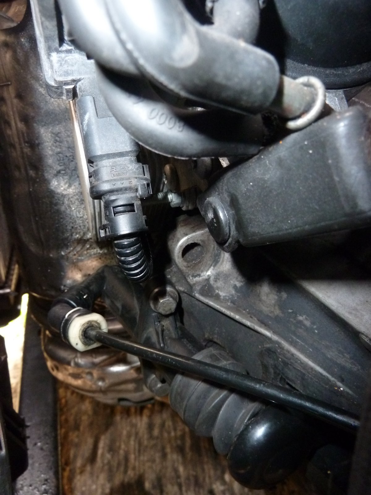

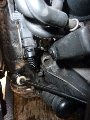

Also the fork release arm i tried that by hand & can feel it working the bearing nice and smooth push and slight pull making out i was the slave cylinder on the box . So at least the fork & bearing are ok .
I was wondering about ... see the next post , need to go take a photo.

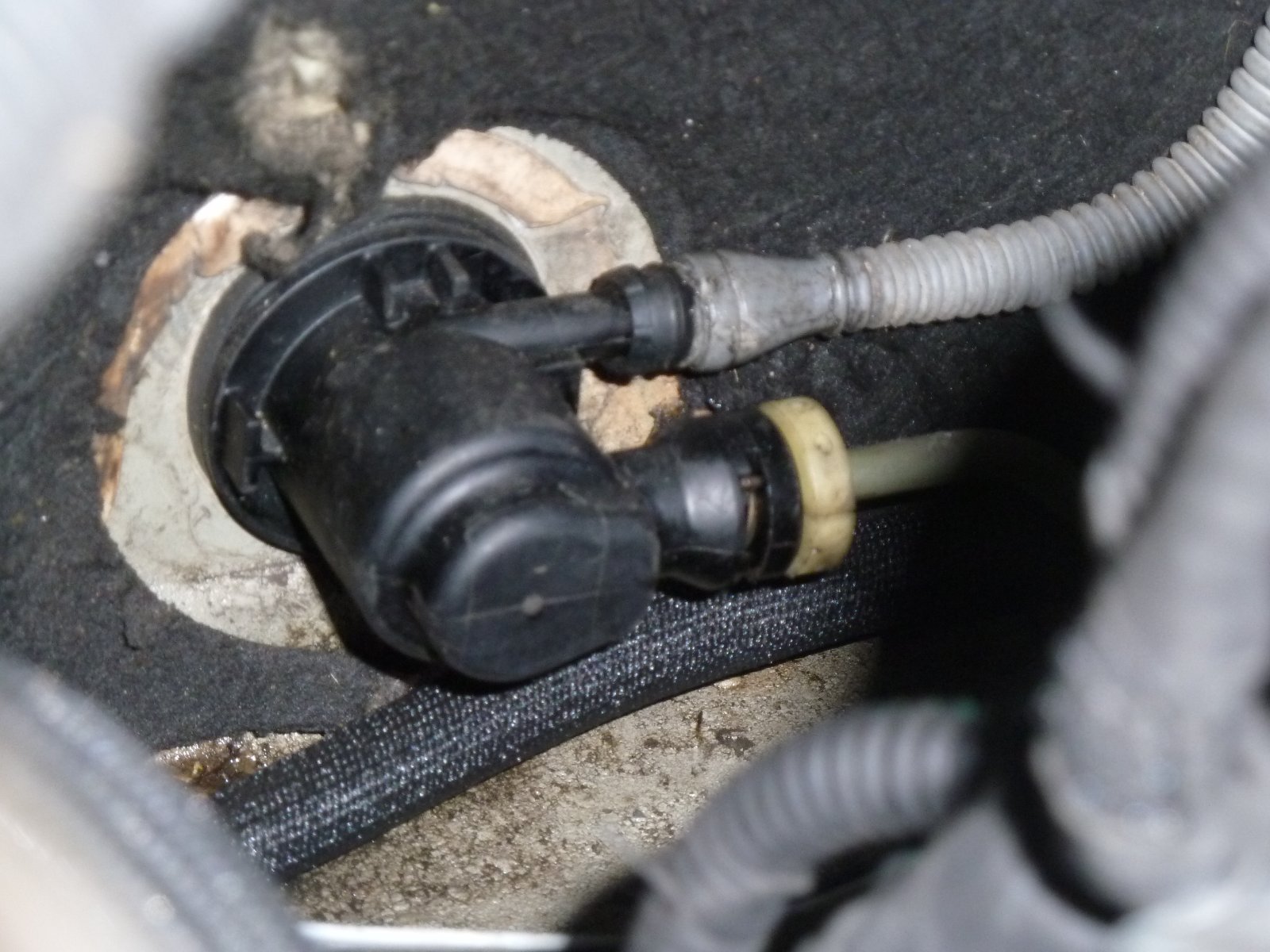

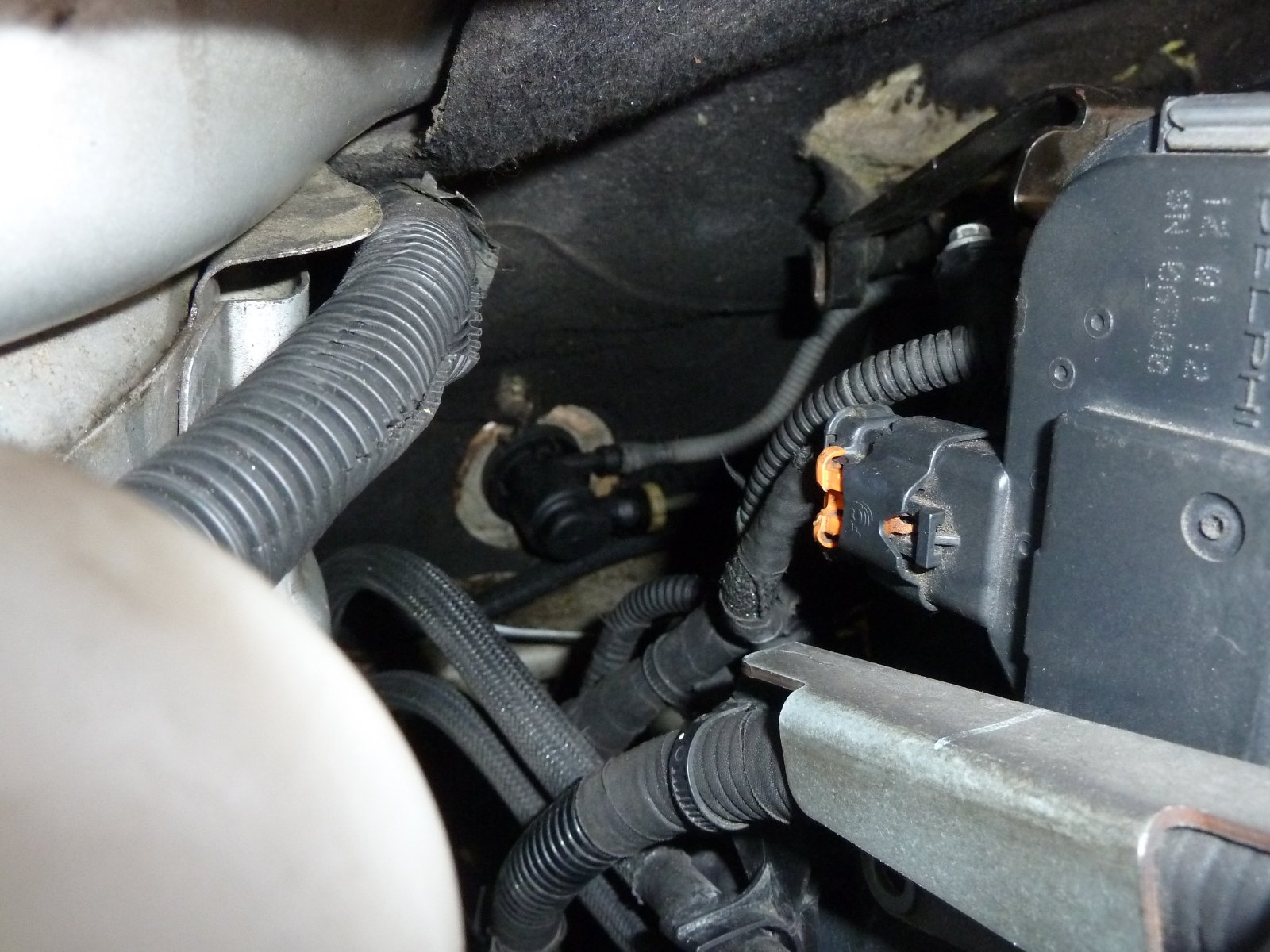

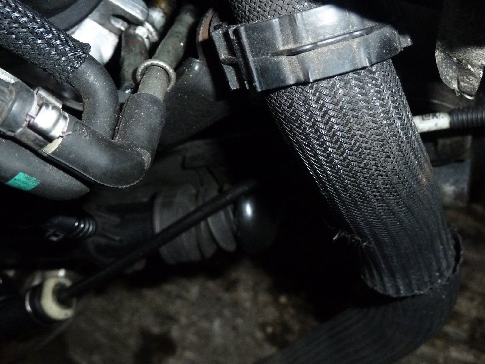

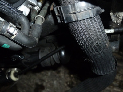

Fluid seen was done by me trying to bush fix the repair with out tools .
That little grey flexi pipe looks a little bit of an air inlet area. The gear box end nothing looking like its gone bad, the end of the slave which sits in the fork cup , im not sure what them black bits are seen sticking out , maybe padding to help rubber wear ? Oil filter housing covered in fluid , but this will all be cleaned off once the problem has been sorted. He hopes.

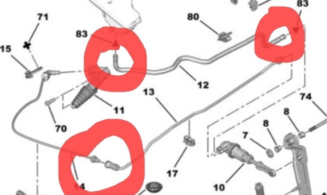

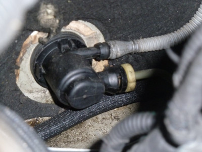

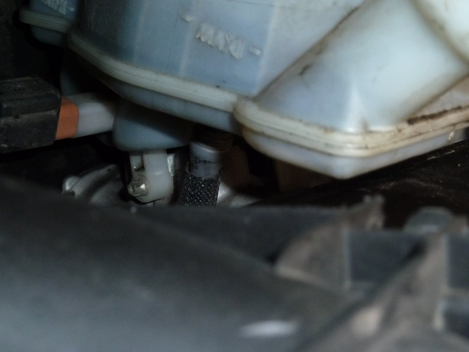

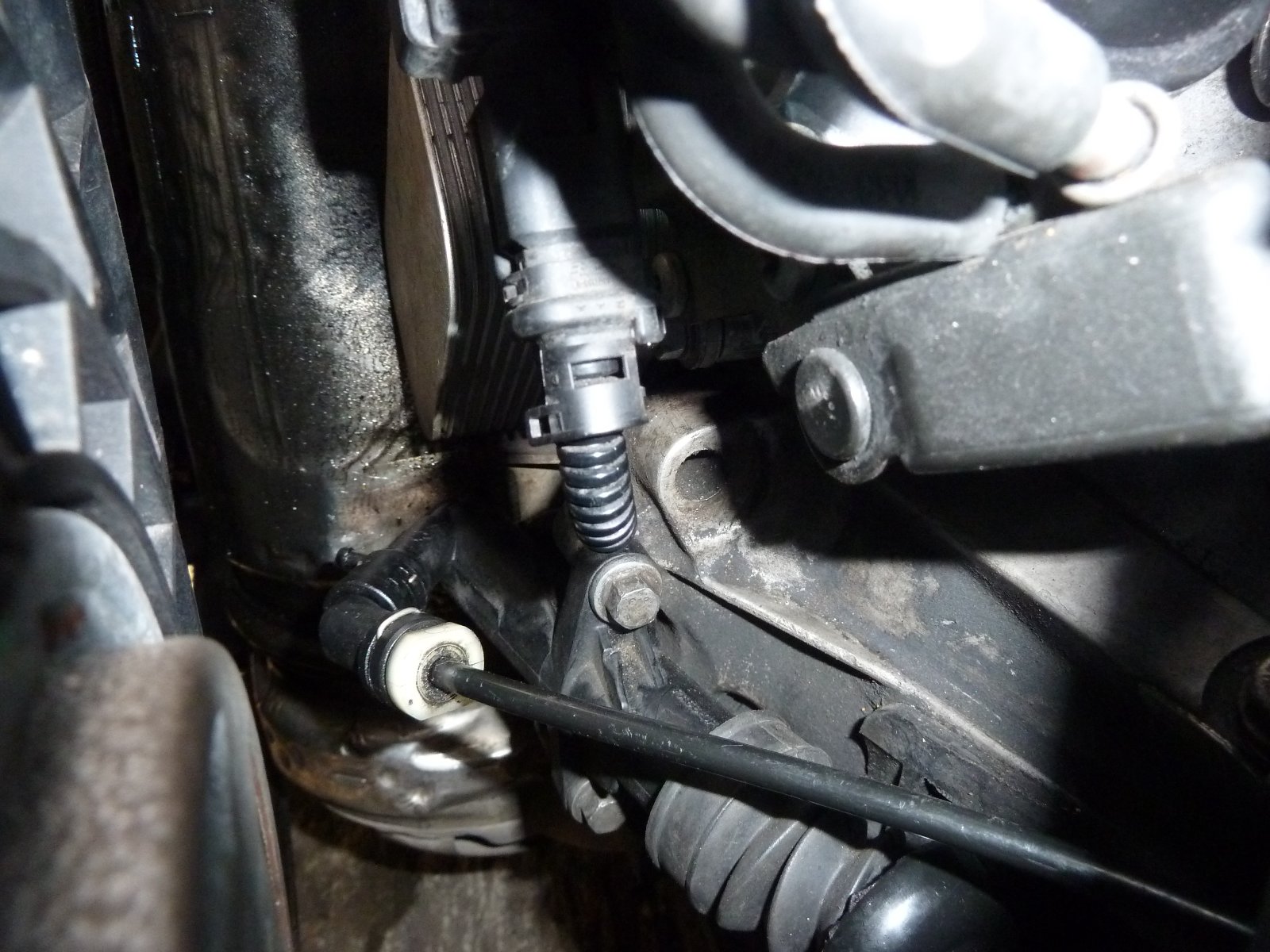

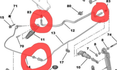

Theory of mine, possible week areas that could over time allow air to enter the system see red circles on the picture.
So tomorrow i will check these areas .

- Posts: 20821
- x 8017
Re: C3 Picasso Clutch Issues
On top of those Husky I have known hydraulic pipes to actually go porous along their length so don't automatically assume they are sound!! While you have it apart I'd suggest you seal and pressurise each pipe to ensure you don't have that issue.
