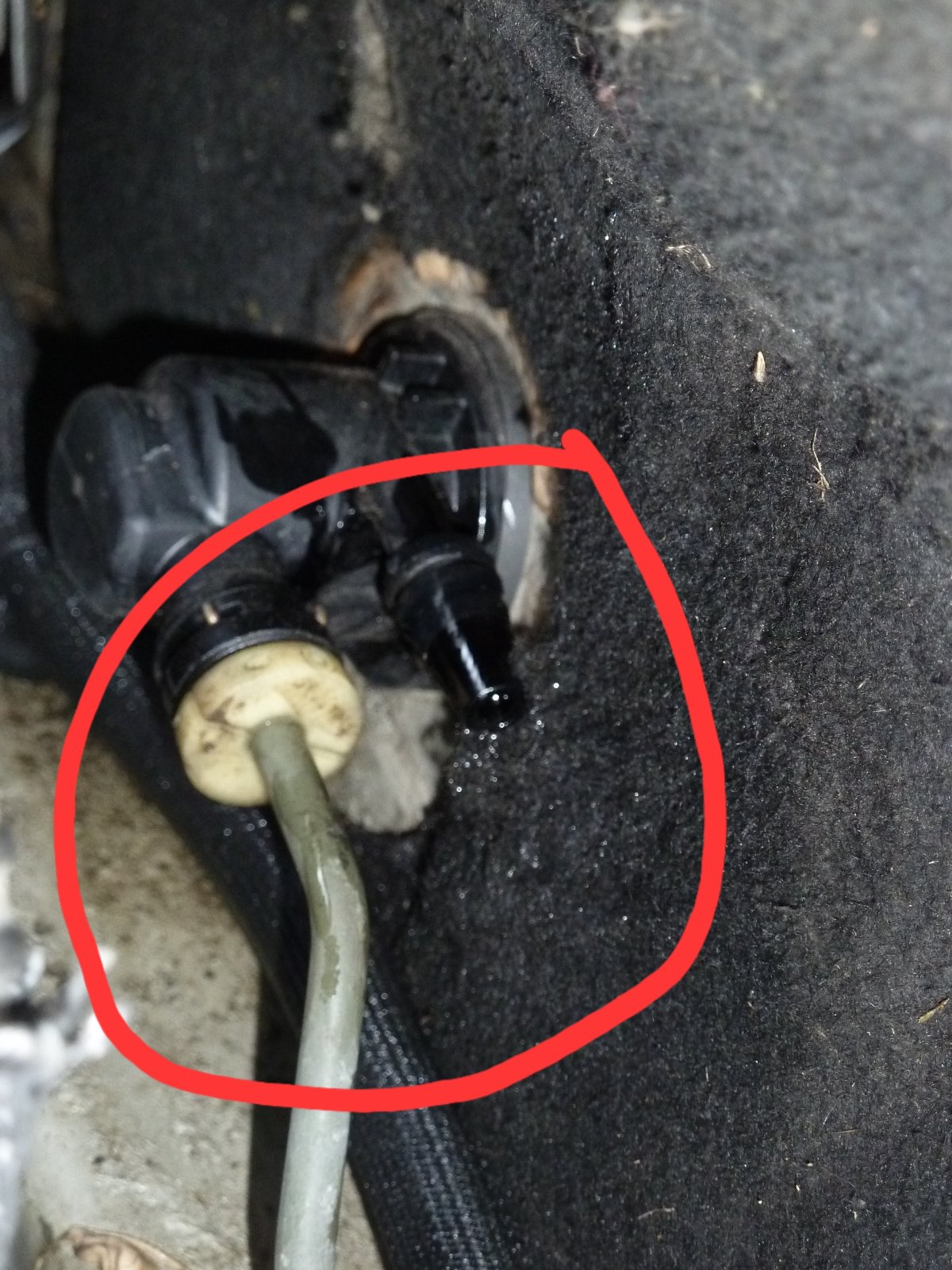

This is a possible cause

The fluid feed pipe end didnt look to healthy to be honest.

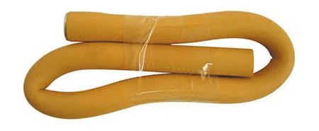

A bodge fix with these...
