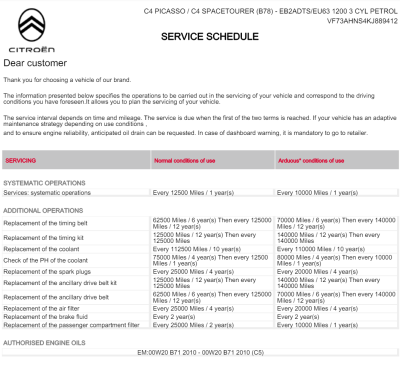

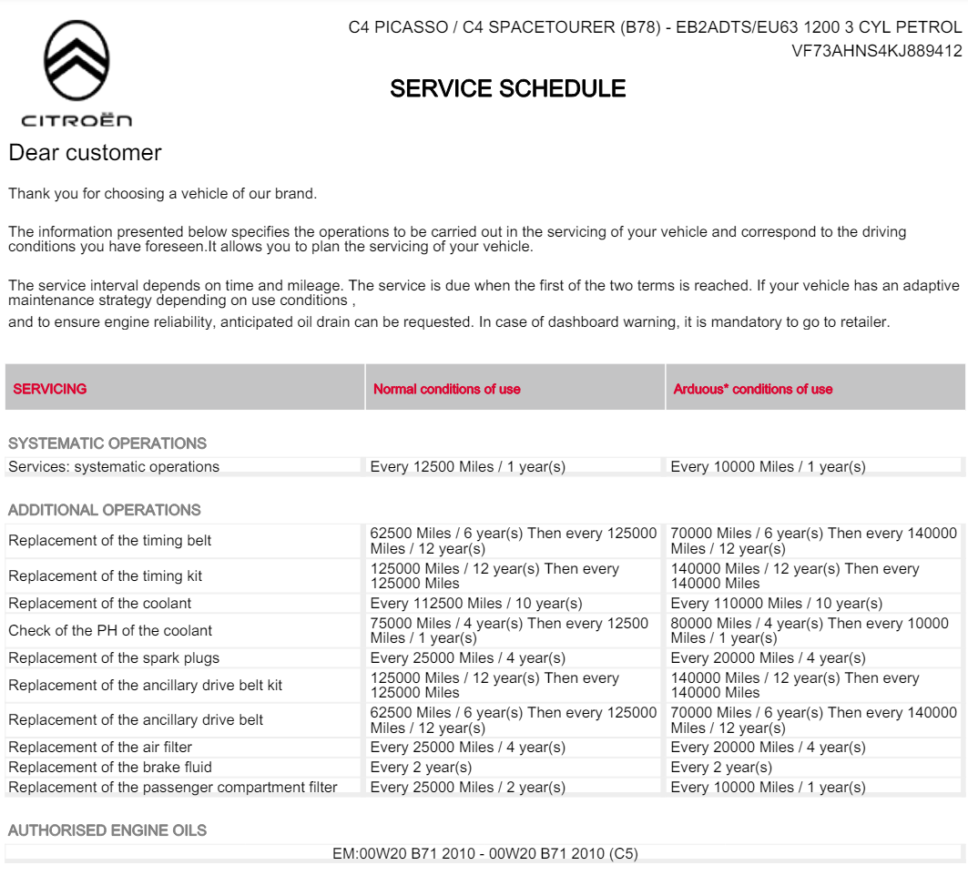

See below. It's very important on these to stick to the oil change interval, and to use only the specified oil because of the 'wet' cambelt.

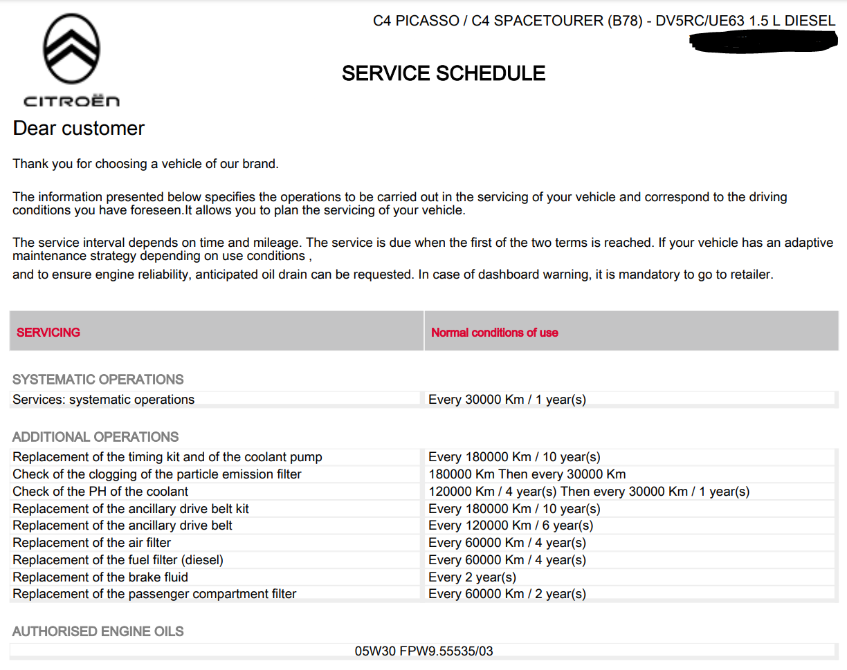

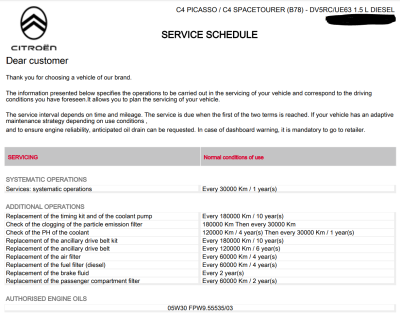

Hi Jozsef, thank you for your Forum donation.
Should you require any official part numbers & prices or parts diagrams for your PSA vehicle (s), please request these in the official parts thread Here, for the duration of your upgraded membership.
Here's your Servicing Schedule that shows when most things need doing along with the recommended engine oil and specification below:
