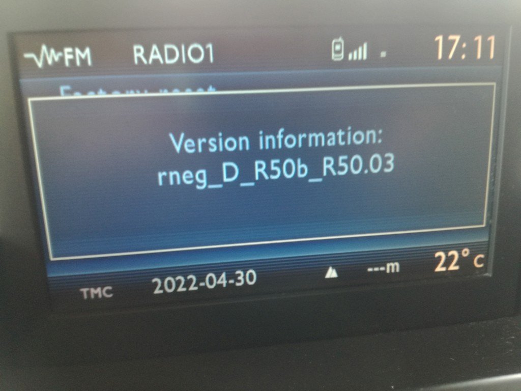

Re: MyWay Issues
I’m sorry I wasn’t clear because I just snatched the point out of the version number, which can be changing.
This is shown by the version number for an RT6: However, this is shown by the version number for WIPNAV+ in a Peugeot 5008. These pictures are not from my car. All I know is that version number "rneg_D_R50b_R50.03" is the same as software version "2.86". My origonal head unit has the firmware version "rneg_D_R29b_R29.02".
However, the purchased head unit contains the following: "rneg_D_R27b_R27.02"
So these were the R29 and R27 that I mentioned.
I don't know what software cd version they correspond to (2.06; 2.07 or something else?)

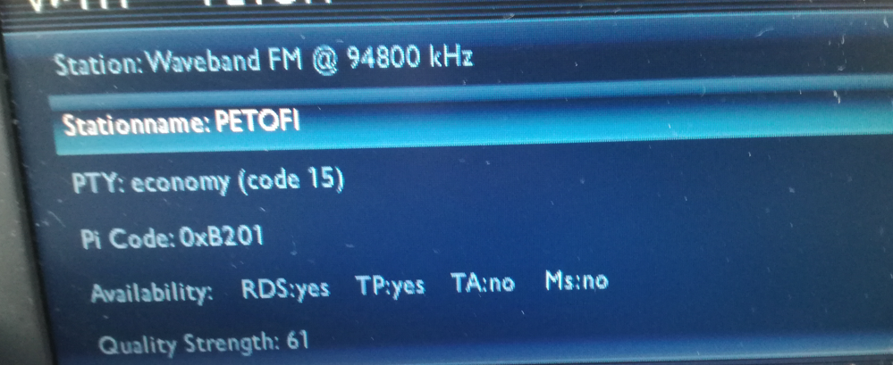

By the way, the original head unit communicates well with the car, as only the radio part is corrupted, it does not work the channels clean, the automatic search does not find a channel at all. However, there are all the channels in the radio menu, so when if I push the button from there, some of the channels working but only sound quieter, crackling. It is not an antenna problem, something with a noise filter, or anything else that could affect the signal clarity on the motherboard. I am not competent to improve it, electronic technician do not take the job either, so trash.

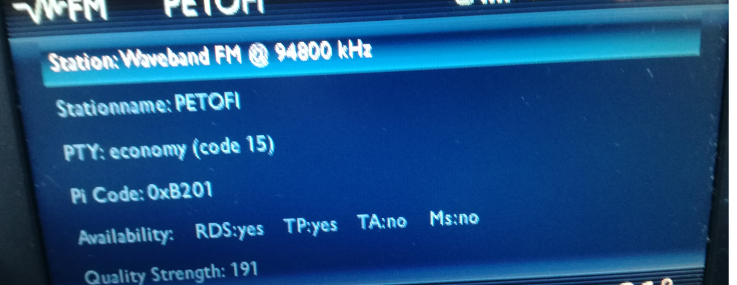

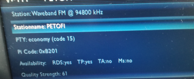

For comparison, I checked the radio parameters in the secret menu (setup +1,2.3 button) The quality strength of signal in case of original unit: 61, purchased head unit: 191.
But there is a channel that has 255 signal strength. Thanks again for the information, i hope it helps others.

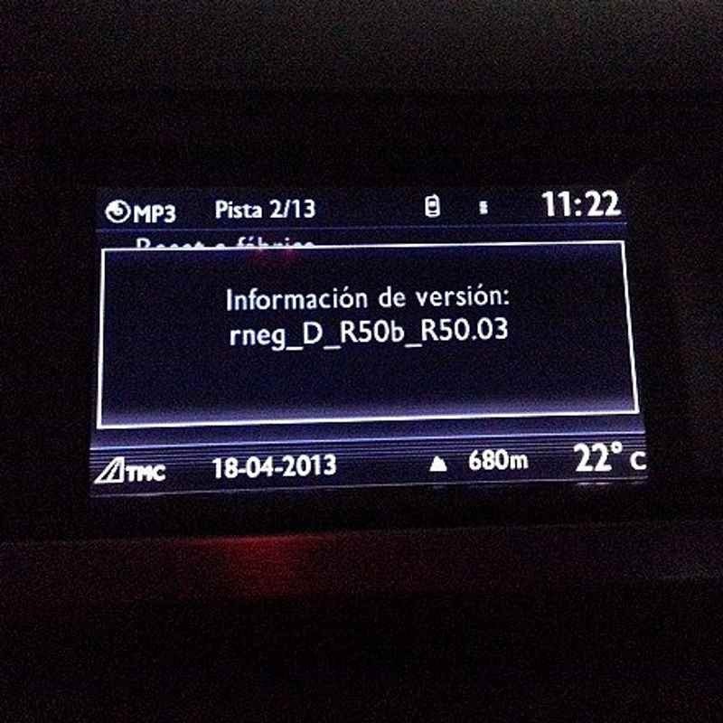

You are getting totally mixed up.
First to attach a picture, use the FULL POST EDITOR button before the SUBMIT button, then select ATTACHMENTs, browse to your files and upload them, then use the PLACE button to place the pictures where you want in your post.
You are mixing up navigation systems The first picture is from an eMyWay (RT6) system. The second picture is for the MyWay (RNEG) system which is completely different so that firmware is not relevant to your vehicle.

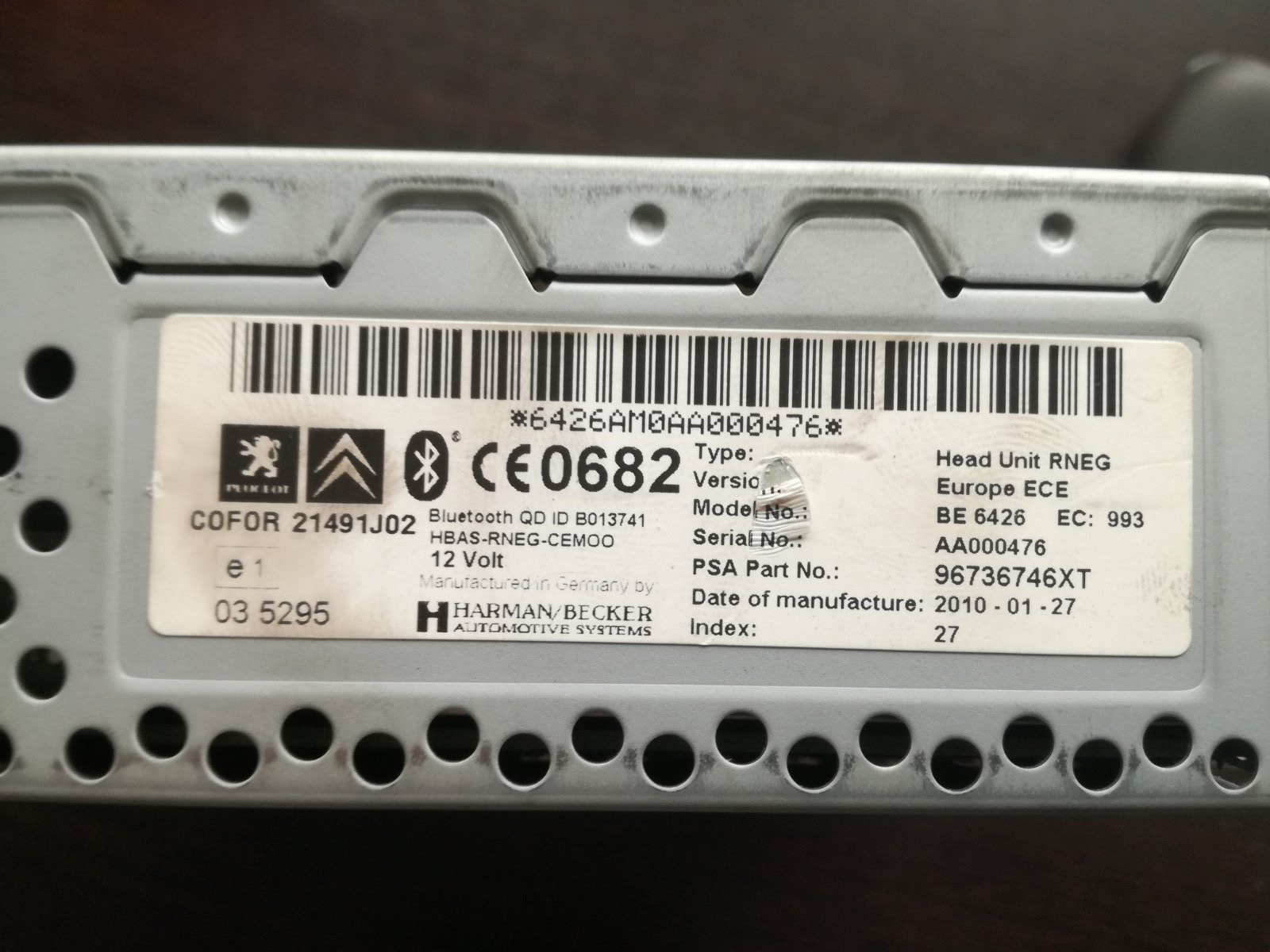

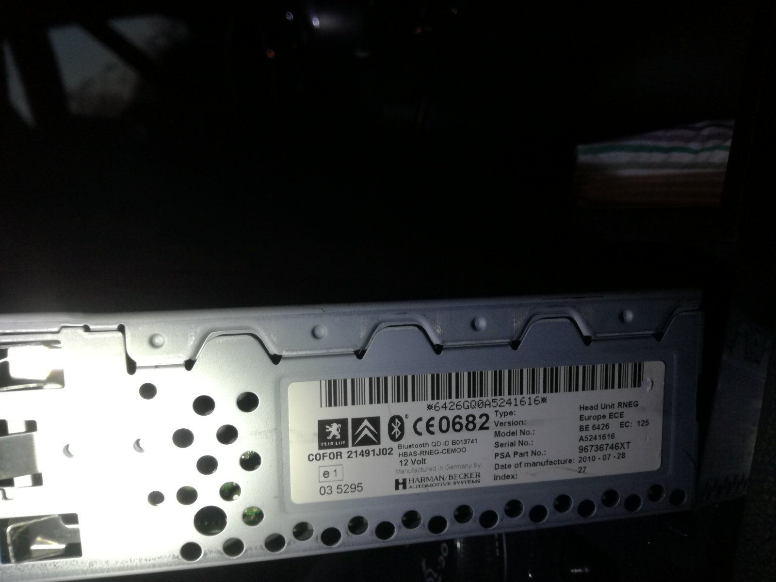

Can an internal card swap work?
Original unit: New replacement unit:

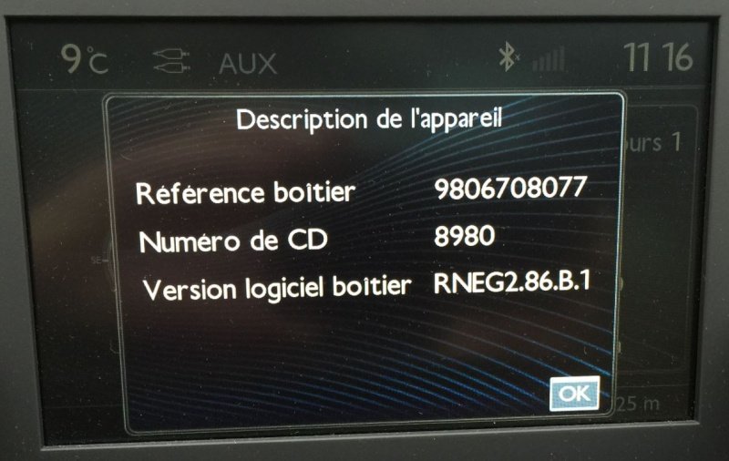

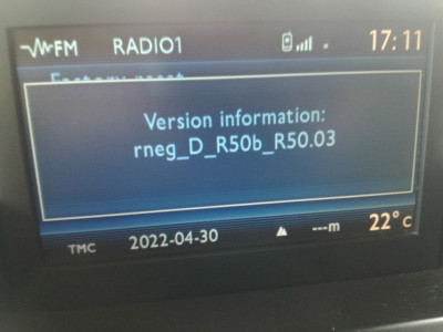

I had no problem putting the old one and then the new one again. The new one was put in a Peugeot service center and they started by typing in my chassis number. Both are included in my chassis number, so the car accepts them without any problem.
Well, I did the software update and I’m extremely sad because nothing has changed.

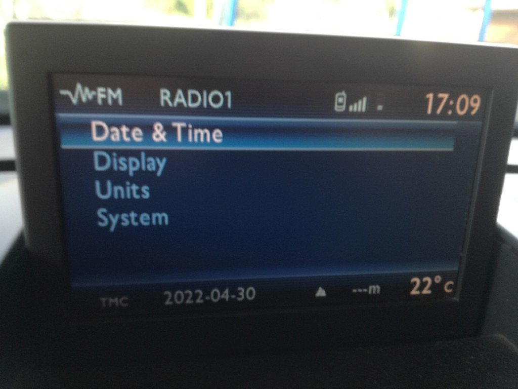

The monitor now displays this firmware version: But in the same way it does not communicate with the computer, does not write handbrake release, error messages, etc.

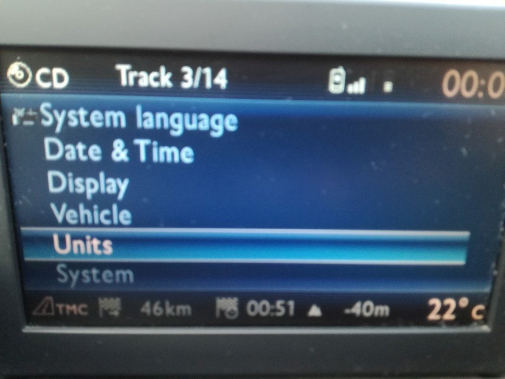

The settings menu is also incomplete, as before (no system language, no vehicle menu): In my original headunit, this is the setup menu: Apparently this is really just a configuration issue. I'm just a user, I don't have a connector or software to configure. When I replaced the head unit at a small rural Peugeot-Reanult service center, they rewrote the chassis number, the Citroen logo for a Peugeot, and to have a pop-up display, but nothing else could be configured. I have faint hope that because of the old firmware and if I left now they would be able to. They didn’t seem too knowledgeable, they didn’t even know how to update firmware. They said to me, they couldn’t configure anything because certain things were pre-programmed for the car in the factory, so I should have bought one out of a 5008, not out of a Citroen C3. If that's true, that's big problem. No one on E-bay says this, they advertise the headunit as if it were good for any vehicle (e.g., 308,3008,5008, C3, C5, DS3)
What should I do? Should i look for a more professional Peugeot service?
For now, I only see one way if I replace the internal sd card from the original headunit. Then the configuration must be correct, and the phisical hardware is the same. If the new head unit still doesn't communicate with the computer anyway, it means there's something physical wrong with the new head unit's connector or the motherboard.

As I already said, you have a MyWay unit from a Citroen and these are configured COMPLETELY differently to the Peugeot systems.
Your mechanic has managed to configure the retractable display ok and the VIN, but there may be more BSI settings to configure the unit for a Peugeot, because the data streams are sent to different outputs. If the parameters are not correct then the data will be sent (like the messages) but the system will not know where to send them or it will send them, but to the wrong output which isn't on the vehicle.
I suspect you need to reconfigure the Instrument panel ECU (in your vehicle it is the instrument panel with Matrix display), This is where the data streams are probably configured differently to Citroen vehicles, so this is where you need you mechanic to check for the configuration parameters.
