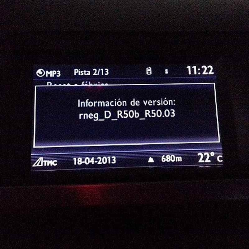

I’m sorry I wasn’t clear because I just snatched the point out of the version number, which can be changing.
This is shown by the version number for an RT6: However, this is shown by the version number for WIPNAV+ in a Peugeot 5008. These pictures are not from my car. All I know is that version number "rneg_D_R50b_R50.03" is the same as software version "2.86". My origonal head unit has the firmware version "rneg_D_R29b_R29.02".
However, the purchased head unit contains the following: "rneg_D_R27b_R27.02"
So these were the R29 and R27 that I mentioned.
I don't know what software cd version they correspond to (2.06; 2.07 or something else?)
As described, i can swap the two sd cards if the motherboard is just hardware. Thank you very much for your help.

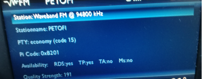

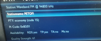

For comparison, I checked the radio parameters in the secret menu (setup +1,2.3 button) The quality strength of signal in case of original unit: 61, purchased head unit: 191.
But there is a channel that has 255 signal strength. Thanks again for the information, i hope it helps others.

By the way, the original head unit communicates well with the car, as only the radio part is corrupted, it does not work the channels clean, the automatic search does not find a channel at all. However, there are all the channels in the radio menu, so when if I push the button from there, some of the channels working but only sound quieter, crackling. It is not an antenna problem, something with a noise filter, or anything else that could affect the signal clarity on the motherboard. I am not competent to improve it, electronic technician do not take the job either, so trash.

You are getting totally mixed up.
First to attach a picture, use the FULL POST EDITOR button before the SUBMIT button, then select ATTACHMENTs, browse to your files and upload them, then use the PLACE button to place the pictures where you want in your post.
You are mixing up navigation systems The first picture is from an eMyWay (RT6) system. The second picture is for the MyWay (RNEG) system which is completely different so that firmware is not relevant to your vehicle.
If you don't know what system you have, post your VIN up.

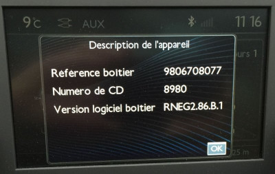

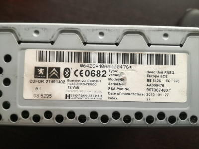

I'm sorry for my poor English, probably that's cause a misunderstanding. I'm aware I have a Myway WIPNAV+ system (RNEG). PN: 96736746XT (no usb port, but has an external sd card reader for the map on the front).
I bought the same PN from e-bay, 96736746XT from a citroen C3, but it has older software that doesn't communicate with my car's computer.
I also included a picture of RT6 just because I thought both systems could be upgraded from the same software cd (9691894880). Yet an RT6 headunit shows "RNEG2.86B1" , that's contains which printed on the a software CD (2.86), while the MyWay WIPNAV+ shows something else (example:"reng_D_R50b_R50.03"). If it is another firmware, does the Myway(RNEG) need another refresh CD, it is not the 9691894880?.
Could you give the part number to Myway(RNEG) from what software CD to upgrade?

Can an internal card swap work?
Original unit: New replacement unit:

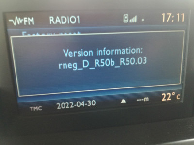

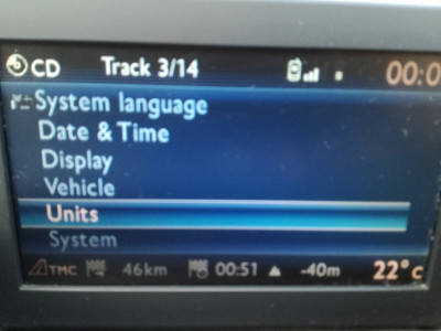

Re: MyWay Issues

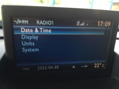

I had no problem putting the old one and then the new one again. The new one was put in a Peugeot service center and they started by typing in my chassis number. Both are included in my chassis number, so the car accepts them without any problem.
Well, I did the software update and I’m extremely sad because nothing has changed.
The monitor now displays this firmware version: But in the same way it does not communicate with the computer, does not write handbrake release, error messages, etc.
The settings menu is also incomplete, as before (no system language, no vehicle menu): In my original headunit, this is the setup menu: Apparently this is really just a configuration issue. I'm just a user, I don't have a connector or software to configure. When I replaced the head unit at a small rural Peugeot-Reanult service center, they rewrote the chassis number, the Citroen logo for a Peugeot, and to have a pop-up display, but nothing else could be configured. I have faint hope that because of the old firmware and if I left now they would be able to. They didn’t seem too knowledgeable, they didn’t even know how to update firmware. They said to me, they couldn’t configure anything because certain things were pre-programmed for the car in the factory, so I should have bought one out of a 5008, not out of a Citroen C3. If that's true, that's big problem. No one on E-bay says this, they advertise the headunit as if it were good for any vehicle (e.g., 308,3008,5008, C3, C5, DS3)
What should I do? Should i look for a more professional Peugeot service?

Re: MyWay Issues
I understand, thank you very much. So BSI teaching could put data on the display. There is no back and forth communication at the moment, because if I set the matrix display to navigate (when it indicates the direction with arrows), it won't work either, so the matrix display doesn't show the information from the headunit.
This would not solve the incomplete menu yet. I can set the daytime running light in the "Vehicle" menu, that would also be important.
However, when I put it back, the communication with the old headunit was working again, so the BSI is well configured for that, so I wanted to change the headunit configuration instead.
Why don't you recommend swapping the internal micro sd card? Is there any risk involved?
I used to find an auto hi-fi mechanic who said he could solve my problem but would ask for almost as much money as the new headunit cost.
However, I can also swap the card at no cost.
