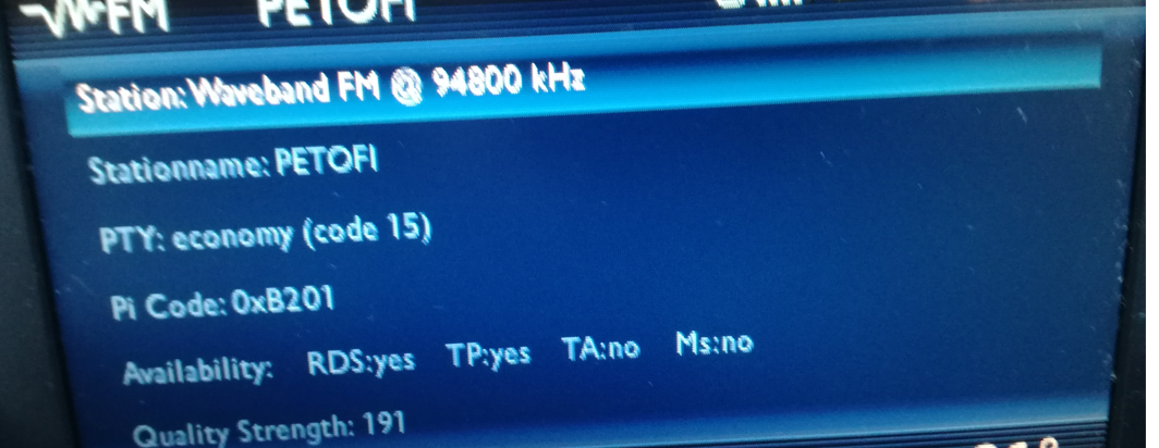

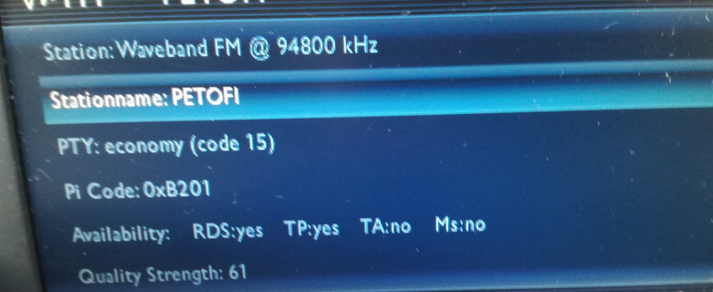

By the way, the original head unit communicates well with the car, as only the radio part is corrupted, it does not work the channels clean, the automatic search does not find a channel at all. However, there are all the channels in the radio menu, so when if I push the button from there, some of the channels working but only sound quieter, crackling. It is not an antenna problem, something with a noise filter, or anything else that could affect the signal clarity on the motherboard. I am not competent to improve it, electronic technician do not take the job either, so trash.
For comparison, I checked the radio parameters in the secret menu (setup +1,2.3 button) The quality strength of signal in case of original unit: 61, purchased head unit: 191.
But there is a channel that has 255 signal strength. Thanks again for the information, i hope it helps others.

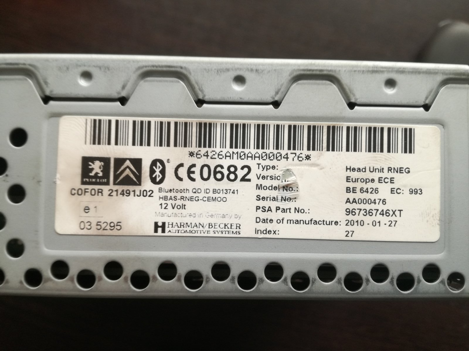

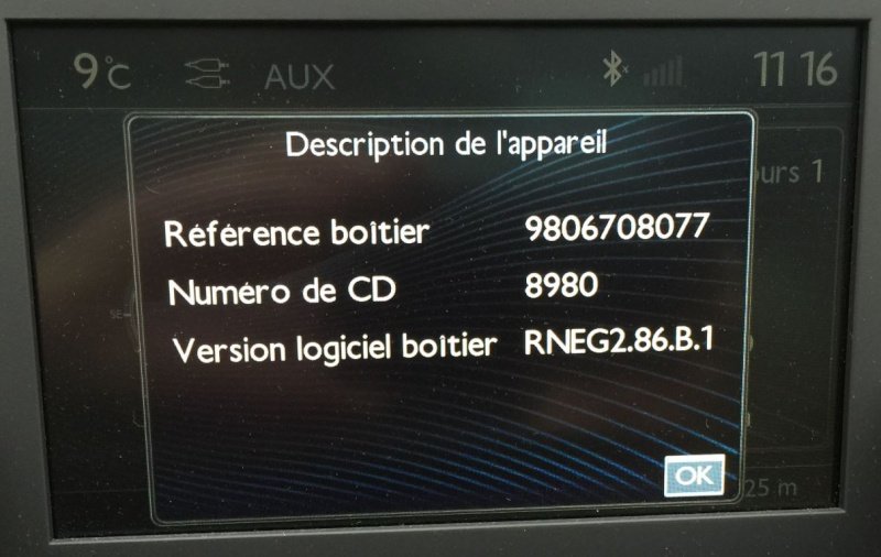

I'm sorry for my poor English, probably that's cause a misunderstanding. I'm aware I have a Myway WIPNAV+ system (RNEG). PN: 96736746XT (no usb port, but has an external sd card reader for the map on the front).
I bought the same PN from e-bay, 96736746XT from a citroen C3, but it has older software that doesn't communicate with my car's computer.
I also included a picture of RT6 just because I thought both systems could be upgraded from the same software cd (9691894880). Yet an RT6 headunit shows "RNEG2.86B1" , that's contains which printed on the a software CD (2.86), while the MyWay WIPNAV+ shows something else (example:"reng_D_R50b_R50.03"). If it is another firmware, does the Myway(RNEG) need another refresh CD, it is not the 9691894880?.
Could you give the part number to Myway(RNEG) from what software CD to upgrade?

The eMyWay RT6 and MyWay RNEG are 2 entirely different systems and do not use the same firmware as although they may appear to be similar that's where it ends.
Forget Firmware 2.86.
As for changing the units over - you can swap the head units - however, you will still need to configure the unit to your vehicle and still need to VIN code it each time you replace it with another unit.
A word of caution - never disconnect any plugs on the back of the head unit without first removing the large Quadlock connector first, and always reconnect it last.

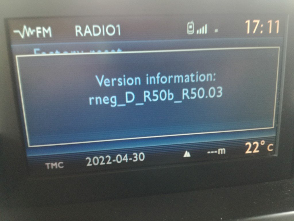

I had no problem putting the old one and then the new one again. The new one was put in a Peugeot service center and they started by typing in my chassis number. Both are included in my chassis number, so the car accepts them without any problem.
Well, I did the software update and I’m extremely sad because nothing has changed.
The monitor now displays this firmware version: But in the same way it does not communicate with the computer, does not write handbrake release, error messages, etc.

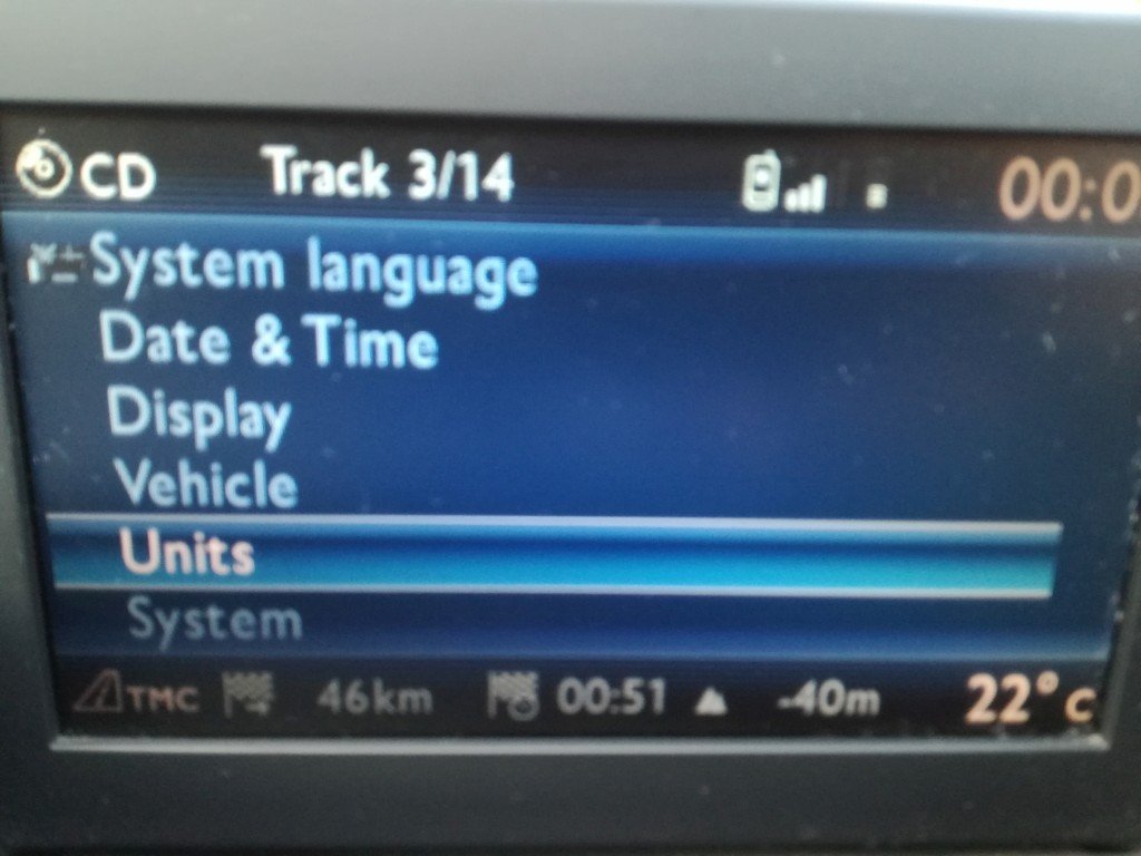

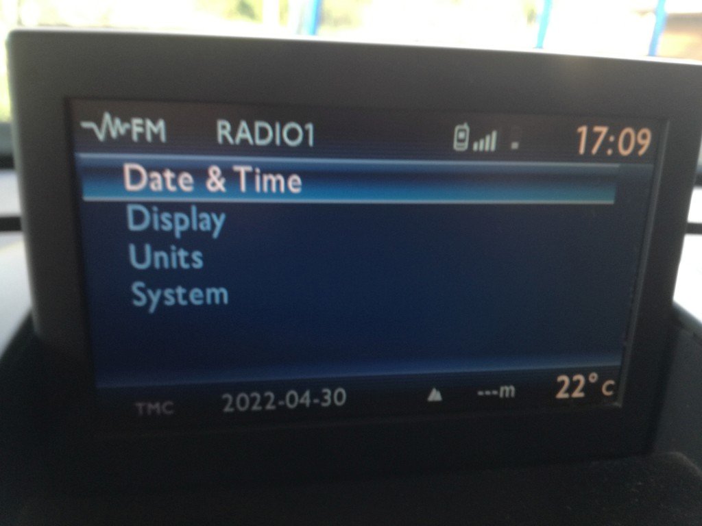

The settings menu is also incomplete, as before (no system language, no vehicle menu): In my original headunit, this is the setup menu: Apparently this is really just a configuration issue. I'm just a user, I don't have a connector or software to configure. When I replaced the head unit at a small rural Peugeot-Reanult service center, they rewrote the chassis number, the Citroen logo for a Peugeot, and to have a pop-up display, but nothing else could be configured. I have faint hope that because of the old firmware and if I left now they would be able to. They didn’t seem too knowledgeable, they didn’t even know how to update firmware. They said to me, they couldn’t configure anything because certain things were pre-programmed for the car in the factory, so I should have bought one out of a 5008, not out of a Citroen C3. If that's true, that's big problem. No one on E-bay says this, they advertise the headunit as if it were good for any vehicle (e.g., 308,3008,5008, C3, C5, DS3)
What should I do? Should i look for a more professional Peugeot service?
For now, I only see one way if I replace the internal sd card from the original headunit. Then the configuration must be correct, and the phisical hardware is the same. If the new head unit still doesn't communicate with the computer anyway, it means there's something physical wrong with the new head unit's connector or the motherboard.

As I already said, you have a MyWay unit from a Citroen and these are configured COMPLETELY differently to the Peugeot systems.
Your mechanic has managed to configure the retractable display ok and the VIN, but there may be more BSI settings to configure the unit for a Peugeot, because the data streams are sent to different outputs. If the parameters are not correct then the data will be sent (like the messages) but the system will not know where to send them or it will send them, but to the wrong output which isn't on the vehicle.
I suspect you need to reconfigure the Instrument panel ECU (in your vehicle it is the instrument panel with Matrix display), This is where the data streams are probably configured differently to Citroen vehicles, so this is where you need you mechanic to check for the configuration parameters.

Ok that's enough for me, I'll take it.
First I will put the old head unit back, I also do the firmware update to make it the same.
Then I'll do the internal card exchange.
I will share my experience with you.
Many thanks Marc
