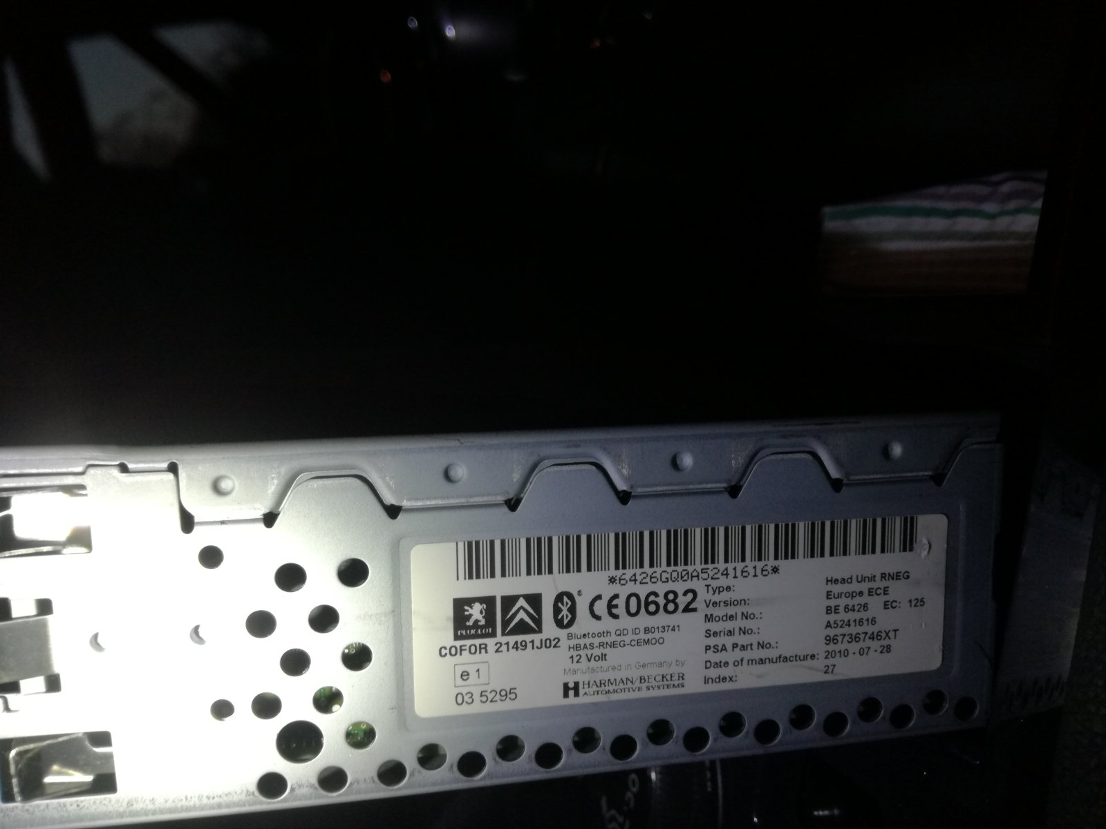

I'm sorry for my poor English, probably that's cause a misunderstanding. I'm aware I have a Myway WIPNAV+ system (RNEG). PN: 96736746XT (no usb port, but has an external sd card reader for the map on the front).
I bought the same PN from e-bay, 96736746XT from a citroen C3, but it has older software that doesn't communicate with my car's computer.
I also included a picture of RT6 just because I thought both systems could be upgraded from the same software cd (9691894880). Yet an RT6 headunit shows "RNEG2.86B1" , that's contains which printed on the a software CD (2.86), while the MyWay WIPNAV+ shows something else (example:"reng_D_R50b_R50.03"). If it is another firmware, does the Myway(RNEG) need another refresh CD, it is not the 9691894880?.
Could you give the part number to Myway(RNEG) from what software CD to upgrade?

Many thanks Marc
First I will put the old head unit back, I also do the firmware update to make it the same.
Then I'll do the internal card exchange.
I will share my experience with you.
Many thanks Marc
