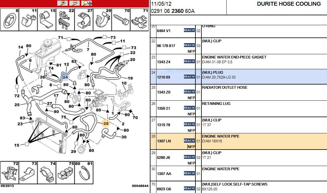

Hi,
One of the coolant hoses connecting the oil cooler to the radiator ruptured on my Xantia 2 1.9TD. As per Citroen's Servicebox, the OEM part is 1307LN. This hose is nowhere to be found, so I checked the same hose for a Xantia 1 1.9TD with a/c and there the OEM number is 1307AK, and this hose is readily available.
Does anyone know if these parts are interchangeable?
Xantia 2 1.9TD, radiator-to-cooler hose question.

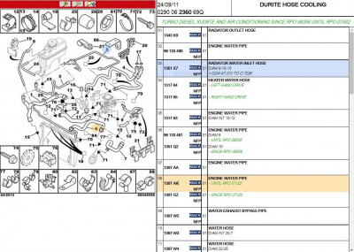

Both 1307LN and 1307AK are NFP at Citroen, but do look pretty much equivalent to each other.
Both fitted to Xantia XUD9TE with A/C... Your car's RP = 7889
1307 AK was fitted to cars RP 6356-7482
1307 GZ was fitted from RP 7123 onwards, but also NFP, and not showing up on the searches I did.
1307 AK showing in stock at Mister Auto UK, as a SASIC SWH0288 £23.50
It's also showing in stock on Autodoc - a couple of brand choices.
All seem to connect oil cooler to radiator bottom right.
Not sure whether Mister Auto UK is now fully active again; you'll need to try it.
Item showing as ok on their .es site, and most stock is held in France anyway.
Hope helpful.

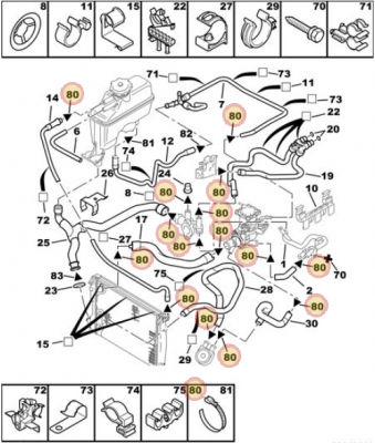

I'd also need to change the hose clamps for the said hose, but I can't clearly make it out what the OEM numbers are on those. Could you help me out on those? I hope at least they are always the same.
Xantia Estate MK.2 1.9 TD, 1999
- x 6957
Re: Xantia 2 1.9TD, radiator-to-cooler hose question.
If it's the Jubilee hose clamps item (80), these are part: 6981K4 (DIAM 23-35 LARG 9) and cost £1.45 each from Citroen.
Click or Tap Image to Zoom
