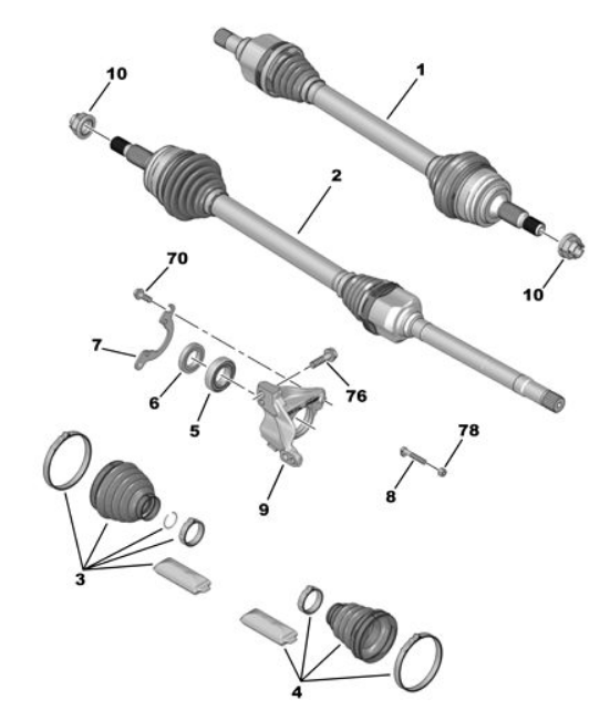

Ok so Driveshafts:
Left (1)
9677914880 (Brand New) £398.33
1610205880 (Exchange) £231.95
Right (2)
9670725580 (Brand New) £398.33
1610205380 (Exchange) £231.95
The above prices are direct from any Peugeot Dealer and include UK VAT.
There is a deposit of £66.96 each on these, refundable on return of the old part.
Any other parts on the diagram you need numbers for, let me know. I'll sort the clutch parts in a new post below.
Ok so Driveshafts:
Left (1)
Right (2)

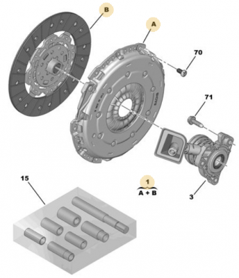

Clutch Kit (1) (Includes 'A' & 'B')
9831386880 (Brand New) £402.10
1612865280 (Exchange) £195.11
Slave Cylinder / Thrust Bearing (3)
9677933380 (Brand New) £161.64
1666659080 (Peugeot Cheaper Alternative) £56.96
Again, VAT inclusive but a £44.64 refundable deposit on the Clutch Kits not included in above prices.

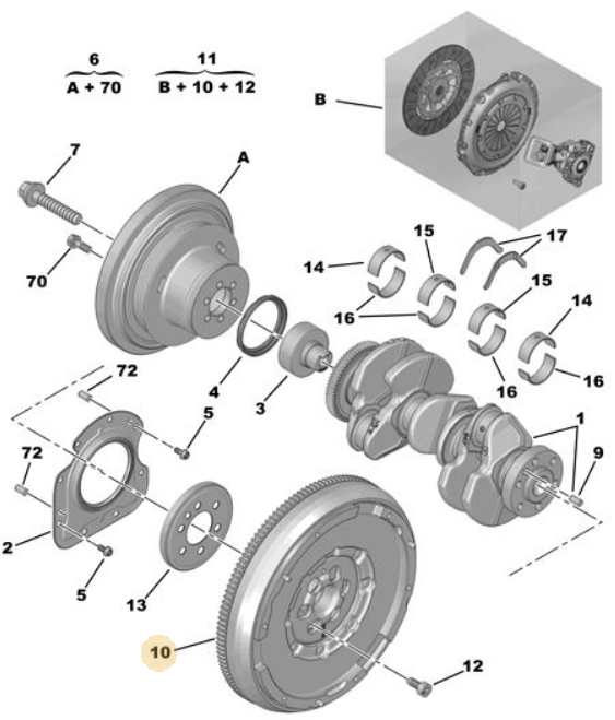

You have not mentioned the Dual Mass Flywheel, which is always recommended to be done if changing the clutch as it rarely outlasts a new clutch, so I've included the part numbers and prices for you just in case.
Dual Mass Flywheel (10)
9806761080 (Brand New) £612.61
1666823480 (Exchange) £342.61
£100.44 Refundable Deposit on these in addition to the above.
