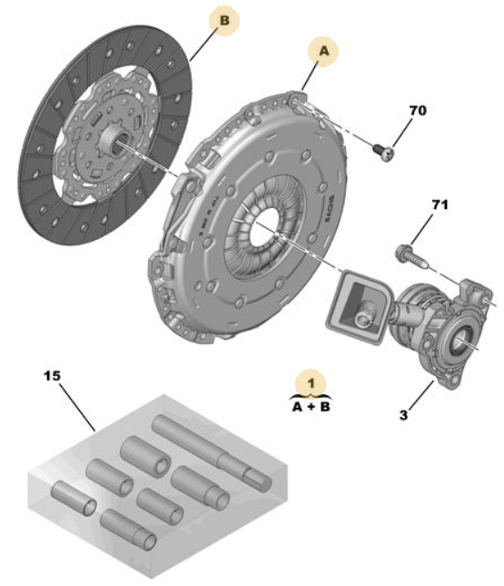

9831386880 (Brand New) £402.10
1612865280 (Exchange) £195.11
Slave Cylinder / Thrust Bearing (3)
9677933380 (Brand New) £161.64
1666659080 (Peugeot Cheaper Alternative) £56.96
Again, VAT inclusive but a £44.64 refundable deposit on the Clutch Kits not included in above prices.
You have not mentioned the Dual Mass Flywheel, which is always recommended to be done if changing the clutch as it rarely outlasts a new clutch, so I've included the part numbers and prices for you just in case.
Dual Mass Flywheel (10)
9806761080 (Brand New) £612.61
1666823480 (Exchange) £342.61
£100.44 Refundable Deposit on these in addition to the above.
