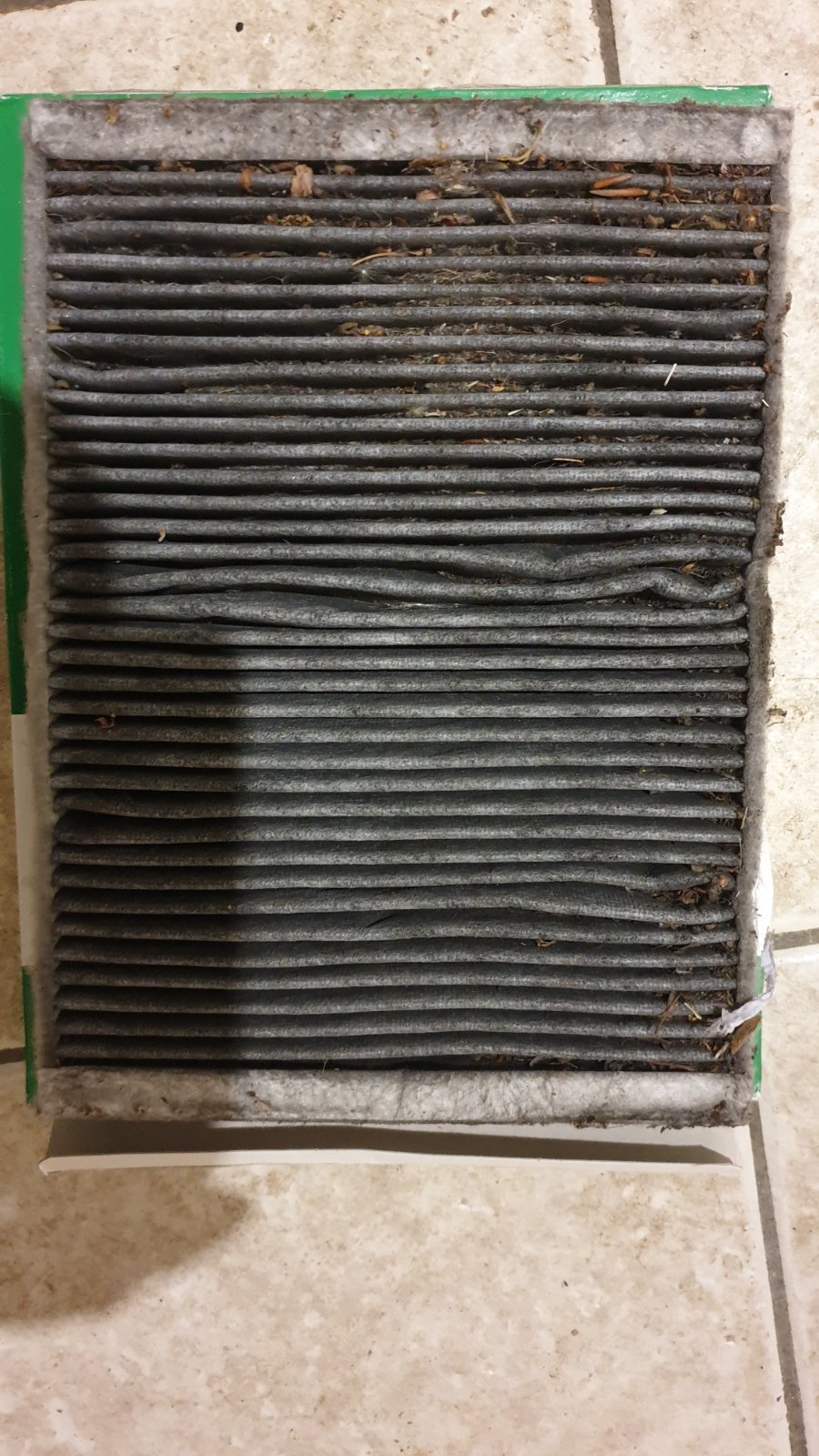

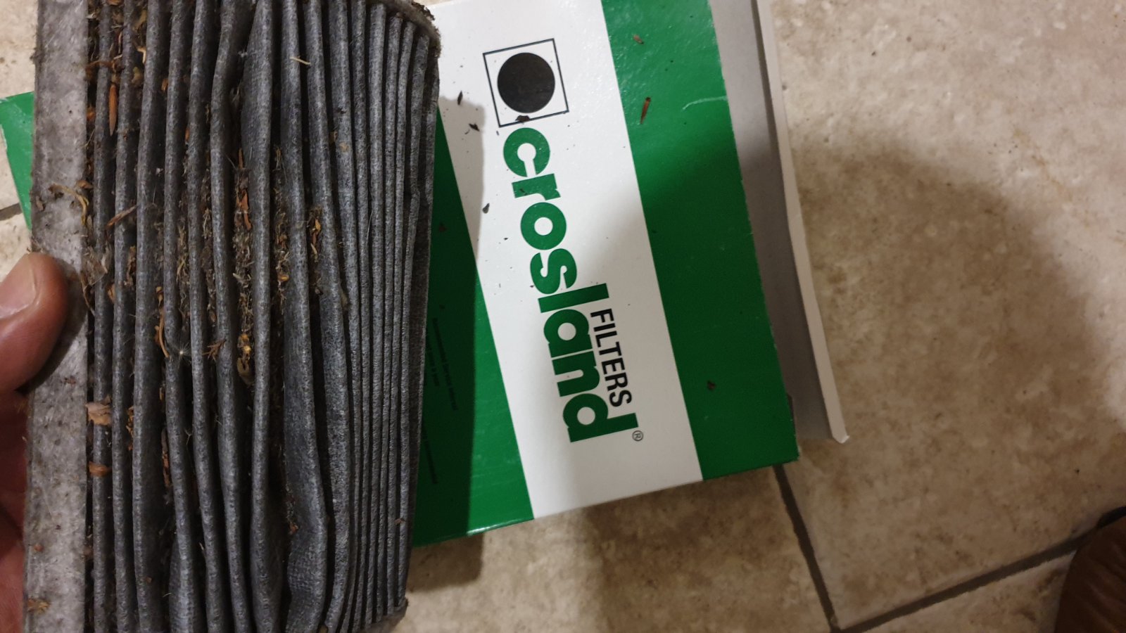

I managed to change the pollen filter successfully without any snaps. Very easy to complete using the guide you provided on here. Thanks ever so much! Took me like 8.5mins as I'd studied the guide properly. I decided to not disinfect cause of reviews about weird (bleach) after-scents. Moreover, I shall be doing Oil Filter tmrw when I get some free time from my little monster 👹. I haven't found Fuel Filter just yet...not sure it has one. But in the meantime, I'm prepping myself mentally for the lambda sensors & brake pads however, awaiting a guide from y'all...please? Purchased some lambda sensor sockets too. I was quoted almost £400 to complete these tasks but I don't see that sort of money coming out from my pockets! No way! Oh wait! Transmission Oil Pressure Switch...what on earth is that? Where does it go? Anyone ever done it? I also found some cables underneath the glove compartment & wondered if they were cut off deliberately or..? Grrr can't add pics.

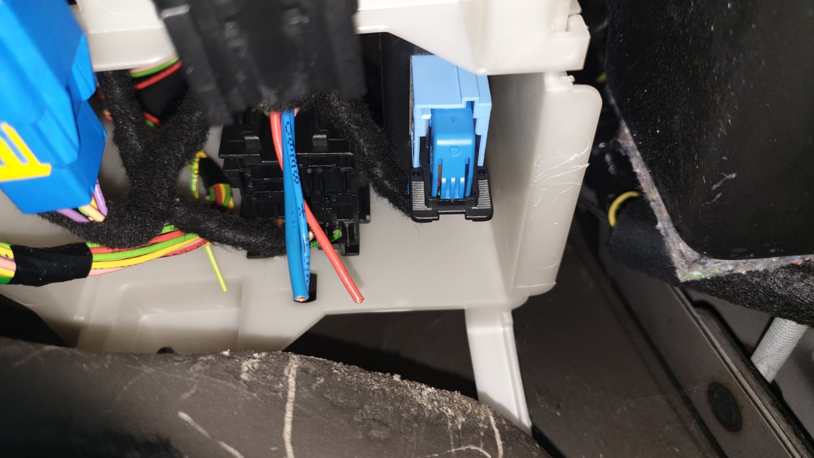

Thanks for that! Here's a pic of the cables. What do you think?

no idea about the cables. I am not an administrator so still do not know your engine.

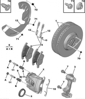

Brake pads: simple if you know what you are doing, in a nutshell (for beginners):
front:
1. loosen wheel nuts, jack up car, support it on axle stands and remove the wheel
2. clean the working area
3. open the brake fluid reservoir
4. remove the metal spring holder (number 10 in above picture)
5. remove the rubber dust caps from the caliper (on the back, A in above picture)
6. if car has sensors connected to the pads, then disconnect them from the loom (remember how the wiring was routed), my car only had the sensor on the passenger side
7. undo the two bolts holding the caliper (number 11, hex type, don't know the size anymore)
8. gently wiggle free the caliper (make sure not to let it dangle using the pipes, use a piece of string or the likes to hold it's weight)
9. remove the old brake pads
10. piston in the caliper needs to be pushed back by using a pushing tool (did not have this until recently, used leverage with a big screw driver on all of my previous cars, mostly Rovers). When you push back the piston, brake fluid will be returned to the reservoir. Keep an eye on the level and make sure it does not overflow.
11. put new pads on either side of the caliper holder (number 3) after having put on a thin coat of copper grease to prevent brake squeel. Do not put grease on the part that touches the brake disc, only put it on the parts that are in contact with the holder and the brake caliper (so the back of the pads)
12. gently put back the caliper and put back bolts number 11 (only tighten a bit)
13. put back sensor wiring and connect to the loom again
14. put back the metal spring holder
15. tighten bolts number 11 to required torque (if you do not have the torque number or a wrench then make sure they are tight)
16. put back the dust caps A
17. put back wheel and lower the car.
18. close the cap of the brake fluid reservoir (making sure fluid level is above minimum, if not ad fluid)
19. sit in car and gently push the brakes. Pedal will go to the floor as piston will be pushed against the new pads. Let go and push again. Repeat till the pedal firms up and it feels like it was before
one side done, other side to go after a cup of coffee (or whatever you fancy)

Re pollen filter OMG! It was gross! You should have seen it! Doubt it's ever been changed 😷.

That is what mine looked like as well when I changed it. Have owned current car only from February and it has been an ongoing project as the car came with some problems.
