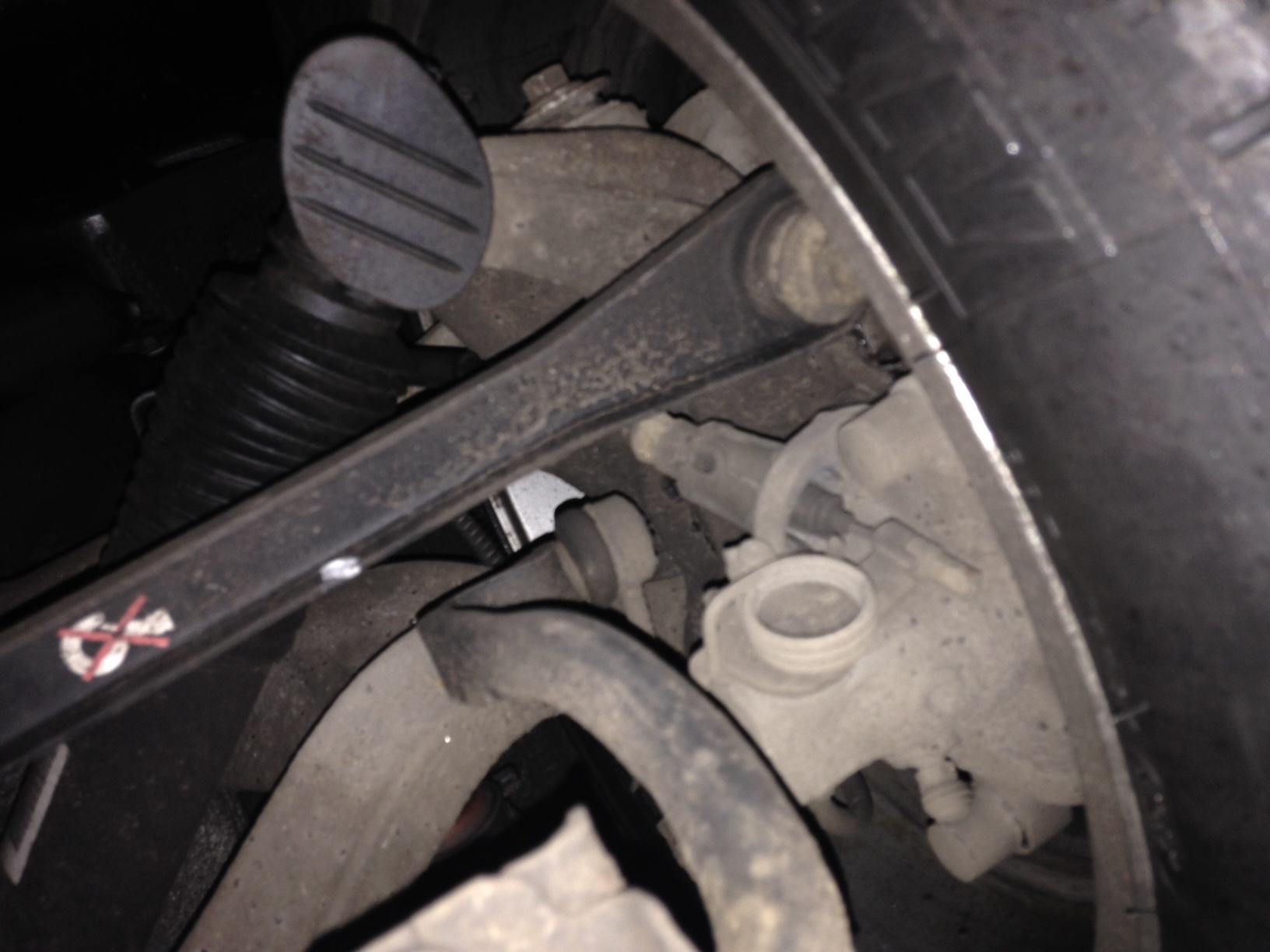

I need to change the rear pads on 2013 c5 tourer with electronic handbrake.
I've managed to deactivate the electronic handbrake by ignition on, foot on foot brake, and flick handbrake switch. Handbrake deactivates until next time I start the car. Guess this is ok.
Did you use diagnostic tool to recalibrate the electronic handbrake or simply use traditional wind back tool?
Thank you in advance for your help.

If it's got cables and a central unit then it is OK just to release it and change the pads. If it's the type with built in motors in the calipers then you need a diag computer to do it.

Thanks for the reply. Indeed it has got cables going to the calliper. See photo attached
I'll give it a shot, thanks again
Alan
PS - here is a photo of the cable going to caliper...not attached a photo before, hope this works.
cable to calliper on 2013 C5 Tourer
PPS - Tourer is fab car...20k miles in the last year....no probs!!!!
