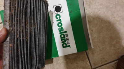

I managed to change the pollen filter successfully without any snaps. Very easy to complete using the guide you provided on here. Thanks ever so much! Took me like 8.5mins as I'd studied the guide properly. I decided to not disinfect cause of reviews about weird (bleach) after-scents. Moreover, I shall be doing Oil Filter tmrw when I get some free time from my little monster . I haven't found Fuel Filter just yet...not sure it has one. But in the meantime, I'm prepping myself mentally for the lambda sensors & brake pads however, awaiting a guide from y'all...please? Purchased some lambda sensor sockets too. I was quoted almost £400 to complete these tasks but I don't see that sort of money coming out from my pockets! No way! Oh wait! Transmission Oil Pressure Switch...what on earth is that? Where does it go? Anyone ever done it? I also found some cables underneath the glove compartment & wondered if they were cut off deliberately or..? Grrr can't add pics.

Re pollen filter OMG! It was gross! You should have seen it! Doubt it's ever been changed .

That is what mine looked like as well when I changed it. Have owned current car only from February and it has been an ongoing project as the car came with some problems.
have fixed most of them now.
