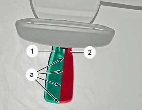

Unclip: The 2 trim cowlings (1), (2) ( as "a") using trim tools.
Detach and remove: The 2 trim cowlings (1), (2).

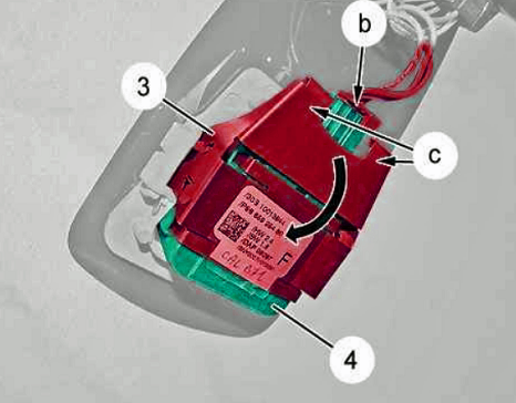

Disconnect the connector ( as "b").
Unclip: The securing clip 3 ( as "c").
Detach:
  • The securing clip 3 (In the direction of the arrow )
  • The rain/sunlight bi-sensor (4)
Remove the rain/sunlight bi-sensor (4).
Caution: Protect the contact cushion of the rain/sunlight bi-sensor
with a transparent adhesive strip; Store the rain/sunlight bi-sensor in an envelope.

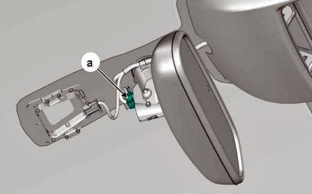

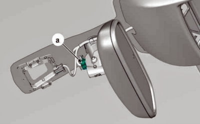

Disconnect the connector ( as "a").

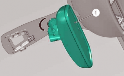

Unclip: The interior mirror (1) (In the direction of the arrow - Anti-clockwise).
Remove: The interior mirror (1).

Re: How to remove the interior rearview mirror on C4 B7?
Have you twisted it anti-clockwise first - it’s locked into place so needs twisting in the direction shown?
It is very clear to me - 9 o'clock to 3 o'clock arrow head is to the right as is the description - anticlockwise - as you are facing the mirror

x 6946
Your having a Specsavers moment. You’re looking at the wrong diagram!
We’re all talking about the last picture in the sequence....
