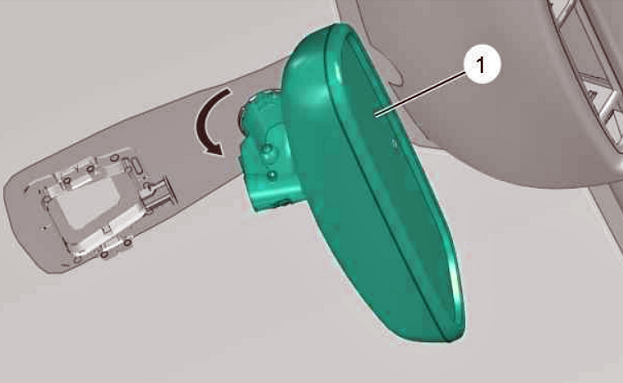

Unclip: The 2 trim cowlings (1), (2) ( as "a") using trim tools. Detach and remove: The 2 trim cowlings (1), (2). |
Disconnect the connector ( as "b"). Unclip: The securing clip 3 ( as "c"). Detach:
Caution: Protect the contact cushion of the rain/sunlight bi-sensor with a transparent adhesive strip; Store the rain/sunlight bi-sensor in an envelope. |
Disconnect the connector ( as "a"). |
Unclip: The interior mirror (1) (In the direction of the arrow - Anti-clockwise). Remove: The interior mirror (1). |

Have you twisted it anti-clockwise first - it’s locked into place so needs twisting in the direction shown?

The arrow shows twisting clockwise. Which is correct?

It is very clear to me - 9 o'clock to 3 o'clock arrow head is to the right as is the description - anticlockwise - as you are facing the mirror

GiveMeABreak wrote: ↑21 Jul 2019, 18:31 It is very clear to me - 9 o'clock to 3 o'clock arrow head is to the right as is the description - anticlockwise - as you are facing the mirror
Have to agree with the above

Have to still disagree. Rotating from 9-o'-clock to 3-o'-clock is very definitely clockwise! But, hey-ho.

Not when it says anticlockwise

But the diagram shows the arrow clockwise.
What am I missing here?Detach: •The securing clip 3 (In the direction of the arrow )

Your having a Specsavers moment. You’re looking at the wrong diagram!
We’re all talking about the last picture in the sequence....

Ah, that was not all clear. I'll get my coat.

Ohhh...
Thanks for that, I'm ashamed to admit, but I thought I was supposed to pull it/twist it downwards towards the rear of the car.
I'll try turning it tomorrow
