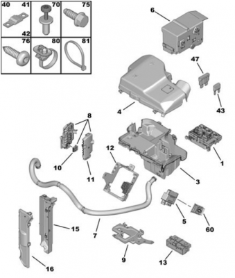

Looking to confirm part no for the fuse box in the engine bay, I have the following number 96 758 779 80
Kenny
Kenny
C3 1.4 petrol (SWMBO)
- x 6961
Re: No heating/Air conditioning - Baffled
You need part: 9807028580 Kenny (Item (1)). £232.19 inc. from Citroen.

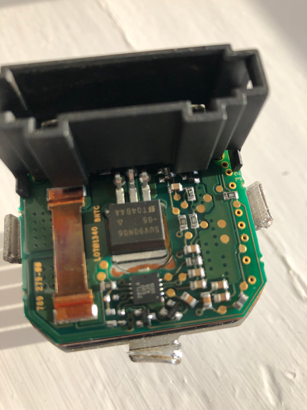

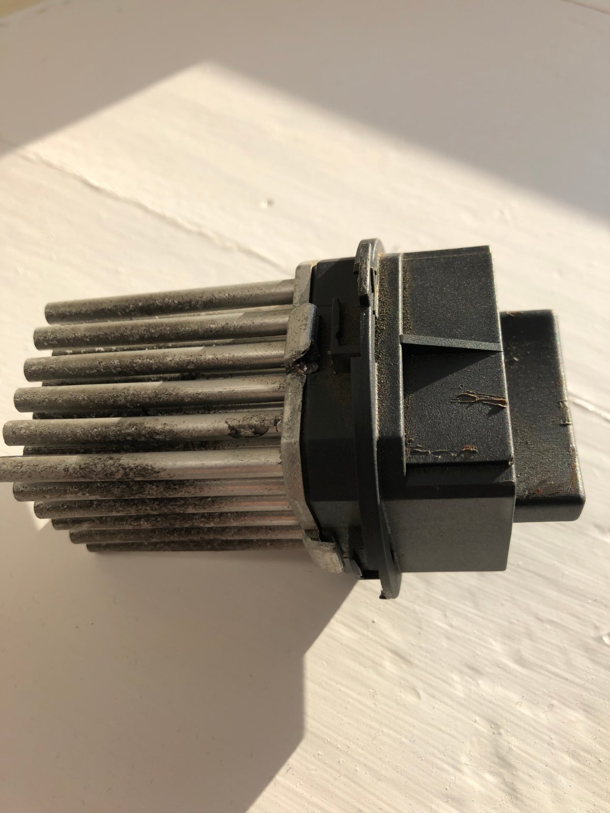

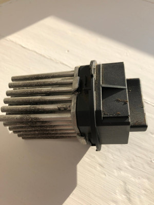

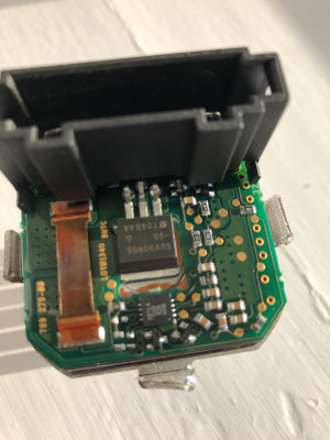

I couldn't read the name properly but that's what came off. I had a look inside and it is a small circuit board inside with lots of very small electronics, nothing obviously wrong.
See Pics
Kenny
See Pics
Kenny

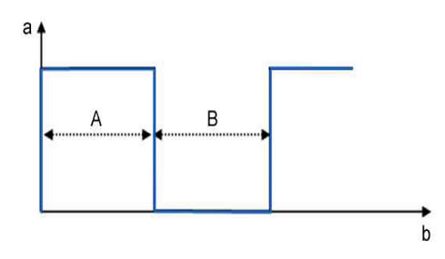

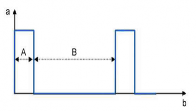

I'm not sure if this will help at all as if you are getting at least some speed then at least a signal is getting through. If there are no fault codes being picked up with the Climate ECU then it won't be in backup mode. The original Blower Control Motor is made by BEHR.
"a" Control voltage.
"b" Time.
"A" Period n° 1.
"B" Period n° 2.
The cyclic ratio is equal to : Period n° 1 divided by period n° 1 plus period n° 2 (Ratio of approximately 10 % in this example ).

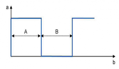

"b" Time.
"A" Period n° 1.
"B" Period n° 2.
The cyclic ratio is equal to : Period n° 1 divided by period n° 1 plus period n° 2 (Ratio of approximately 50 % in this example ).

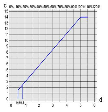

"c" Average air blower motor control voltage.
"d" Reference value received by the digital air blower control module.
The Blower motor is the OCR type and the control voltage works on a scale of 0 to 14.
The value of the cyclic ratio of the control signal makes it possible to define the power requested by the vehicle’s passengers.
"b" Time.
"A" Period n° 1.
"B" Period n° 2.
"b" Time.
"A" Period n° 1.
"B" Period n° 2.

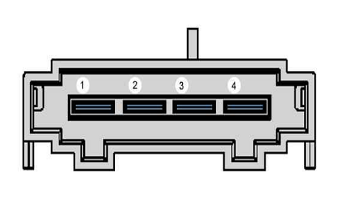

| Allocation of the channels of the black 4 -way connector | |
| Channel No. | Designation |
| 1 | Earth: Digital air blower control module |
| 2 | Air blower motor control |
| 3 | Earth: Air blower motor |
| 4 | Digital control |
