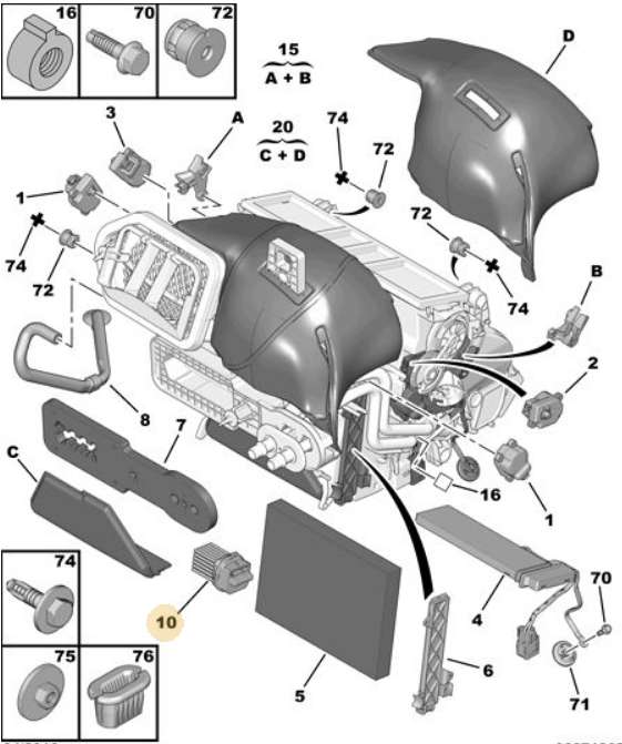

Looking for wiring diagram for heater blower
Is the module part of blower or a separate unit?
Kenny
Kenny
C3 1.4 petrol (SWMBO)
- x 6956
Re: No heating/Air conditioning - Baffled
Separate unit Kenny. I'll put something up in a second - check back here later:
- x 6956
Item (10) is the Blower Control Module:
8045 is the Blower Control Module
8050 is the Blower Motor
8080 is the Climate Control Panel
