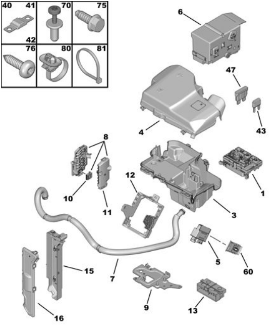

Looking to confirm part no for the fuse box in the engine bay, I have the following number 96 758 779 80
Kenny
C3 1.4 petrol (SWMBO)
x 6945
Re: No heating/Air conditioning - Baffled
You need part: 9807028580 Kenny (Item (1)). £232.19 inc. from Citroen.
