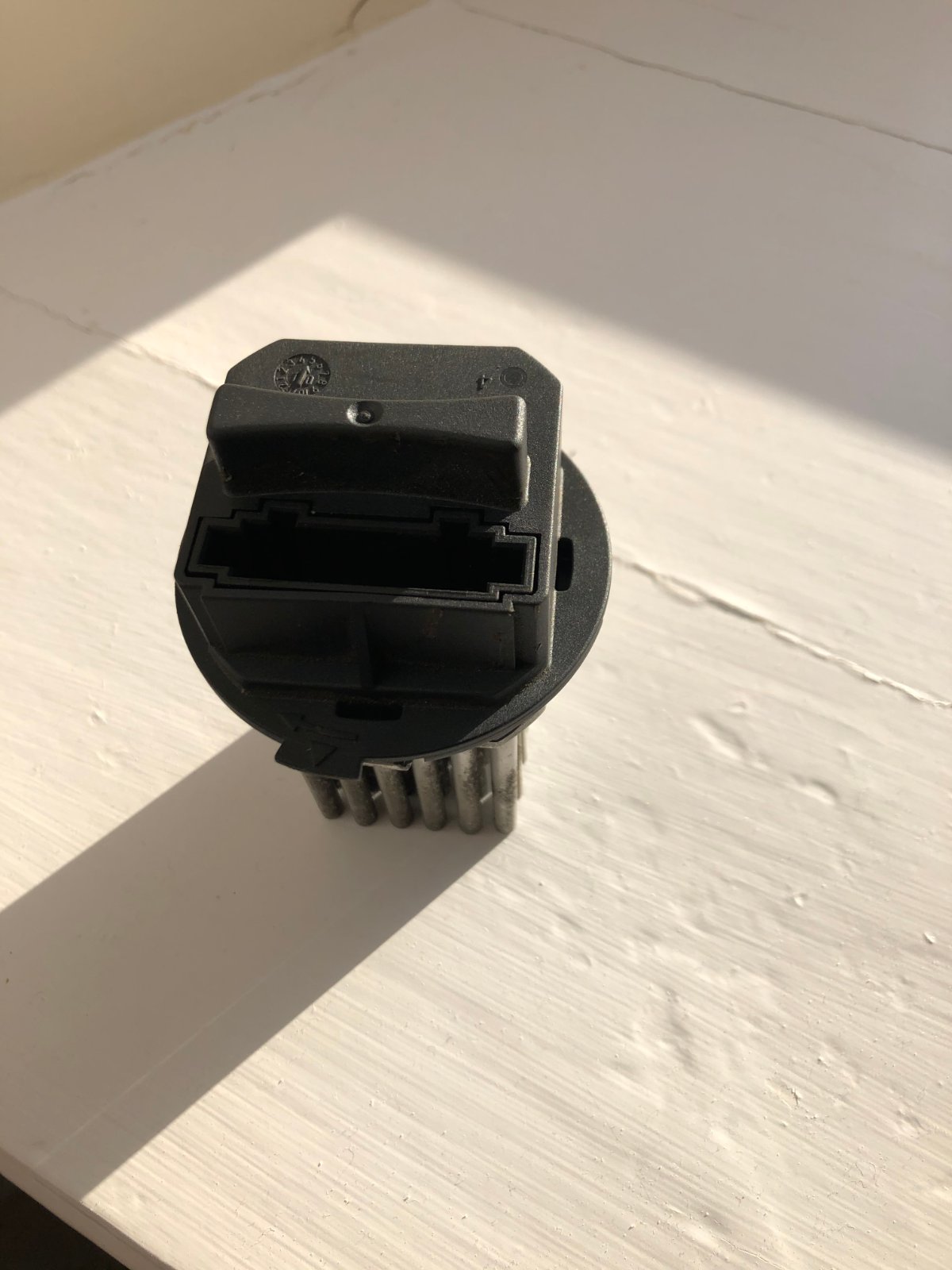

Here's the latest, heating is working but the blower is running at 1 speed only. At least it's clearing the windscreen.
Kenny
Kenny
C3 1.4 petrol (SWMBO)
- x 6956
Re: No heating/Air conditioning - Baffled
Dare I ask what brand / where you got the heater blower control module from Kenny? The fact that it is operating at suggests power, so I would still be suspecting hte blower control unit - these have been know to arrive dead on arrival - and quality of parts is extremely variable, with some (notably from ECP) being the worst.

I couldn't read the name properly but that's what came off. I had a look inside and it is a small circuit board inside with lots of very small electronics, nothing obviously wrong.
See Pics
Kenny
See Pics
Kenny
