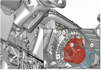

Re: C5 X7 Fan Blower Motor Location
Ignore Steering wheel that's for LHD vehicles, we are blessed with most of this gubbins being on the left hand side!
Disconnect the air blower (12) connector ( as "e").
Press the tongue ( as "c") ; Turn the air blower (12) clockwise to disengage it from its retaining lugs (In the direction of the arrow "d").
Release : The soundproofing under the fascia panel and around the air blower (12).
Remove the air blower (12)

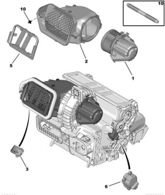

Hopefully this puts it in context: the motor itself is pointing towards the left hand side of the car. Those flat square panels are at the top. The parts (1) & (2) above are the motor extracted from the housing.KingB wrote: 18 Dec 2018, 17:25 Thanks Marc.
Can you please advise on the orientation of the motor please, it’s a bit difficult to make out from the very good picture.
From the side?
Regards,
