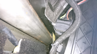

Re: C5 2008 (X7 ?) Turbo Fault
Tried to sort out the blower issue, think i have found it but didn't want to push my luck as it did move a little bit left and right but looking at previous posts it needs to be rotated to the right.
Hopefully this picture is the correct part.
- Posts: 9168
- x 1907
That's it. Don't know why you think it needs to be rotated to the right to unscrew as I have repeatedly said it unscrews anti-clockwise about a quarter turn. It will be very difficult to get moving if it hasn't been out since the car was built
Once it's out though it won't take very long to try the bypass trick and then see if that has (temporarily) fixed things.
admiral51
- (Donor 2026)
- Posts: 2681
- Joined: 24 May 2007, 10:11
- x 394
Thanks for that Paul, i was upside down in the footwell at the time and yes you are correct i got my left and right confused, and i even looked at the pic in the other posts about it and it says turn anti clockwise, at least i found the right part and yes it is held in place well
