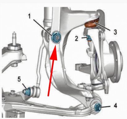

GiveMeABreak wrote: 11 Mar 2019, 21:58 I had a feeling that was coming 😃
Part no: 693684 lower ARB nut. (5)
Part no: 693665 (4)
Already dealt with parts (4) and (5) Richard :-D the Drop bar link - that is number (5)
The issue is with item number one of the pivot support..... That is part of the suspension strut.
The bit is (1) highlighted in Red

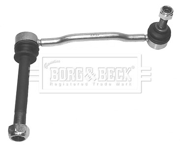

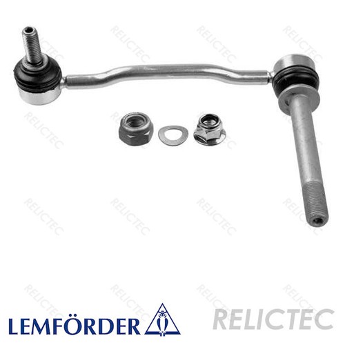

Depending on where you look, the nuts are either special flanged nuts (genuine PSA), or standard nyloc with/without a washer. I have a feeling the genuine ones aren't standard thread, no idea of non-genuine ones though.
eBay - fair use
eBay - fair use

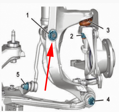

GiveMeABreak wrote: 12 Mar 2019, 15:22
Part no: 693665 (4)
Which is the bit I posted - the bottom of the strut is held to the hub carrier by the top of the drop link (see the pics Bobbins posted with the long bar on the top end of the link), hence the nut (1) is shown on the ARB page.... :roll:

Oh of course, I see it now, apologies Richard, that would explain why there is no separate part and the top of the drop link having a very long screw,
It must be the current topical events causing me to have a Top Hat moment!
