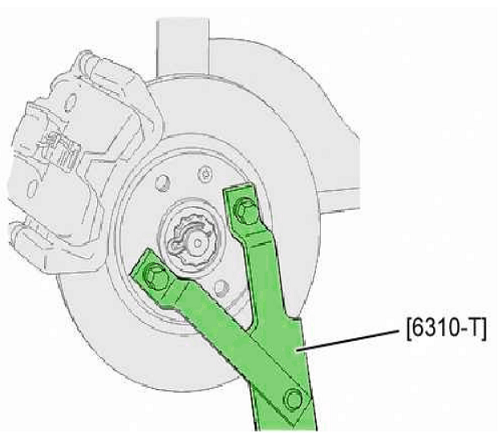

[6310-T] Hub immobilising tool

  • Fit the tool [6310-T]

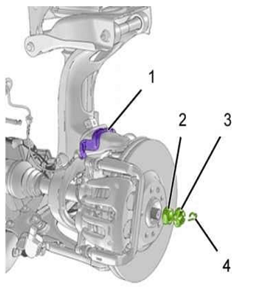

Remove:
  • The pin (4)
  • The steel cage (3)
  • The drive shaft nut (2)
  • The tool [6310-T]
  • The bracket (1)

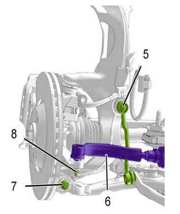

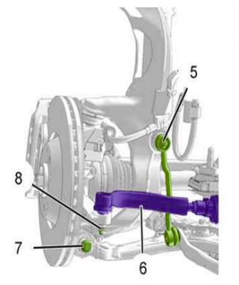

Remove:
  • The anti-roll bar link rod (5)
  • The nut (8)
  • The mountings (7)
  • Uncouple the steering ball joint (6); Using tool [5707-T] or ball joint separator.
L.H. driveshaft
  • Release the LH driveshaft by pivoting the front half-axle upwards.
  • Remove the L.H. driveshaft.

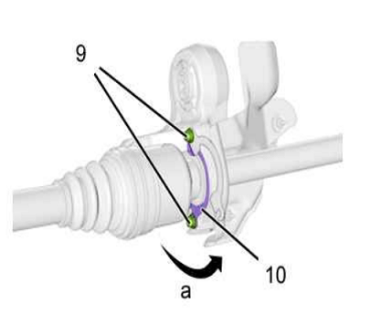

Right hand drive shaft
  • Undo the 2 screws (9) of the RH driveshaft bearing.
  • Move aside the circlip (10) in the direction of the arrow "a".
  • Release the RH driveshaft by pivoting the front half-axle upwards.
  • Remove the right-hand drive shaft.

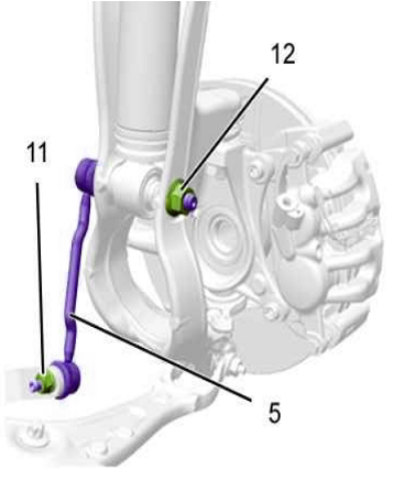

Refitting
Replace the drive shaft seals using the tools [7114-T.X], [7114-T.W], [0332-A], [0332-B], [0346-R], [0346-S].
  • Refit :
  • The drive shafts
  • The bolts (9)
  • The mountings (7)
  • The steering ball joint (6)
  • The nut (8)
  • The nut (11)
  • The nut (12)
  • The bracket (1)
milleplod
