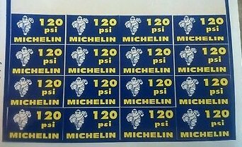

Did think about that.
If printed on some peelable labels, you could always whack one of the small ones on the wheel arch(es), for the duration of the job.
Did initially think of the small one as an alternative to one of the tiny Michelin tyre-pressure stickers once used on trucks and buses...
