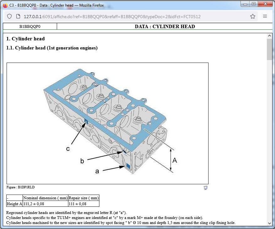

I had a failed head gasket on a C3 1.4 2008. I am trying to figure out if I can save my head or get a reconditioned head. I haven't yet measured the head for straightness as I need to get a straight edge first. However, I did measure the head thickness and it comes out at around 110.9-111.0 mm which suggests that it has already been skimmed once. I can get a reconditioned head and told I need a 2 notch gasket (I think that's a 1.4mm gasket-I may be wrong). But I also have seen 1.6mm gaskets so I am wondering what are they for. I am attaching pictures of the perished gasket I took off as it has 2 notches but I though the notches need to be closer together and one of the notches is some sort of registration.
So my questions are:
1. If my head passes the straightness test what thickness gasket should I use?
2. If It doesn't can it be skimmed any more or is it at the limit of usefulness as the factory specifies 111.0mm to be the minimum head thickness.
Thank you all in advance

I think you are correct that that is a 1 notch gasket.....BUT, see below
I would not trust measurements "done at home" for either warping or thickness, take it to a professional for checking and advice regarding the gasket to use.

I was going to check the warping just to see if it was badly out of true and then take it to the local engine rebuilding workshop. But since then I clean up the corners and measured the head thickness with callipers. On the 4 corners I got 110.5/110.6 and on the other corner 110.7/110.8 so either my callipers are rubbish or it has been skimmed one before but then how did the car work without the valves hitting the cylinder heads with a one notch gasket or there is sufficient clearance. Before I take it to a specialist I want to know what I'm talking about and whether the head is even worth skimming. I though the limit is 111.0mm and you don't skimm after that.

PS I looked at that Eling gasket you posted, it's a 984.136 a 1.27mm thickness. But the 117.831 listed as +0.2mm repair grade is 1.47mm and it has 2 notches similar to what I have but what confuses me are the 3 notches in the middle of the Eling gasket witch are present in both the 1.27mm and the 1.47mm

There are only 2 sizes. 1.2 (stock) and 1.4mm (repair). Plus or minus 0.1mm. So 1.1 to 1.3 stock and 1.3 to 1.5 repair.
This picture explains what the other notches are for.

So to decode the head gasket notches, a 1360 capacity engine will have a notch at "1".
No head gasket should have asbestos, so the "C" notch should always be there.
Looks like ELRINGs' supplier code is a notch at "A" and "B". I would ignore the A and B marks (supplier codes) as they are not really relevant to us.
Stock thickness (1.2mm) has NO notch at "R" but a notch at "R" is 1.4mm (repair) thickness.
Remember, the manufacturers have a 0.1mm tolerance. So ELRINGs 1.27mm stock and 1.47mm repair spec are within limits.

I was confused by the perished gasket I peeled off the engine block (pictures above in initial post) as it only had one notch in the thickness indicator area and I though there should be 2.
I wasn't going to use the old head if I could help it at all. I cleaned it up and measured the thickness of the head. All the values are below 111.0 at around 110.7-110.8 so it deficiently cannot be skimmed any more. I wasn't going to get a brand new head but look for a re-manufactured one that hasn't been skimmed beyond the spec from a specialised engine rebuilding machine shop. Although there are some aftermarket gasket at 1.6mm (AJUSA 10155610) but I'm not sure how safe that would be to skimm my old head even more. Definitely not recommended by Citroen. I suspect that it has gone banana shape since I had a catastrophic failure whilst driving. Loss of power, white smoke out of exhaust and engine cut out. When I had the car towed to my house and I started to take it apart there was very little coolant left to drain so it definitely severely overheated. So first I check it with a straight edge if it passes then I'll take it to a engine rebuilding shop to get a proper test but if it is warped, as seen by a home test, then no point to do anything with it. And maybe no point doing anything with it even if it isn't warped as it been shaved too much.

It could be possible that whatever you are measuring the cylinder head with is not accurate enough?

Hello Ozvtr, I now measured the head with a DIN 862 certified digital calliper. And indeed it is at 110.56mm so my cheap Chinese vernier calliper wasn't that far off. I also managed to get a reconditioned head for 390 EUR from an engine rebuilding specialist and that is about 110.64mm so again under factory specs. But I put a 500mm straight edge on it and it is flat to better that 0.02mm so good enough for flatness. However, if one looks at the French forums people routinely, almost de rigueur, undercut the head to squeeze 1-3 extra horse power. Those who don't want extra power just put a thicker gasket. So I think I will go with the AJUSA 1.6mm gasket. Seems that is common in this part of the world with old cars using TU3JP engines. But I ran into another possible issue. According to factory spec the liners need to protrude 0.03-0.1mm above the deck. I don't have a proper dial gauge with a bridge so I used a straight age and feeler gauges. So across all the liners I do mange to get a 0.03mm gauge under the straight edge and the deck and all the liners are on the same level to better than 0.02mm. But measuring across individual liners only cylinders 1 and 2 lets me get the 0.03mm feeler gauge in while 3 and 4 don't. Cylinder 1 being the one next to the camshaft pulley. So now I'm trying to determine whether it's my method, as it well may be without a proper dial gauge and a bridge, or my liners are indeed low. All the YouTube video I watched people changing head gasket from catastrophically overheated engines with even the valves slamming into the cylinders didn't measure the protrusion so I'm wondering how important that is. I would think it's important as the liners must seal against combustion leaking into the cooling system.
