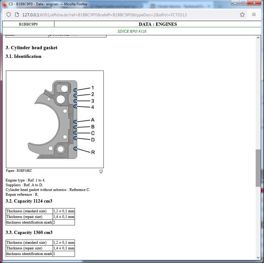

I had a failed head gasket on a C3 1.4 2008. I am trying to figure out if I can save my head or get a reconditioned head. I haven't yet measured the head for straightness as I need to get a straight edge first. However, I did measure the head thickness and it comes out at around 110.9-111.0 mm which suggests that it has already been skimmed once. I can get a reconditioned head and told I need a 2 notch gasket (I think that's a 1.4mm gasket-I may be wrong). But I also have seen 1.6mm gaskets so I am wondering what are they for. I am attaching pictures of the perished gasket I took off as it has 2 notches but I though the notches need to be closer together and one of the notches is some sort of registration.

Re: Head Gasket and head repair
There are only 2 sizes. 1.2 (stock) and 1.4mm (repair). Plus or minus 0.1mm. So 1.1 to 1.3 stock and 1.3 to 1.5 repair.
This picture explains what the other notches are for.
So to decode the head gasket notches, a 1360 capacity engine will have a notch at "1".
No head gasket should have asbestos, so the "C" notch should always be there.
Looks like ELRINGs' supplier code is a notch at "A" and "B". I would ignore the A and B marks (supplier codes) as they are not really relevant to us.
Stock thickness (1.2mm) has NO notch at "R" but a notch at "R" is 1.4mm (repair) thickness.
Remember, the manufacturers have a 0.1mm tolerance. So ELRINGs 1.27mm stock and 1.47mm repair spec are within limits.
