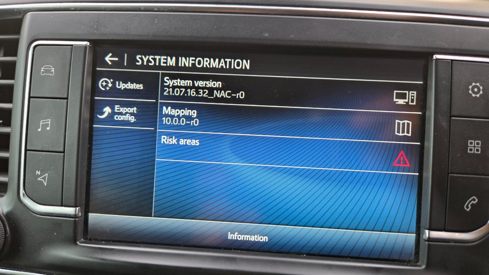

I have a Toyota Proace 2019 model which has this same head unit, currently on system version 21.07.16.32_NAC-r0 can I update this to the latest version Firmware Version 44.07.33.32_NAC-r0 ?

vmguru wrote: 24 May 2025, 19:43 I have a Toyota Proace 2019 model which has this same head unit, currently on system version 21.07.16.32_NAC-r0 can I update this to the latest version Firmware Version 44.07.33.32_NAC-r0 ?
No, you have a NAC Wave 2 hardware, you can't install a firmware for a NAC Wave 4 hardware revision.
But you can install the 21.08.90.52_NAC-r0 version, the latest for that system.

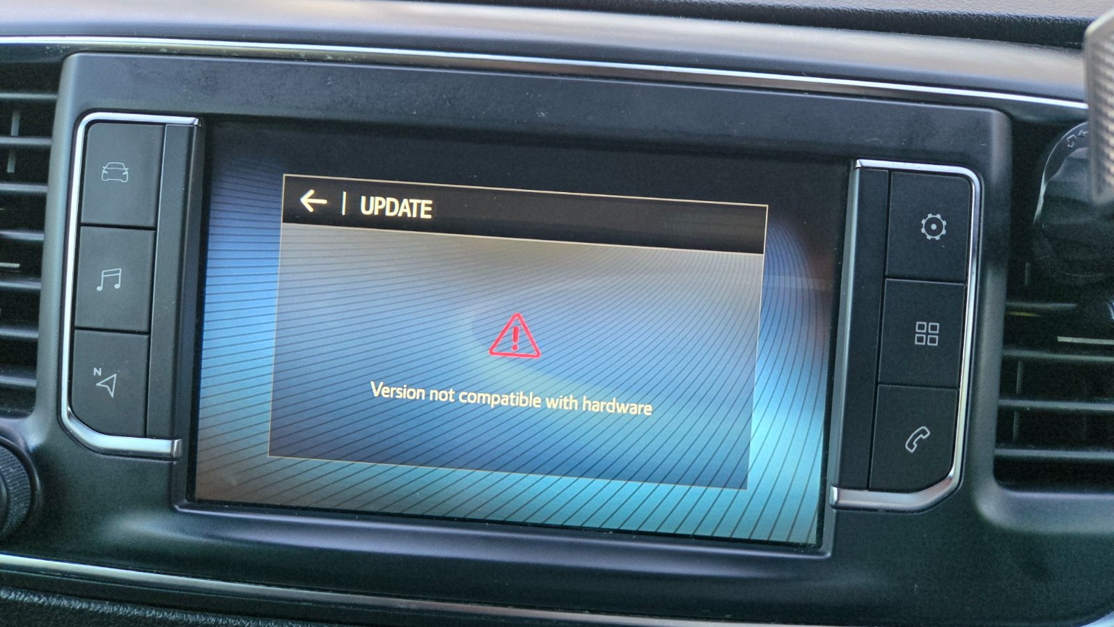

Thanks, I am trying to update this now with Waves 2 version 21.08.90.52_NAC-r0. I have created a license file from the Toyota website. These units are exactly the same as the Peugeot Citroen units.
I am getting "Version not compatible with hardware" error message at the not sure what is causing this as I have the correct firmware and licence file on the USB memory stick.

Hi all,
I also have the "version incompatible with hardware". The Citroen update program says "PSA_ovip-int-firmware-version_42-03-33-42_NAC-r0_NAC_EUR_WAVE3" is the most recent update I need. My car has now version 30-05-50-42_NAC-r0_NAC_EUR_WAVE3. My VIN is VF7**************[VIN obfuscated, can be read by forum staff]. Please has anyone a suggestion?
Best regards,

Both of you have a NAC Wave 3 infotainment system (firmware version 3x.xx.xx.xx), which is impossible to update at this moment (and in the last 6 months or so). This is not related to the license, but to the signing certificates (included in the firmware) that are expired/too old. Only PSA/Stellantis could fix this by issuing new certificates, signing their update with them (the private key), and releasing a new .tar file.
