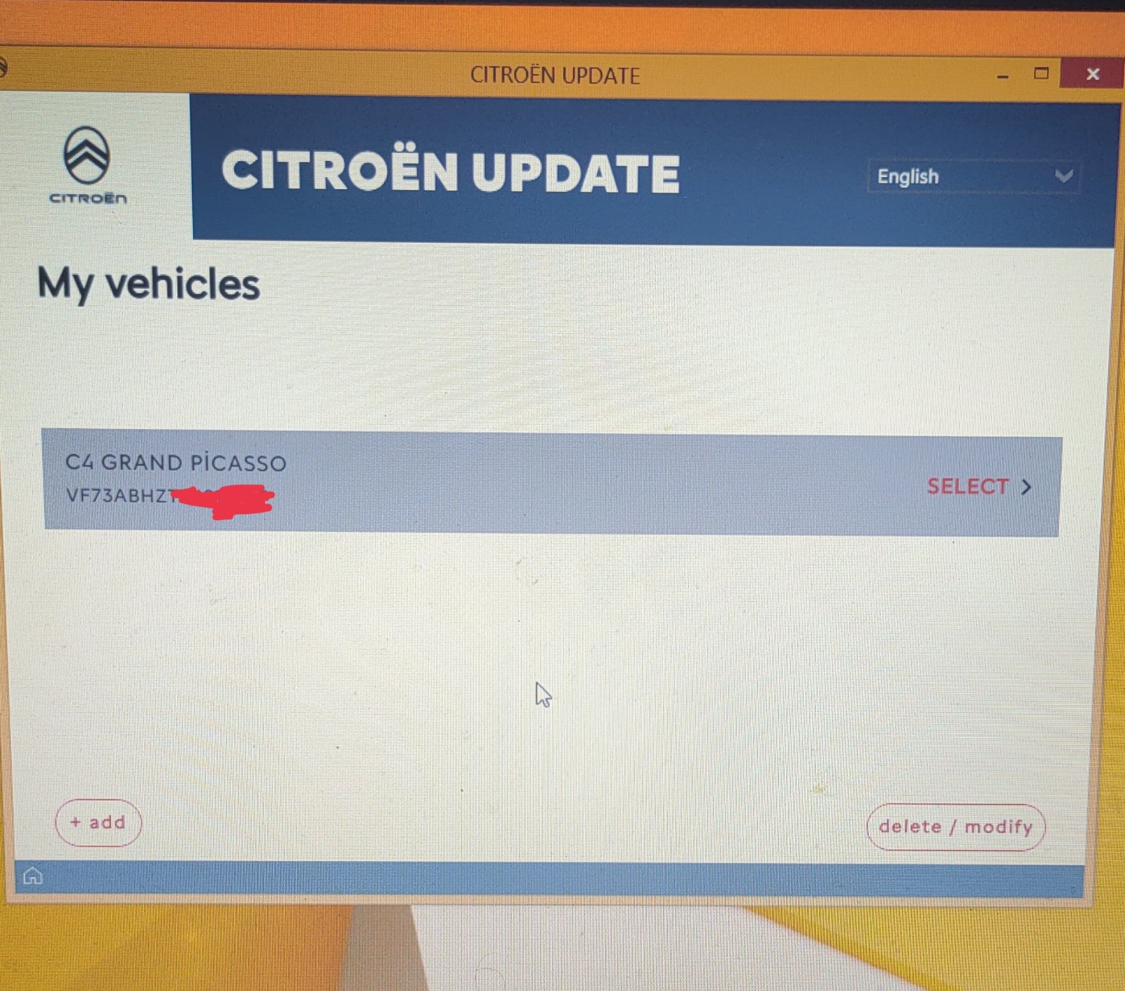

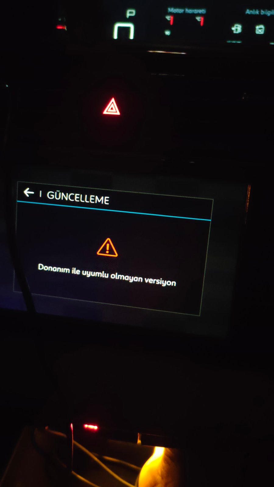

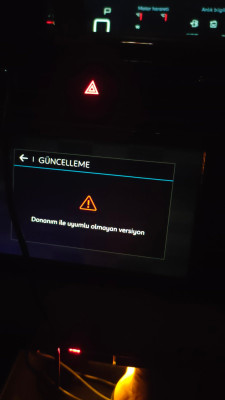

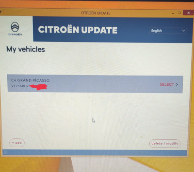

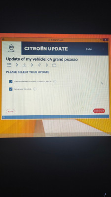

I am trying to update my C4 Grand Picasso 2016 Intensive but I am getting the error "version not compatible with hardware". can you help me fix this error?
VIN NUMBER: VF7**************[VIN obfuscated, can be read by forum staff]

Re: PSA NAC RCC Updates
You can try and manually update, but there are issues with the certificate signing on this firmware, so may not install. If it won't install, you'll have to contact Citroen and complain - they will need to update the digital certificate dates and re-sign them before they'll install. This is because the certificates for the firmware may have expired (too long in updating since the firmware release - which was February 2021 when this was released).
21.08.87.32_NAC-r1 Firmware
You have on-board WiFi, but here is the licence file in case that is not working in Turkey - make sure you follow the notes in the last link to correctly name the licence folder!
Alixxx Licence File
Europe Map Version 28
Instructions for Updating NAC or RCC Firmware, Maps & Licences
Alixxx Licence File
