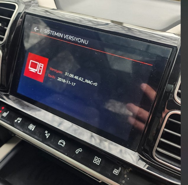

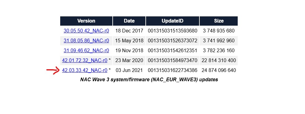

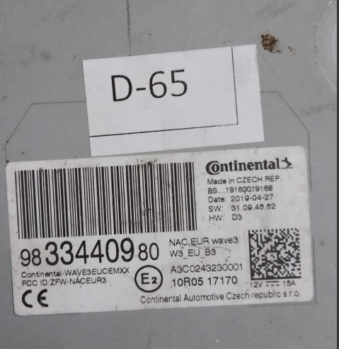

first of all hello dears,my car is citroen c5 aircross last month i changed my RCC to NAC WAVE3 so I can't update to the latest version of WAVE3 well I tried using the My Citroen app but I keep getting the error 'not compatible with the hardware'
Can you help me with on this issue ? thanks advance.
MY VIN IS : VR7**************[VIN obfuscated, can be read by forum staff]
myNAC wave3 information like is below
current version of my nac wave3
The version I want to update is as follows (remarked with red)
