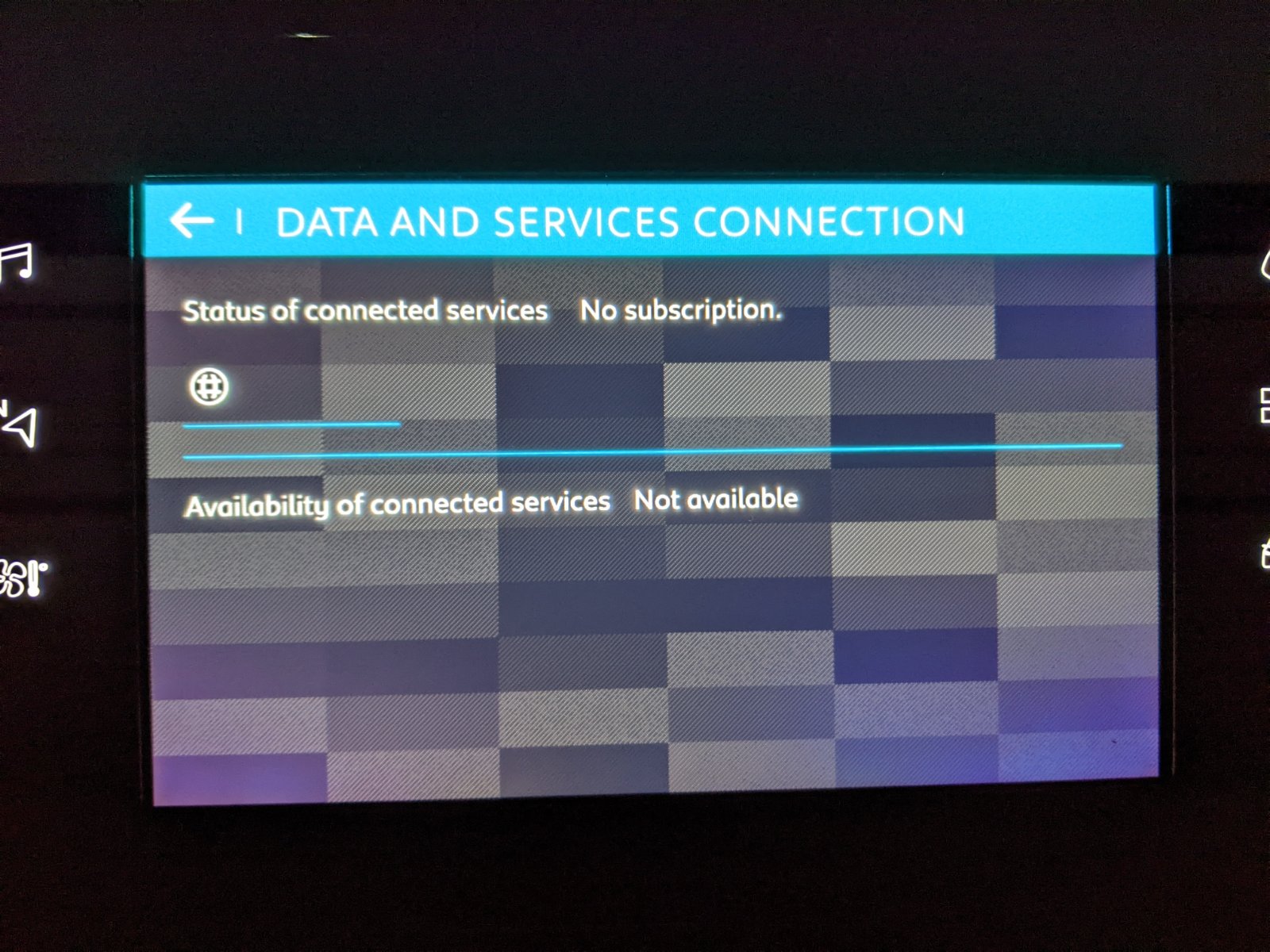

It may be of interest that I found a page with availability of connected services but it says "Not available" (see attachment)

Ok so the first option is just telling you that there is no subscription for 'Live Connected Services', but that won't prevent system or map updates.
If the green LED comes on for a few seconds then goes off, the telematic unit is working correctly. I'm not sure what else to suggest, short of telling the dealer it won't update, with the error message, despite having followed all the guidance.
