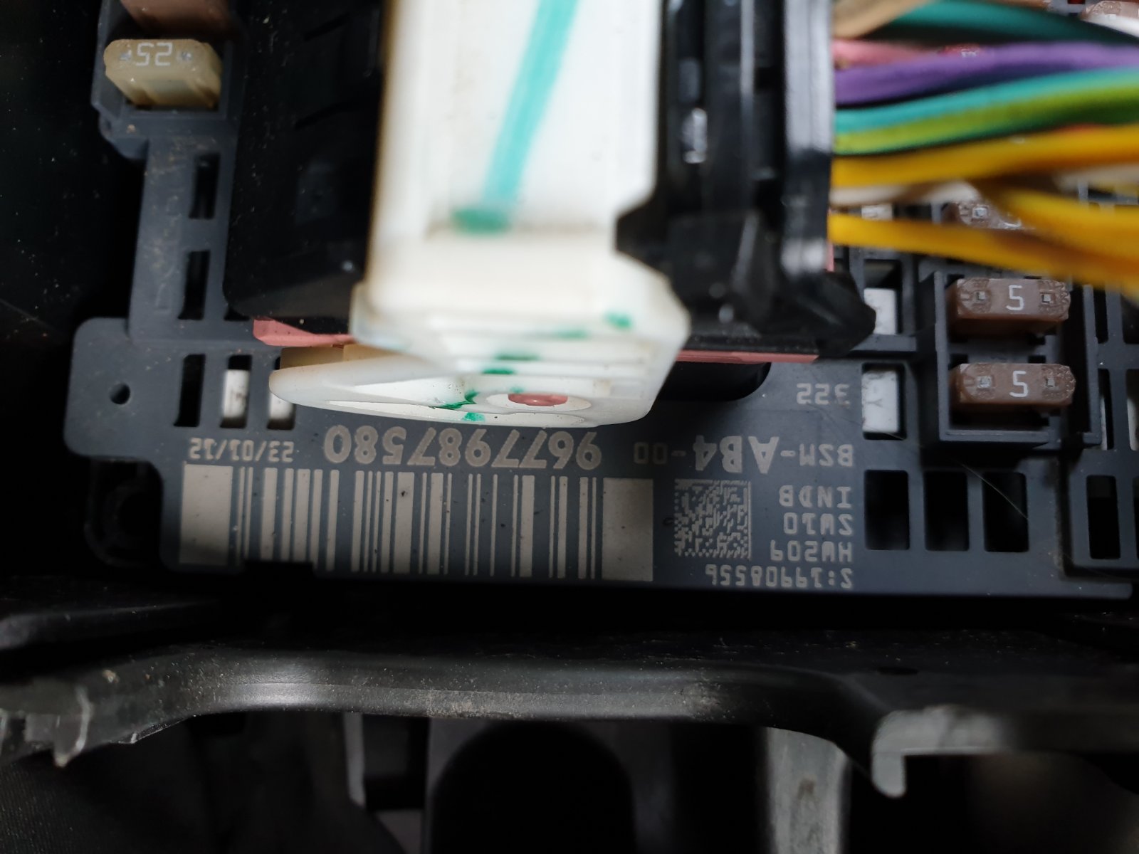

I opened the panel inside to glove box & can't see BFH3 Fusebox (Cabin Fusebox).
The only panel I can see is A2C53383165 BSI (photo below need to rotate it 180).
Do I need to remove the whole glove box?

x 6955
Re: DS5 Fuse Allocation for Glove Box
Yes, where the BSI is. There are several small fuse compartments that surround the BSI. I know it is cramped there but you need to be careful too. Look to the sides, below and above, but it will be marked and will be there.
The additional fuse box may be covered as in the diagram above, with the cover as (2)
