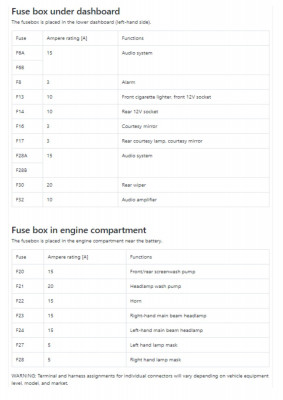

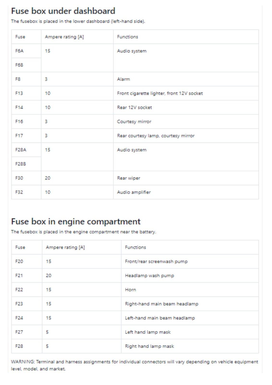

Hi All,
I've attached a list of fuse allocations for the fuses in the glovebox.
It isn't complete but I thought it might be useful & handy, also if anyone out there knows the missing fuses, please let me know and I can update.

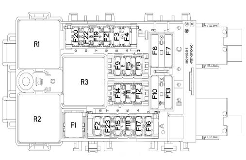

Re: DS5 Fuse Allocation for Glove Box

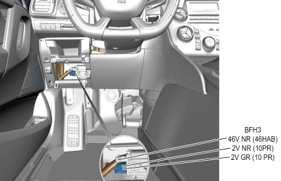

Right:
BFH3 Fusebox (Cabin Fusebox)
Click Images to Zoom F9: Front Heated Seats
F10: Passenger seat motors + switches
F13: Driver's Seat Memorisation Control Unit - Driver's Massage Control Unit

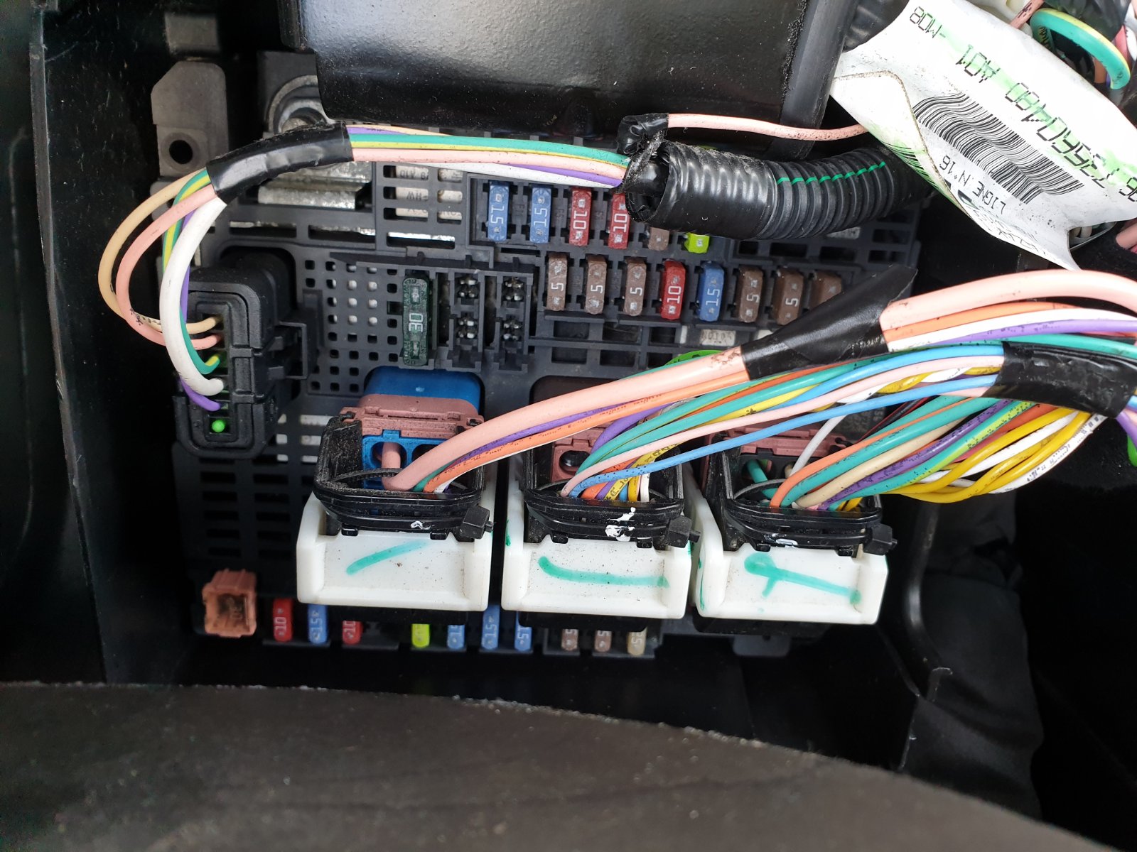

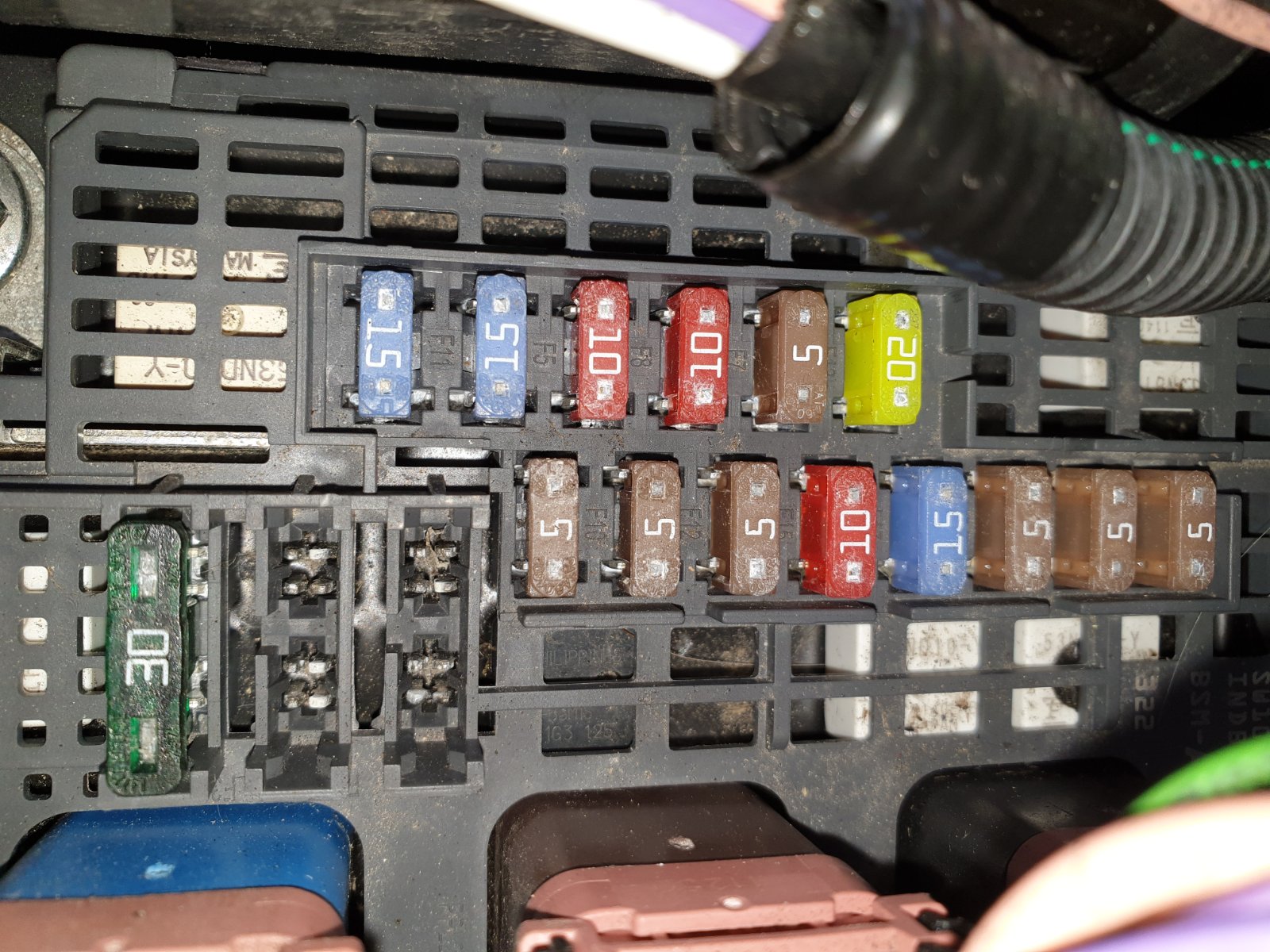

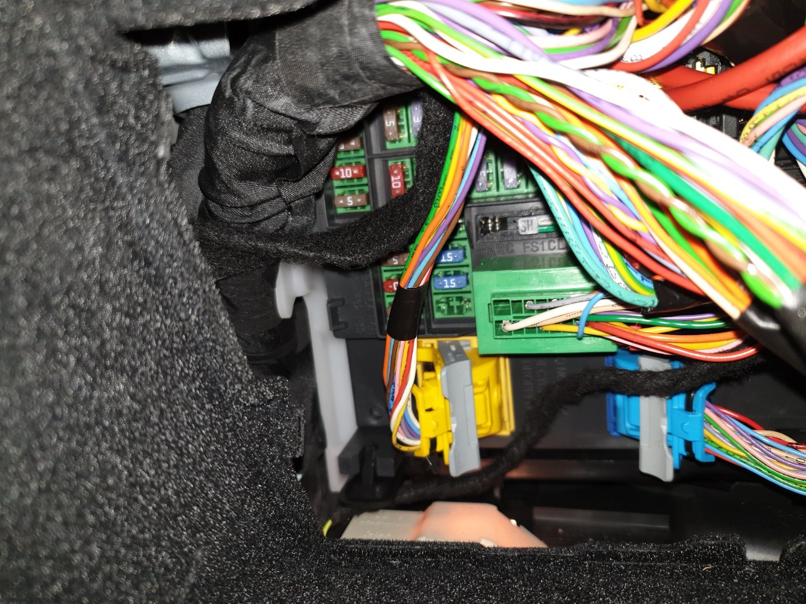

Hi Marc,
Managed to have a look today at the fuse box in the engine compartment.
Unfortunately to me it looks nothing like the one you sent me.
I've attached some photos of it. Regards
nayan2217
nayan2217

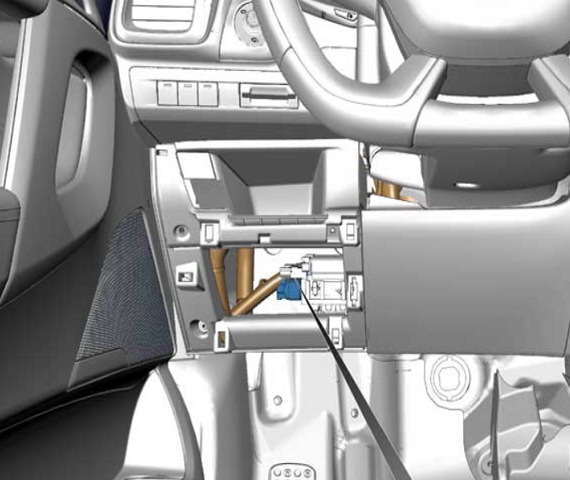

- x 6947
Ok, so that's because the diagram I sent you is not for the engine fuse box.
This picture shows Left Hand Drive, so will be in the passenger glovebox in a RHD:
The diagram I sent you is for one of the inside cabin fuseboxes.

Hi Marc,
I opened the panel inside to glove box & can't see BFH3 Fusebox (Cabin Fusebox).
The only panel I can see is A2C53383165 BSI (photo below need to rotate it 180).
Do I need to remove the whole glove box?

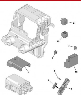

- x 6947
Yes, where the BSI is. There are several small fuse compartments that surround the BSI. I know it is cramped there but you need to be careful too. Look to the sides, below and above, but it will be marked and will be there.
The additional fuse box may be covered as in the diagram above, with the cover as (2)
