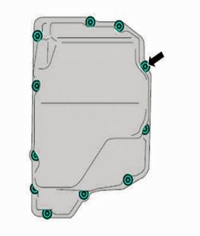

| Remove: The protective panel under the engine The top-up plug (2) using a TORX socket wrench The oil overflow and drainage plug (1) using a 6 -sided wrench Note: Approximately 3 litres of oil should flow out. |

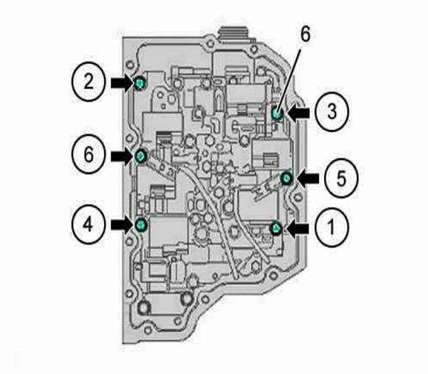

| Remove the 6 bolts (6) (In the order from 1 to 6). | CAUTION: Handle the hydraulic block with care and protect it against any source of contamination. CAUTION: Keep in place the manual valve of the hydraulic valve block.[/b] Remove the hydraulic block housing, disengaging the rod (7). |
| (8) Torque converter bypass pressure modulation solenoid valve . (9) Clutch pressure modulation solenoid valve "C3". (10) Brake pressure modulation solenoid valve "B1". (11) "S1" sequential solenoid valve. (12) "S2" sequential solenoid valve. (13) Line pressure modulation solenoid valve. (14) Clutch pressure modulation solenoid valve "C2". (15) Clutch pressure modulation solenoid valve "C1". |

| Refit the hydraulic block, engaging rod (7) in the selector lever. CAUTION: Do not pinch the electrical harnesses of the speed sensors. Refit:

- Clean and degrease the seal faces of the casings in order to obtain surfaces that are dry and free of traces of sealing paste.
- Apply a strip of Loctite 5910 - Quik Gasket sealing paste on the gearbox casing.
- The hydraulic block casing
- The 11 hydraulic block housing fixing bolts
