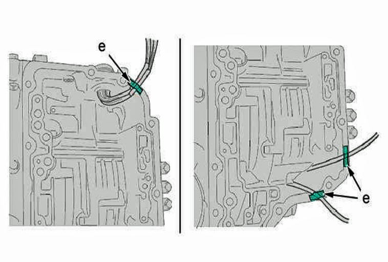

| Detach the 2 connectors from the speed sensors (at "d") using a thin screwdriver. | N.B.: The oil temperature sensor (3) is integral with the electrical harness. Remove:
| Retain the electrical harnesses on the box casing (at "e") using pieces of adhesive tape. | Remove:

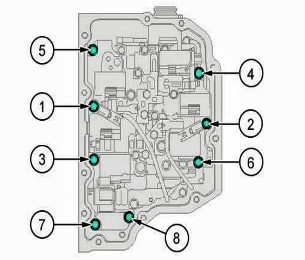

| Remove the 6 bolts (6) (In the order from 1 to 6). | CAUTION: Handle the hydraulic block with care and protect it against any source of contamination. CAUTION: Keep in place the manual valve of the hydraulic valve block.[/b] Remove the hydraulic block housing, disengaging the rod (7). |
| (8) Torque converter bypass pressure modulation solenoid valve . (9) Clutch pressure modulation solenoid valve "C3". (10) Brake pressure modulation solenoid valve "B1". (11) "S1" sequential solenoid valve. (12) "S2" sequential solenoid valve. (13) Line pressure modulation solenoid valve. (14) Clutch pressure modulation solenoid valve "C2". (15) Clutch pressure modulation solenoid valve "C1". |
