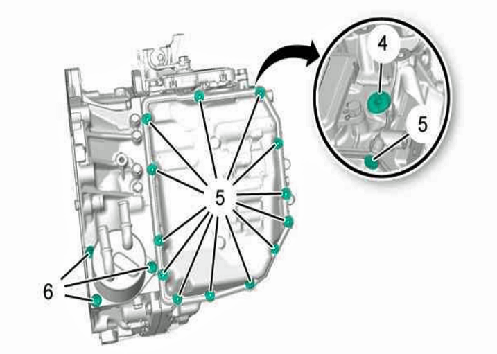

AM6 Drain Procedure
Recommended Tool
| Topping up Cylinder |
| Remove: The protective panel under the engine The top-up plug (2) using a TORX socket wrench The oil overflow and drainage plug (1) using a 6 -sided wrench Note: Approximately 3 litres of oil should flow out. |

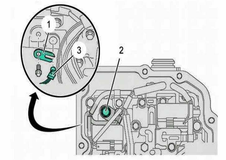

| Unplug:
| Detach the 2 connectors from the speed sensors (at "d") using a thin screwdriver. | N.B.: The oil temperature sensor (3) is integral with the electrical harness. Remove:
| Retain the electrical harnesses on the box casing (at "e") using pieces of adhesive tape. | Remove:

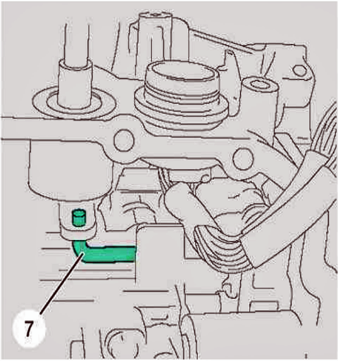

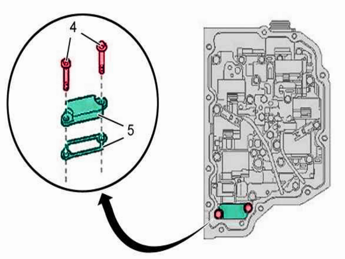

| Remove the 6 bolts (6) (In the order from 1 to 6). | CAUTION: Handle the hydraulic block with care and protect it against any source of contamination. CAUTION: Keep in place the manual valve of the hydraulic valve block.[/b] Remove the hydraulic block housing, disengaging the rod (7). |

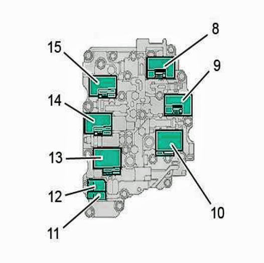

| (8) Torque converter bypass pressure modulation solenoid valve . (9) Clutch pressure modulation solenoid valve "C3". (10) Brake pressure modulation solenoid valve "B1". (11) "S1" sequential solenoid valve. (12) "S2" sequential solenoid valve. (13) Line pressure modulation solenoid valve. (14) Clutch pressure modulation solenoid valve "C2". (15) Clutch pressure modulation solenoid valve "C1". |
Note! Tightening Torques below are specific to the generation of the AM6 fitted to the 407. Check the Oil cooler shape to determine which you have fitted and use the appropriate table:
Tightening Torques
| All AM6 Versions Except 3rd Generation | 3rd Generation AM6 only | ||||||||||||||||||||||||
| Refit the hydraulic block, engaging rod (7) in the selector lever. CAUTION: Do not pinch the electrical harnesses of the speed sensors. Refit:

Refilling the AM6
Refit:

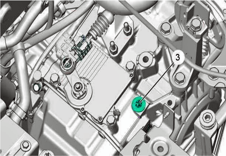

- The oil overflow and drainage plug (1) (equipped with a new seal)
- The top-up plug (2) using a TORX socket wrench
Remove:
Dry gearbox oil capacity: 7 litres (approx.).
Type of oil (Red):
- EURO 5 engine: AW-1 oil
- EURO 4 engine: JWS 3309 ESSO oil
Quantity of oil to be replaced: 3 litres (approx.).
Refit the filler plug (3) (equipped with a new seal).
Initialise the used oil counter (follow the diagnostic tool procedure).
