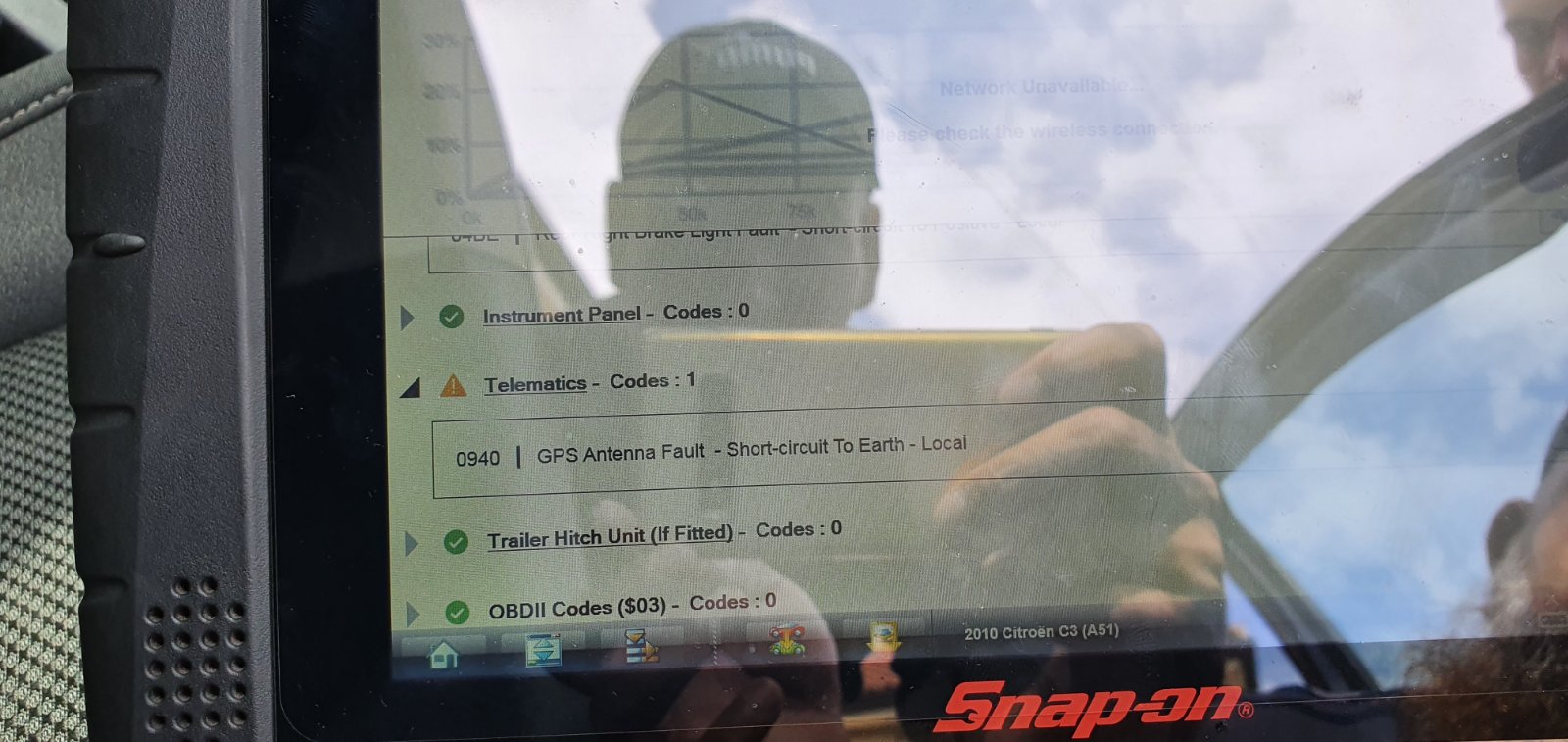

my neice bought a Citroen c3 2011 Connexion 1.4 hdi couple years ago, after couple couple of months the car developed an issue with the radio rebooting randomly, we took car to the local citroen dealership for diagnostic, they said the car needs firmware update, which we carried out but that didn't fix the issue, we tried the BSI to no avail.
couple of days ago, we had a low fap/dpf additive message pop on the screen with the service icon. I had the car diagnosed by mobile ime diagnostic guy local to me again and to reset the additive counter after installing a new additive pouch. he failed to clear the code and j have to take the car into the dealership on the 19th july to reset the counter
The diagnostic come back with a fault code of 0940 GPS antenna fault shortcircuit to Earth local.
I assume that means there a loose earth connection but I'm not sure weather thats back of the radio or the aerial on the roof.

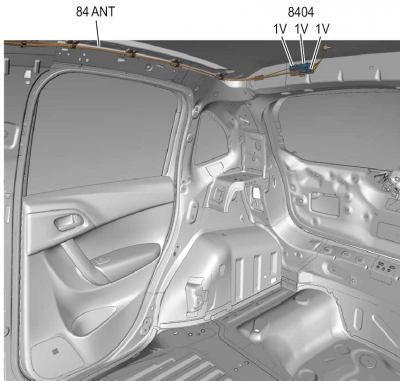

You have the RNEG (MyWay) telematics system installed.
The aerial runs from the aerial base across to the top back of the tailgate and from there, down the driver's side back to the the dashboard and to t he head unit:
Unfortunately 0940 is not a recognised PSA code, so is probably one generated by his diagnostic tool, so I can't help you with that one.

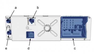

The issue is likely to be somewhere in the previous diagram I put up - as there may be a connection issue or water ingress there. There are no earths at the back of the unit for the aerials as these are simple aerial plugs. But it won't hurt to check that the aerial is not loose of course.
"a" Aerial FM2 (not used).
"b" GPS aerial .
"c" 3-part connector.
"d" LVDS cable connector.
"e" Aerial FM1/AM.

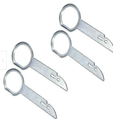

You'll need a set of this type of key:
Link here:
https://www.ebay.co.uk/itm/373608989377 ... %3A2334524

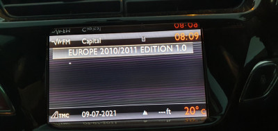

update, attached the arieal, picked up 6 satellites, so I guess its the aerial hoping it's losse connection, the unt did reset before I set off, I read sometimes the sd card can be corrupted and that causes reboot of the system or its heat issue but I don't mines suffering from heat isues.
