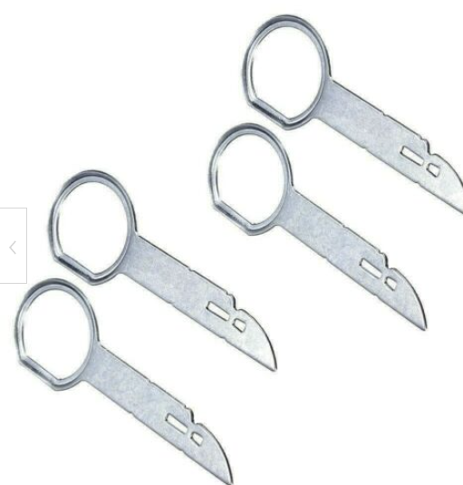

You'll need a set of this type of key:
Link here:
https://www.ebay.co.uk/itm/373608989377 ... %3A2334524
Link here:

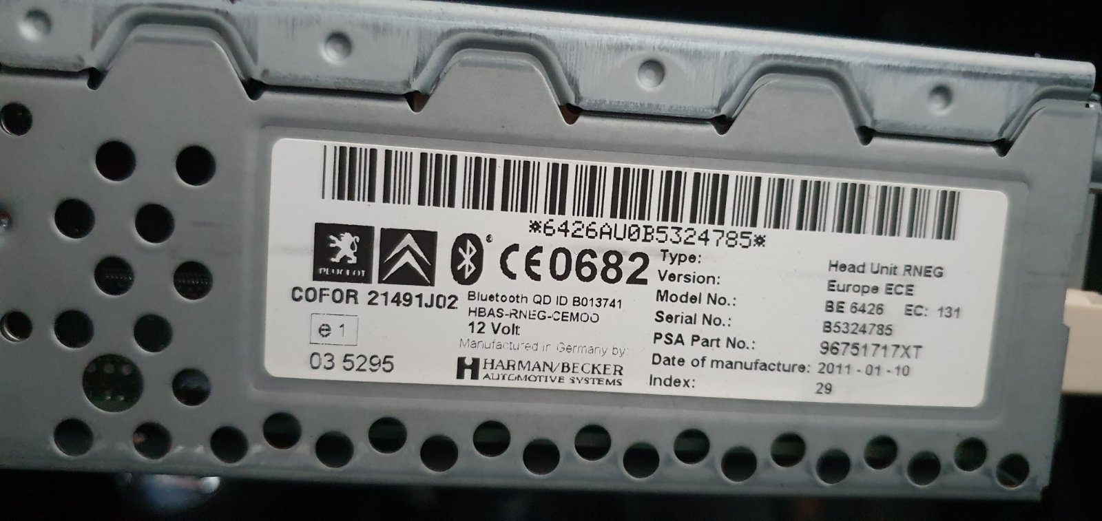

update: manged to get the key tool, took the radio out and had a look at the aerial connector took it out and inserted back in, connection was secure, here are some photos of the radio model, firmware version and map version, I set the date and time and GPS syn was grey out, I also checked how many satellite it picked up, it picked up 0.
I'm going to try a BSI reset in the morning, i think i did it wrong last time.
