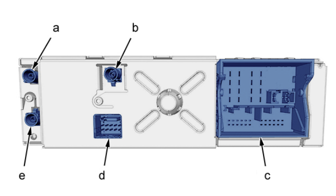

The issue is likely to be somewhere in the previous diagram I put up - as there may be a connection issue or water ingress there. There are no earths at the back of the unit for the aerials as these are simple aerial plugs. But it won't hurt to check that the aerial is not loose of course.
"a" Aerial FM2 (not used).
"b" GPS aerial .
"c" 3-part connector.
"d" LVDS cable connector.
"e" Aerial FM1/AM.
You'll need a set of this type of key:
Link here:
https://www.ebay.co.uk/itm/373608989377 ... %3A2334524

update: manged to get the key tool, took the radio out and had a look at the aerial connector took it out and inserted back in, connection was secure, here are some photos of the radio model, firmware version and map version, I set the date and time and GPS syn was grey out, I also checked how many satellite it picked up, it picked up 0.

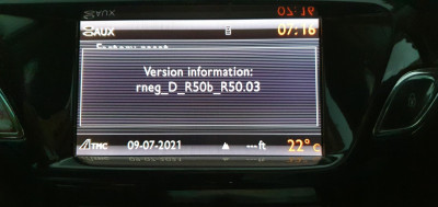

Remember you will not get an instant fix on satellites once the system antenna has been removed. It takes at least 10 minutes of actual driving (not standing still with engine running) for the system to get a fix on available satellites.
1) Firmware: You have the latest and last available version that was ever released for this system.
