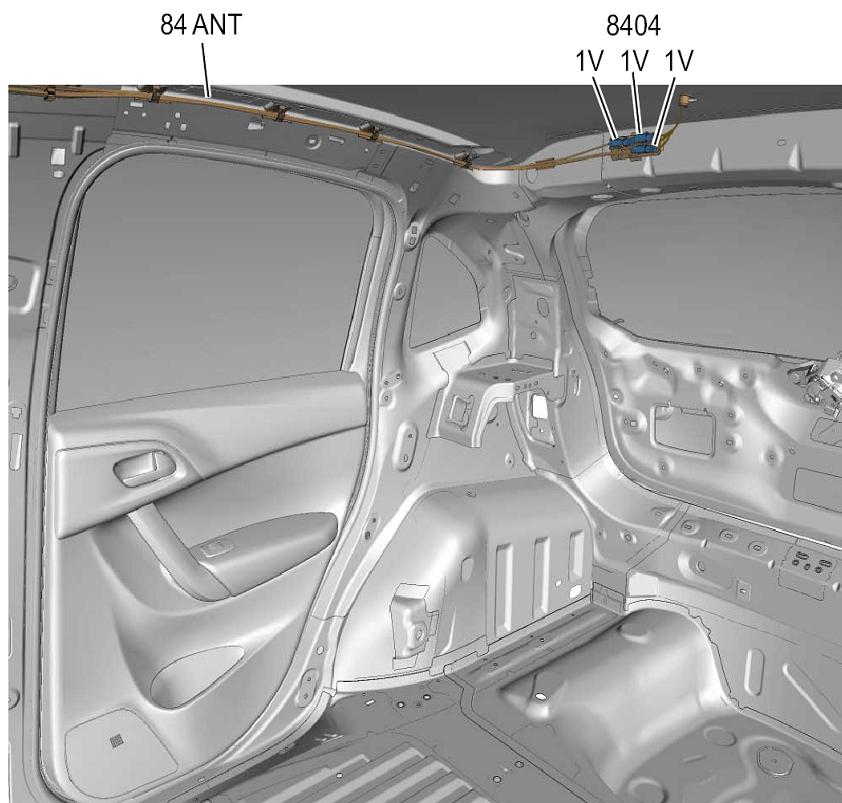

You have the RNEG (MyWay) telematics system installed.
The aerial runs from the aerial base across to the top back of the tailgate and from there, down the driver's side back to the the dashboard and to t he head unit:
Unfortunately 0940 is not a recognised PSA code, so is probably one generated by his diagnostic tool, so I can't help you with that one.

The issue is likely to be somewhere in the previous diagram I put up - as there may be a connection issue or water ingress there. There are no earths at the back of the unit for the aerials as these are simple aerial plugs. But it won't hurt to check that the aerial is not loose of course.
"a" Aerial FM2 (not used).
"b" GPS aerial .
"c" 3-part connector.
"d" LVDS cable connector.
"e" Aerial FM1/AM.

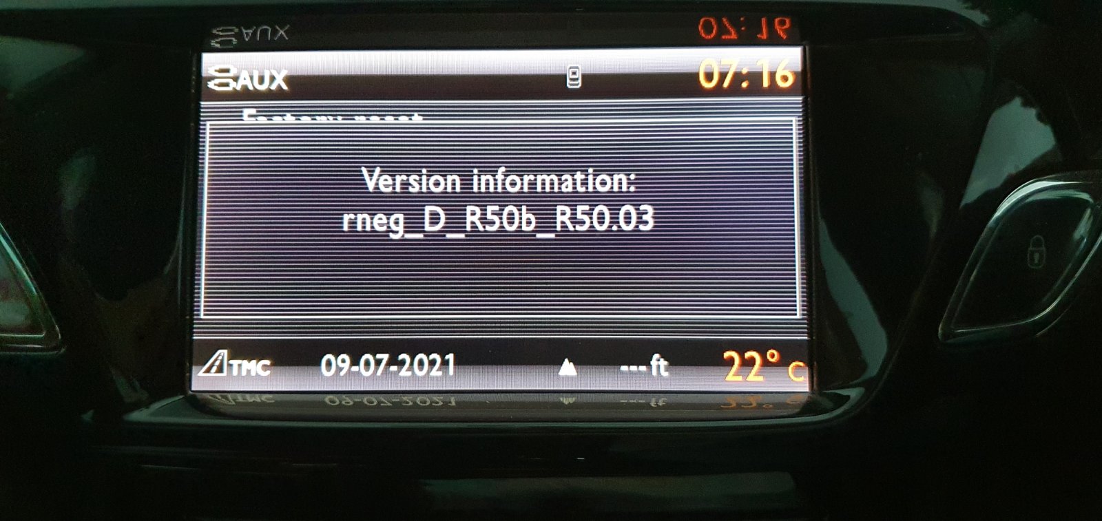

Remember you will not get an instant fix on satellites once the system antenna has been removed. It takes at least 10 minutes of actual driving (not standing still with engine running) for the system to get a fix on available satellites.
1) Firmware: You have the latest and last available version that was ever released for this system.
2) Your maps can be further updated to the 2016-2 version, which is the last official release for this system.
3) Always leave the Synch Date & Time with GPS option Unchecked! This is the only way to ensure correct navigation calculation and that the time remains as it should in order to deal with the GPS N Week Rollover issue.

thankyou so much, yeah I read this advice on another thread you mentioned, il do exactly what you have layed out in the above steps.
should first try and do BSI reset?
whilst driving do I need to check the satellite by holding down setup or after the 10 min drive?

2) To get satellite info, you need a long press on the MENU button, then select AUDIO/TELEPHONE DIAGNOSTICS, then GPS COVERAGE). You can do this when the car is at a standstill - as after driving it will either of locked onto satellites or not - so don't attempt this while driving - it is too much of a distraction.
3) The MyWay system along with the Navidrive 3D are made by Harman Becker and PSA stopped using these systems. When that happened they left customers in the lurch as they no longer commissioned HERE maps to make these system-specific map updates any longer. Customers were therefore stuck on the last official updates 2016-2. Having said that, others found that these units or similar units were still being supported on some Audi and BMW models and they were still getting map updates commissioned. So some people found a way to modify the update to work with the MyWay and Navidrive 3D systems - although the POI database was not compatible and there were other glitches - but it was a solution none the less after being abandoned by PSA.
