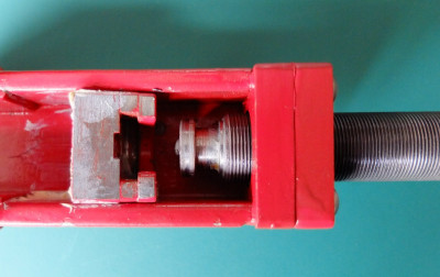

This is the main part of the tool, just about complete. (The punch and dies in the picture are DIN style, not Citroen)

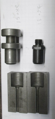

What I didn't realise until late in the process is that the new punch is narrower than the original one and a very loose fit in the dies, hence the lop-sided flare.
(Original Pleiades punch on the left, new style on the right)

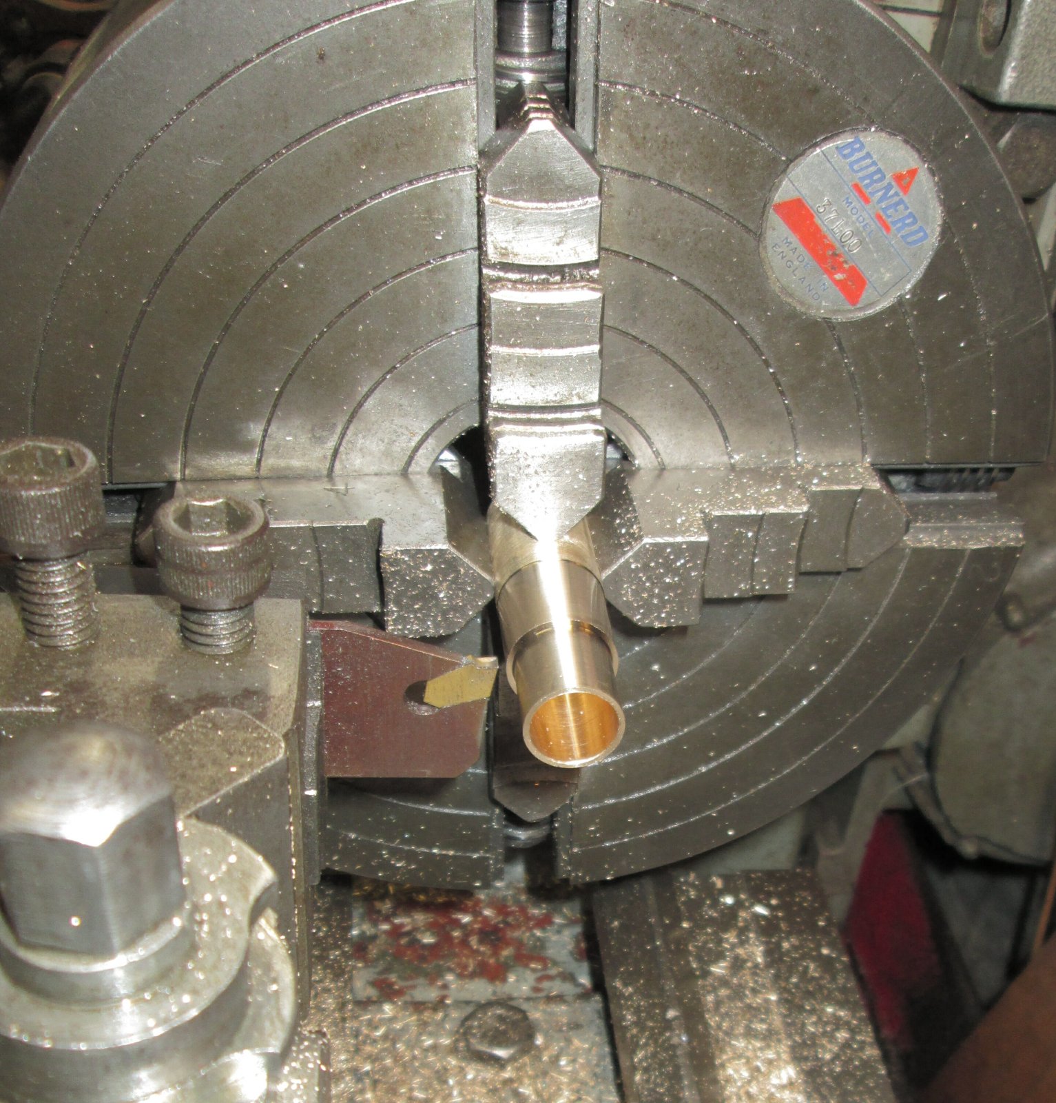

So, I made a sleeve to bring the diameter back to the same as the original punch

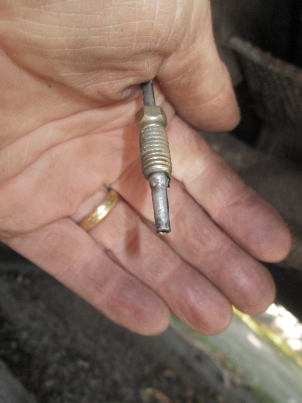

The result
At the risk of sounding smug, I was pretty chuffed with the result :-)
