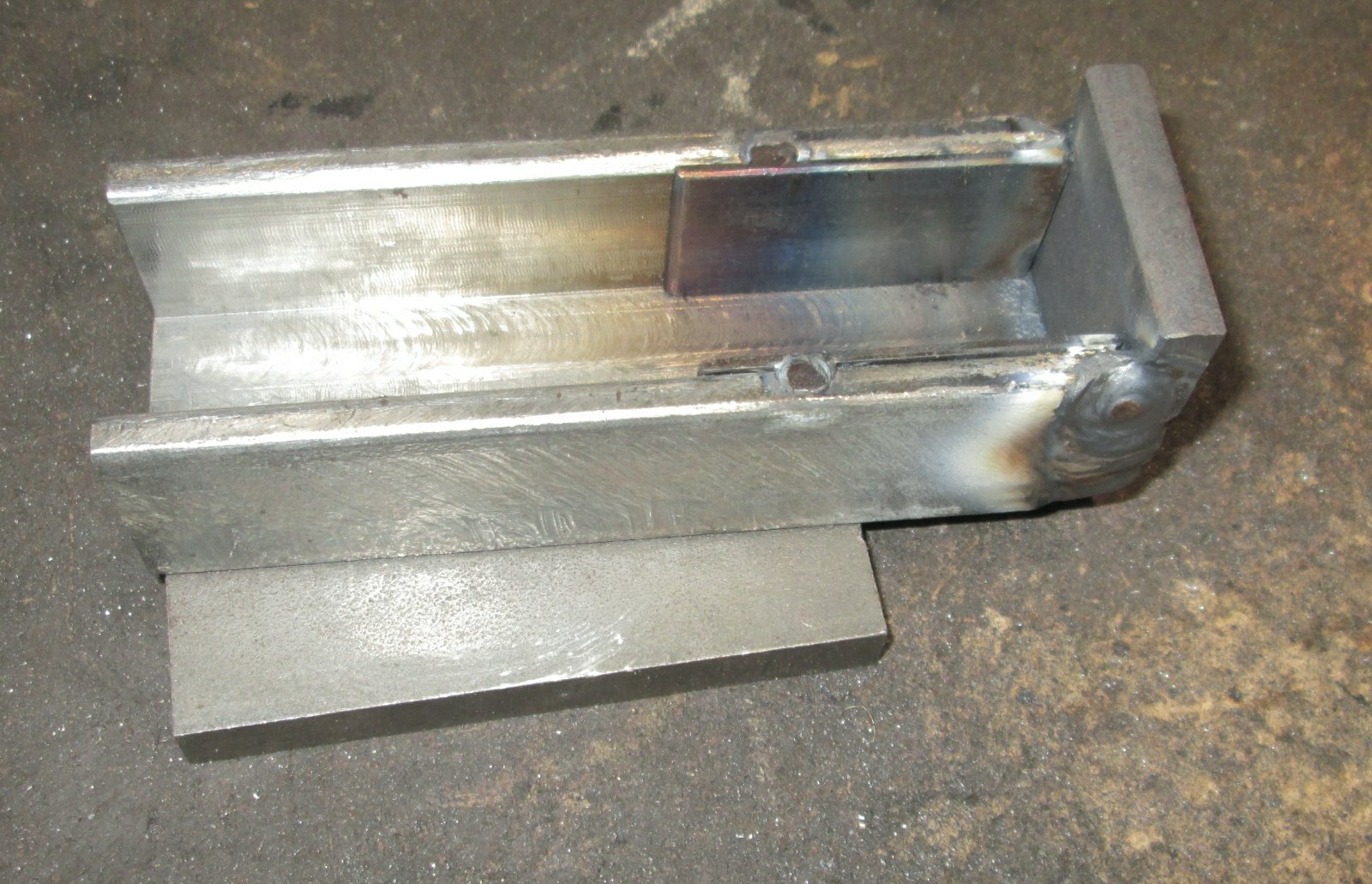

I found a nice chunky piece of U channel in my reclaimed metal stock, so that became the body, and I made the other parts to fit around that.
The new tool had to be screw-operated, and flaring steel pipe needs quite a bit of force, so I threaded a piece of bar M20 x 1.0 pitch
This is the kit of parts about 2/3 of the way through the build
This is the main part of the tool, just about complete. (The punch and dies in the picture are DIN style, not Citroen)

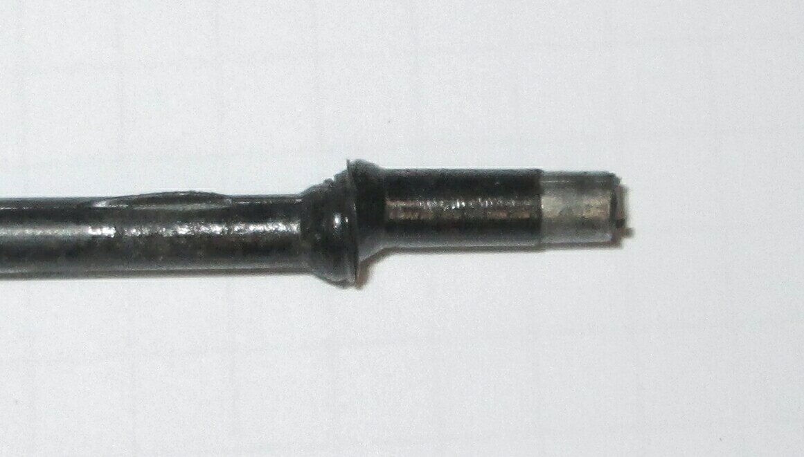

The first attempt at flaring a piece of steel pipe was a bit disappointing
I'd diverged from my original plan a little, deciding to use the later style of screw-in punches, as this would make it easier to incorporate an extraction mechanism.
What I didn't realise until late in the process is that the new punch is narrower than the original one and a very loose fit in the dies, hence the lop-sided flare.
