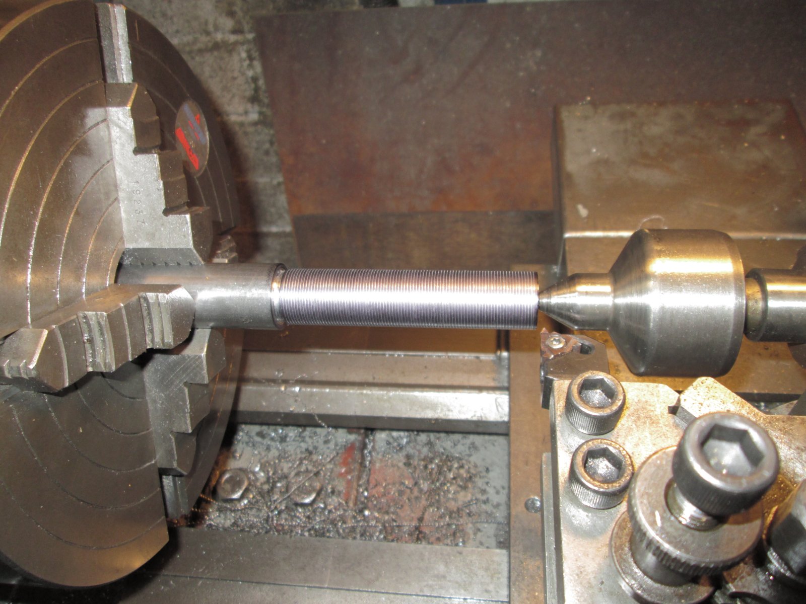

The new tool had to be screw-operated, and flaring steel pipe needs quite a bit of force, so I threaded a piece of bar M20 x 1.0 pitch

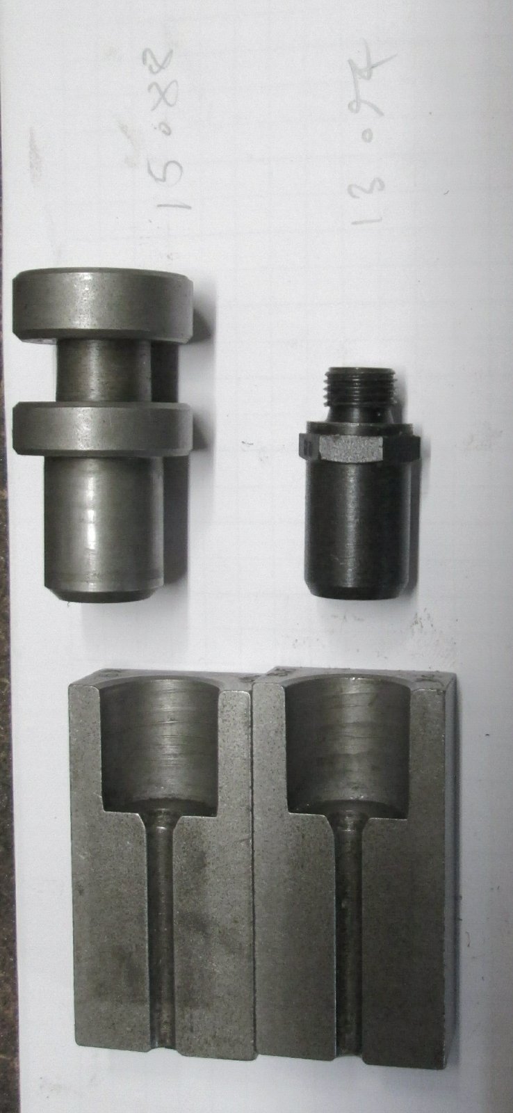

This is the main part of the tool, just about complete. (The punch and dies in the picture are DIN style, not Citroen)

I'd diverged from my original plan a little, deciding to use the later style of screw-in punches, as this would make it easier to incorporate an extraction mechanism.
What I didn't realise until late in the process is that the new punch is narrower than the original one and a very loose fit in the dies, hence the lop-sided flare.
(Original Pleiades punch on the left, new style on the right)
So, I made a sleeve to bring the diameter back to the same as the original punch
